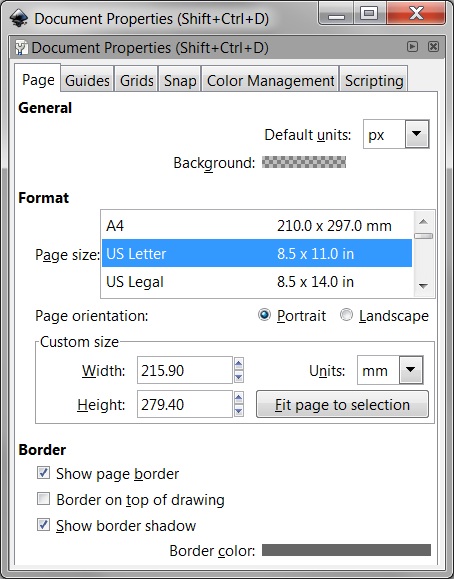

I believe the details for Inkscape units are located in the file c:\Program Files\Inkscape\share\ui\units.txt
# Simple unit configuration file
# This is a space-delimited list of unit definitions.
# name name_plural abbr type factor PRI description
% % % DIMENSIONLESS 1.00 Y Percentage
pixel pixels px LINEAR 1.00 Y CSS Pixels (90/inch)
point points pt LINEAR 1.25 N PostScript points (72/inch)
pica picas pc LINEAR 15.0 N 12 points
inch inches in LINEAR 90.0 N Inches (90 px/in)
millimeter millimeters mm LINEAR 3.543307 N Millimeters (25.4 mm/in)
centimeter centimeters cm LINEAR 35.43307 N Centimeters (10 mm/cm)
meter meters m LINEAR 3543.307 N Meters (100 cm/m)
foot feet ft LINEAR 1080 N Feet (12 in/ft)
degree degrees deg RADIAL 1.00 Y Degrees
radian radians rad RADIAL 57.296 N Radians (57.296 deg/rad)
font-height font-heights em FONT_HEIGHT 1.00 Y Font height
x-height x-heights ex FONT_HEIGHT 0.50 N Height of letter 'x'
half-em half-ems en FONT_HEIGHT 0.50 N Half of font height
From what I can tell the native units are Pixels which is the unit stored in the XML file regardless of which unit you display on the screen. You can change which units you are using with File-> Document Properties. If you use inches then the scaling is 1/90 or 0.11111. If you use mm then the scaling is 1/3.543307 or 0.282222. This may result is some rounding error and might not be appropriate for all cases but it worked well for me. I'm also no sure how your tool accounts for the tool width so this could be another source of error but it could be easily eliminated if your code works with the users unit preferences and implemented the scaling.
The screen shots below with the width and height info from Inkscape would support my information above.
Settings in px (49853 просмотра) <a class='original' href='./download/file.php?id=309&sid=ef9237744e30d85a40c2d3dee0f5ca11&mode=view' target=_blank>Загрузить оригинал (84.08 КБ)</a>
Settings in px
Setting in inches (49853 просмотра) <a class='original' href='./download/file.php?id=307&sid=ef9237744e30d85a40c2d3dee0f5ca11&mode=view' target=_blank>Загрузить оригинал (83.49 КБ)</a>
Setting in inches
Settings in mm (49853 просмотра) <a class='original' href='./download/file.php?id=308&sid=ef9237744e30d85a40c2d3dee0f5ca11&mode=view' target=_blank>Загрузить оригинал (85.25 КБ)</a>
Settings in mm
GCode Plugin Scaling for inches (49853 просмотра) <a class='original' href='./download/file.php?id=310&sid=ef9237744e30d85a40c2d3dee0f5ca11&mode=view' target=_blank>Загрузить оригинал (70.99 КБ)</a>

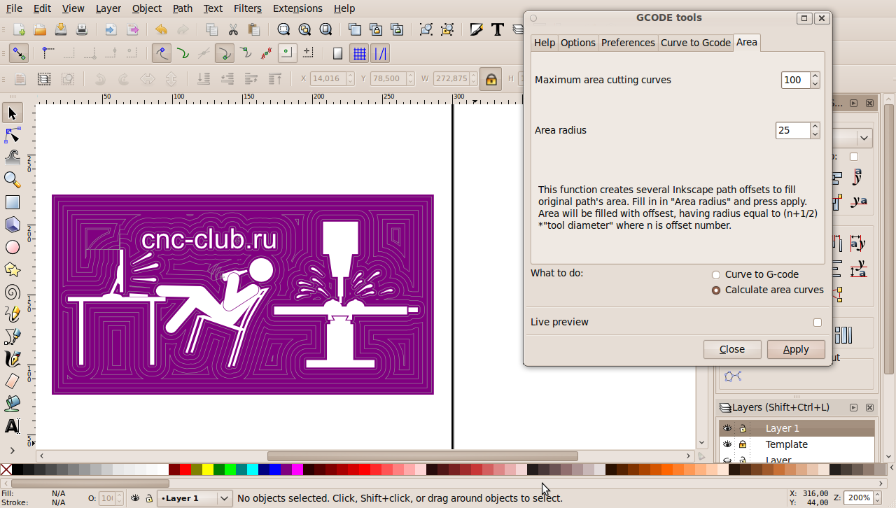

Next we need to calculate paths that will cover the area (these paths will be the cutter's trajectory).
Go to Extensions -> Gcode tools ...
Fill in Tool diameter in the Preferences tab
Then go to Area tab, and fill in Area radius. What is Area radius or how can it been calculated?
First of all Area radius must be in px (pixels) no mater which units you have been selected!
There some ways to calculate Area radius:
  • The easies way is: find the thickest part of the path and measure it by eye (Joke)
  • The second easies way is: find the thickest part of the path and measure it with Bizier tool. When you draw a path with the Bizier tool status bar shows it last segment length.
  • The hardest way is: convert path to dynamic offset (Ctlr+J), then press F2 and move the control point to make your path disappear. Then press Ctrl+Shif+X to open XML editor and find there inkscape:radius parameter, it's value is the exact value that you'll need
So anyway fill in Area radius.
Choose Calculate Area curves at the bottom and press Apply.

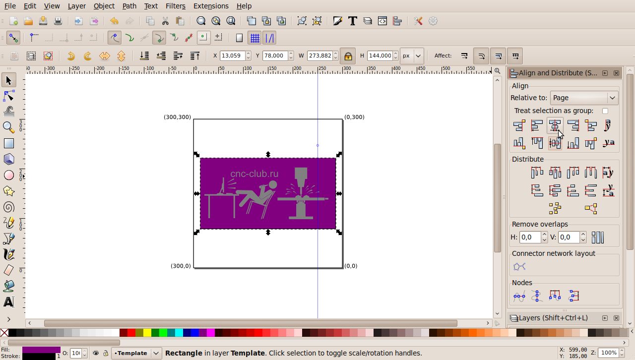

7. After applying Calculate area curves you should have a new group containing paths that cover the area of the source path. But unfortunately this paths cat contain some errors.
To correct the errors go into the group (double click on the group), select all objects (Ctrl+A) convert them to Paths (shift+Ctrl+C). Brake paths apart (Ctrl+Shift+K) to delete some unnecessary paths and correct others.
8. All is ready to convert paths to Gcode. Select the paths that we've got, do Extensions -> Gcode tools... Go to Preferences tab fill in cutter parameters, directory and filename for in which you want Gcode to be exported. Then go to Path to Gcode tab, fill in tolerance and maximum subdivision parameters. (Notice number of subdivisions means means number of iterative subdivisions not number of segvenst that you'll get from one segment. So you cat get up to 2^n segment from one segment.)
Choose Path to Gcode at the bottom. Press apply.
gcode tools area processing 0006.png (49824 просмотра) <a class='original' href='./download/file.php?id=356&sid=ef9237744e30d85a40c2d3dee0f5ca11&mode=view' target=_blank>Загрузить оригинал (255.34 КБ)</a>
What you'll get: a group will be added to the drawing which shows cutter's working trajectory, and of cause a file in specified directory which will contain Gcode.
Let's check the results:
gcode tools area processing 0007.png (49824 просмотра) <a class='original' href='./download/file.php?id=357&sid=ef9237744e30d85a40c2d3dee0f5ca11&mode=view' target=_blank>Загрузить оригинал (44.56 КБ)</a>
Everything is nice except that I missed the working area of my cutter :) but do not worry if you have not chosen "Generate not parametric code" it is very easy to correct the situation. Just correct first lines in the Gcode file:

Re: Inkscape Gcode tools plug-in English support forum
We've made a new beta version.
Upon many request we've made Orientation function
It helps to move/rotate/scale your drawing, with out doing any calculations.
How it works:
  1. Open Orientation tab.
    • You will see inputs with desired coordinate of orientation control points.
      You can fill this inputs with values of desired coordinates of three points on your object. Or just live them with default values (They define origin point (0,0) and two axis (100,0) and (0,100)). Note you will be able to change this values at any time later.
      If you use inches it will be better to you to change 100 to something like 1 or 5 because the point will appear at coordinates (100,0) which can be really far away from the page bounds.
    • And one input containing Initial scale value.
      This value is helpful if you want to use natural units (inches or mm or others). For inches this value must be 90 for mm 3.543307087, which is 90/25.4.
    Снимок-GCODE tools DEVELOPE.png (49761 просмотр) <a class='original' href='./download/file.php?id=399&sid=ef9237744e30d85a40c2d3dee0f5ca11&mode=view' target=_blank>Загрузить оригинал (70.99 КБ)</a>
  2. After you press apply a new group containing three orientation points will be added to the active layer.
    Arrows point to control point position. You can put the points wherever you want. Just be sure that they do not lay on one straight line. Also you cat modify their desired values by modifying the text near each arrow with the text tool. (Be sure to remain text's format " ( value ; value )" spaces are not taken into account.)
    You can move, rotate, scale, skew, etc. this points.
    Attention do not ungroup arrow from the text! You can ungroup points from each other but not further!
    Снимок-New document 1 - Inkscape.png (49761 просмотр) <a class='original' href='./download/file.php?id=400&sid=ef9237744e30d85a40c2d3dee0f5ca11&mode=view' target=_blank>Загрузить оригинал (170.15 КБ)</a>
  3. Now you can apply any other functions. All exported will be in new coordinate system defined by these points. You will not see any changes in the preview, but the will be in generated Gcode. (If you apply different scale to X and Y axis preview of arcs will be ruined (their ending points wont be on correct places) but we thin this case is really rare and this will be a todo for a while.)
  4. You can add more than one set of orientation control points, but if you want them to make any effect you need to put them to different layers. Gcode tools firs searches in the active layer for orientation points and then searches in whole painting.
Some changes been made to the interface.
Now there's no radio button to select the function. Function is chosen according to the open tag at the time when apply button is pressed. So if you want to convert path to Gcode you need Path to Gcode tab be opened when apply button is pressed.
So here it is:
