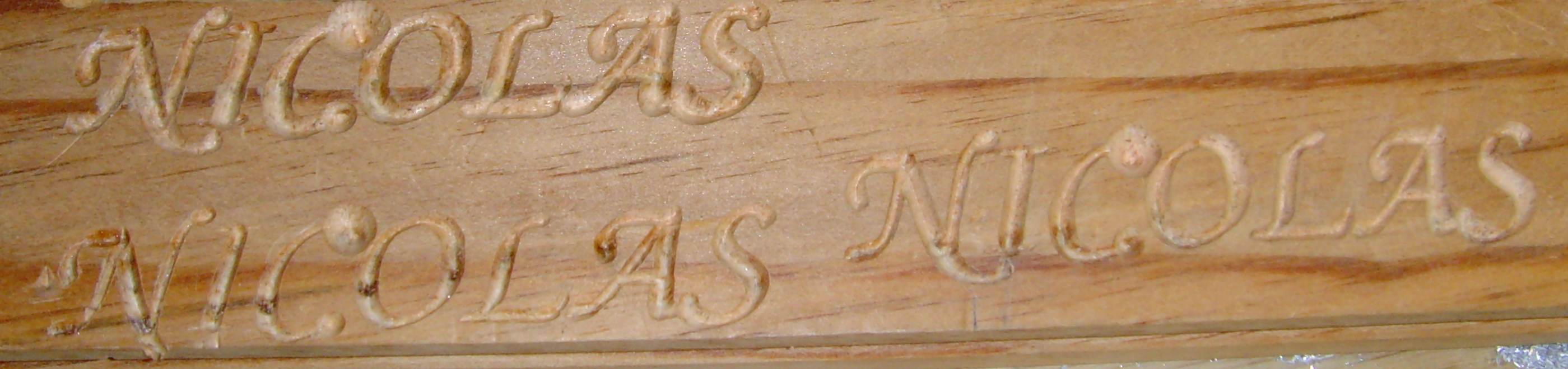

Gcodetools engraving by Rene (1455765 просмотров) <a class='original' href='./download/file.php?id=631&sid=025dd0e44a1625367fd52f7052d47bc3&mode=view' target=_blank>Загрузить оригинал (233.84 КБ)</a>

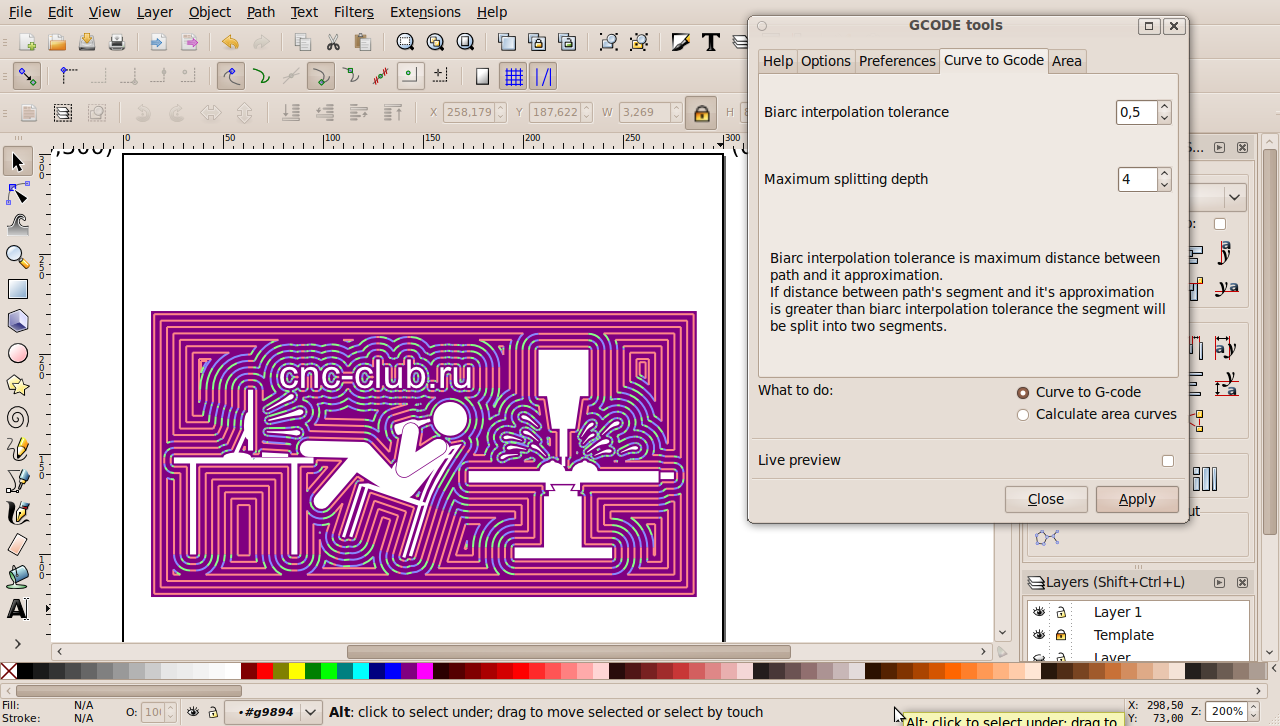

6. Now we have a path of which area we want to cut.
Next we need to calculate paths that will cover the area (these paths will be the cutter's trajectory).
Go to Extensions -> Gcode tools ...
Fill in Tool diameter in the Preferences tab
Then go to Area tab, and fill in Area radius. What is Area radius or how can it been calculated?
First of all Area radius must be in px (pixels) no mater which units you have been selected!
There some ways to calculate Area radius:
  • The easies way is: find the thickest part of the path and measure it by eye (Joke)
  • The second easies way is: find the thickest part of the path and measure it with Bizier tool. When you draw a path with the Bizier tool status bar shows it last segment length.
  • The hardest way is: convert path to dynamic offset (Ctlr+J), then press F2 and move the control point to make your path disappear. Then press Ctrl+Shif+X to open XML editor and find there inkscape:radius parameter, it's value is the exact value that you'll need
So anyway fill in Area radius.
Choose Calculate Area curves at the bottom and press Apply.
gcode tools area processing 0004.png (50821 просмотр) <a class='original' href='./download/file.php?id=354&sid=025dd0e44a1625367fd52f7052d47bc3&mode=view' target=_blank>Загрузить оригинал (218.16 КБ)</a>
Sometimes it's better to convert path to dynamic offset before doing Calculate Area curves.
gcode tools area processing 0005.png (50821 просмотр) <a class='original' href='./download/file.php?id=355&sid=025dd0e44a1625367fd52f7052d47bc3&mode=view' target=_blank>Загрузить оригинал (232.87 КБ)</a>
7. After applying Calculate area curves you should have a new group containing paths that cover the area of the source path. But unfortunately this paths cat contain some errors.
To correct the errors go into the group (double click on the group), select all objects (Ctrl+A) convert them to Paths (shift+Ctrl+C). Brake paths apart (Ctrl+Shift+K) to delete some unnecessary paths and correct others.
8. All is ready to convert paths to Gcode. Select the paths that we've got, do Extensions -> Gcode tools... Go to Preferences tab fill in cutter parameters, directory and filename for in which you want Gcode to be exported. Then go to Path to Gcode tab, fill in tolerance and maximum subdivision parameters. (Notice number of subdivisions means means number of iterative subdivisions not number of segvenst that you'll get from one segment. So you cat get up to 2^n segment from one segment.)
Choose Path to Gcode at the bottom. Press apply.
gcode tools area processing 0006.png (50821 просмотр) <a class='original' href='./download/file.php?id=356&sid=025dd0e44a1625367fd52f7052d47bc3&mode=view' target=_blank>Загрузить оригинал (255.34 КБ)</a>
What you'll get: a group will be added to the drawing which shows cutter's working trajectory, and of cause a file in specified directory which will contain Gcode.

Here are the results of cutting this Gcode on my hobby router:
Unfortunately it was the first run of my router and almost at the end of cutting one coupling broke down, so this cutting is unfinished :(.
Material is foam (it was the first run :) ).
Cutting time with maximum cutting speed 7mm per second is about 18 minutes. Dimensions are about 270x140mm, tool diameter 3.2mm.
gcode tools area processing 0011.jpg (50821 просмотр) <a class='original' href='./download/file.php?id=360&sid=025dd0e44a1625367fd52f7052d47bc3&mode=view' target=_blank>Загрузить оригинал (256.47 КБ)</a>
gcode tools area processing 0012.jpg (50821 просмотр) <a class='original' href='./download/file.php?id=361&sid=025dd0e44a1625367fd52f7052d47bc3&mode=view' target=_blank>Загрузить оригинал (244.31 КБ)</a>

I've found Engraving is a Very nice feature .
I've test it. very promising. Some prob I list it.
I draw on Inkscape some text.
I draw rectangle. And do logical operation diference..
After start gcodetools last one version post in this thread.
do engraving.
and have this:
Capture-2.jpg (50752 просмотра) <a class='original' href='./download/file.php?id=405&sid=025dd0e44a1625367fd52f7052d47bc3&mode=view' target=_blank>Загрузить оригинал (16.84 КБ)</a>
inkscape file:
test_engraving.svg
(772.29 КБ) 2333 скачивания
On emc I have this:
screen_capture10.jpg (50752 просмотра) <a class='original' href='./download/file.php?id=407&sid=025dd0e44a1625367fd52f7052d47bc3&mode=view' target=_blank>Загрузить оригинал (29.61 КБ)</a>
and Z view that show the errors , some point are very very on the bottom of Z axis.
I have try with many others tune of gcode tools but always this bad points.
And with the last version beta of gcode tools the gcode have mirroring verticaly the engraving.
screen_capture9.jpg (50752 просмотра) <a class='original' href='./download/file.php?id=408&sid=025dd0e44a1625367fd52f7052d47bc3&mode=view' target=_blank>Загрузить оригинал (14.79 КБ)</a>
Here the gcode file generate:
test_engraving.ngc
(88.48 КБ) 2637 скачиваний
I've correct some points that show me to be very very bad in the gcode and engrave it in my router with two different cone cuter shape.
And the result is very nice.
I like it.
Else if some z coordinate are bad and make some big circular cone hole. But it's a very very good start for this engraving funtion.
result:
SNV30126.JPG (50752 просмотра) <a class='original' href='./download/file.php?id=410&sid=025dd0e44a1625367fd52f7052d47bc3&mode=view' target=_blank>Загрузить оригинал (146.27 КБ)</a>
same but big zoom and different angle:
SNV30127.JPG (50752 просмотра) <a class='original' href='./download/file.php?id=411&sid=025dd0e44a1625367fd52f7052d47bc3&mode=view' target=_blank>Загрузить оригинал (125.25 КБ)</a>
last one better engraving but problem wiht photo luminosity sorry.
SNV30128.JPG (50752 просмотра) <a class='original' href='./download/file.php?id=412&sid=025dd0e44a1625367fd52f7052d47bc3&mode=view' target=_blank>Загрузить оригинал (69.87 КБ)</a>
I wait with enthusiasm the new version whith debug of this. Congratulation for the good work.
