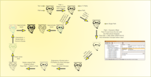

This picture shows main features of this plug-in:
Gcode tools plug-in tutorial (2600*1300 px png ~ 700Kb) (849226 просмотров) <a class='original' href='./download/file.php?id=125&sid=f0a6f343c8a54961a2c45283a1adb8ff&mode=view' target=_blank>Загрузить оригинал (752.7 КБ)</a>
Gcode from the example:
gnu.ngc
(27.14 КБ) 24354 скачивания

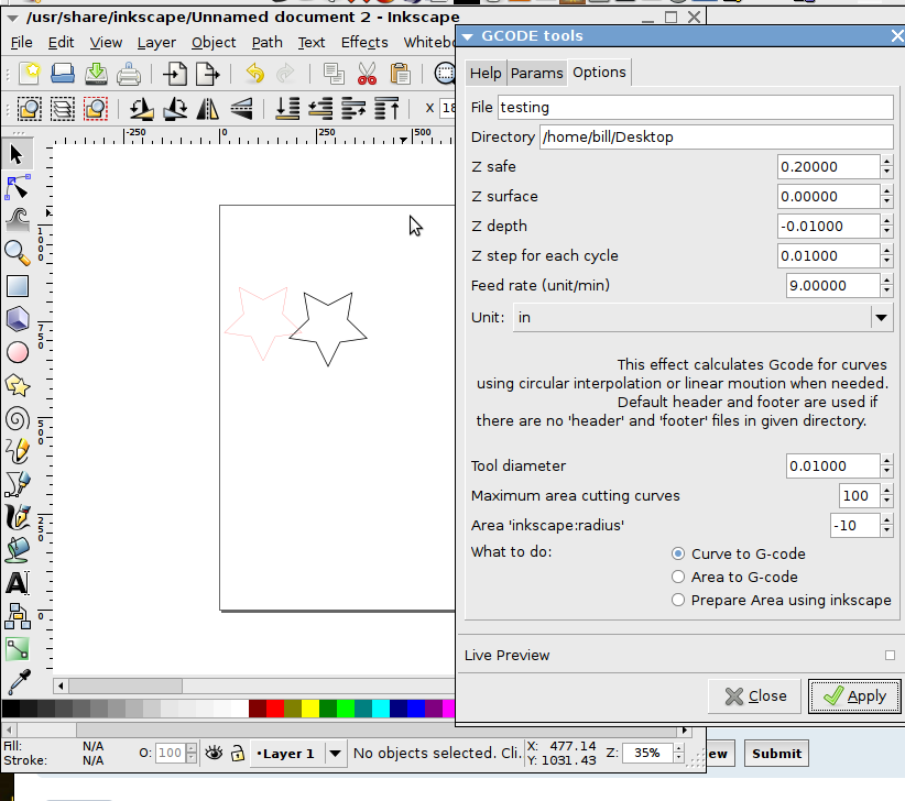

Well, I don't seem to be getting anything to work. When I set things up as follows and click "Apply" sometimes I get the "working" message for a few seconds, and sometimes I get no action at all. It rarely creates a file, and when it does, I get something like:
(Generated by gcode_tools from inkscape.)
M3
G20 (All units in inches)
#4 = 9.000000 (Feed)
#5 = 1.000000 (Scale x)
#6 = 1.000000 (Scale y)
#7 = 1.000000 (Scale z)
#8 = 0.000000 (Offset x)
#9 = 0.000000 (Offset y)
#10 = 0.000000 (Offset z)
#11 = 0.200000 (Safe distanse)
M5
G00 X0.0000 Y0.0000
M2
(end)
Screenshot.png (849093 просмотра) <a class='original' href='./download/file.php?id=136&sid=f0a6f343c8a54961a2c45283a1adb8ff&mode=view' target=_blank>Загрузить оригинал (153.1 КБ)</a>
Am I doing something wrong, or is there a problem with the extension? Any help would be appreciated. Thanks.
May be you are :). What object type has that star? Is it a "Star" or "Path"? I can see that you've selected 2 objects, one of them "path" and another not! (It's written at the bottom of the window.)
About next post...
From the python manual:
10.3. cmath — Mathematical functions for complex numbers
This module is always available. It provides access to mathematical functions for complex numbers. The functions in this module accept integers, floating-point numbers or complex numbers as arguments. They will also accept any Python object that has either a __complex__() or a __float__() method: these methods are used to convert the object to a complex or floating-point number, respectively, and the function is then applied to the result of the conversion.
It seems that your python standard library might been damaged. Try to reinstall python.
When do you get this errors? At start of Inkscape or when you try to execute extension? My extension does not use complex numbers, so it should work with out cmath...
About the directory... Yes it is my home dir. But this function was made for debugging purposes. So it's never used in yours version.
One more thing unfortunately "~/" does not work, you should choose /home/<your home dir> instead of it. That could cause your problems. I've made a fix that raises exception instead of doing nothing if file can not been created.
Ok, I think I've done that, corrected version is in the header.

I tried reinstalling all of the basic Python libraries, but I'm still seeing those error messages about cmath in the trace. They appear to start showing up right after simplestyle, simplestylemodule, and/or simplepath are called. Could one or more of those be looking for the math functions? I'm not sure why it said "2 objects" in the screencap; I thought I'd done all the steps correctly to convert the object, but maybe I missed one. At any rate, I also fixed the path setting to say "/home/bill/Desktop" and tried it again, making sure that it said "Path (10 nodes)" when I selected the star, and it produced what appears to be correct G-Code output. :D I _did_ notice that when I click "Apply" in your plugin, a light-red "ghost" image of the star appears in Inkscape a little to the left of the original (see attached screencap). Is this supposed to happen? Maybe it did this before and I selected both without noticing the new object? I don't know. I'm probably not going to have a lot of time to work on this today, but I wanted to let you know that despite my best efforts, it's starting to do what it's supposed to. :lol: Thanks for your help. I'll try it shortly on some more complex shapes and see what happens. (I'm trying to generate g-code to engrave the symbols for a custom-made Mah Jong tile set from a modified version of a Mah Jong TrueType font I downloaded.) Hope you're having a good day. :)
Screenshot-1.png (849085 просмотров) <a class='original' href='./download/file.php?id=139&sid=f0a6f343c8a54961a2c45283a1adb8ff&mode=view' target=_blank>Загрузить оригинал (109.92 КБ)</a>
Сообщения: 22776
Re: Inkscape Gcode tools plug-in English support forum
The 'ghost' image is a kind of preview of generated Gcode. If you try to convert curves with not straight you'll see plug-ins major function - biarc interpolation. In that preview straight elements (G01) are drawn in red - that's what you've got, and two arcs from biarc (G02 or G03) are drawn in green and blue. If something goes wrong or mistake of the interpolation is to big you can see it in preview.
The only strange thin is that it appears a little to the left, instead of same place of the source path. But still I'm happy "it's starting to do what it's supposed to." :lol:

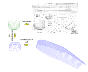

First screen shot of new feature Loft:
How it's done in two words:
Plug-in takes a number of paths, distances between them along (y axis) and some additional parameters. Then it generates interpolation from one curve to another in given order.
There are some hidden features:
For example the step between two interpolated paths is calculated depending on interpolation function and position of control points, so this step distance is not static. It prevents big stairs on ending model.
What is needed to be done to release this function:
Add interpolation functions.
Do the bug fix. :)
loft.png (848801 просмотр) <a class='original' href='./download/file.php?id=153&sid=f0a6f343c8a54961a2c45283a1adb8ff&mode=view' target=_blank>Загрузить оригинал (324.76 КБ)</a>
This version probably has a lot of bugs, I wont recommend you using it right now.
