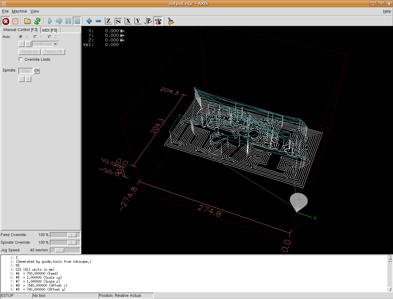

Preview of the generated Gcode in EMC (1462486 просмотров) <a class='original' href='./download/file.php?id=130&mode=view' target=_blank>Загрузить оригинал (154.76 КБ)</a>

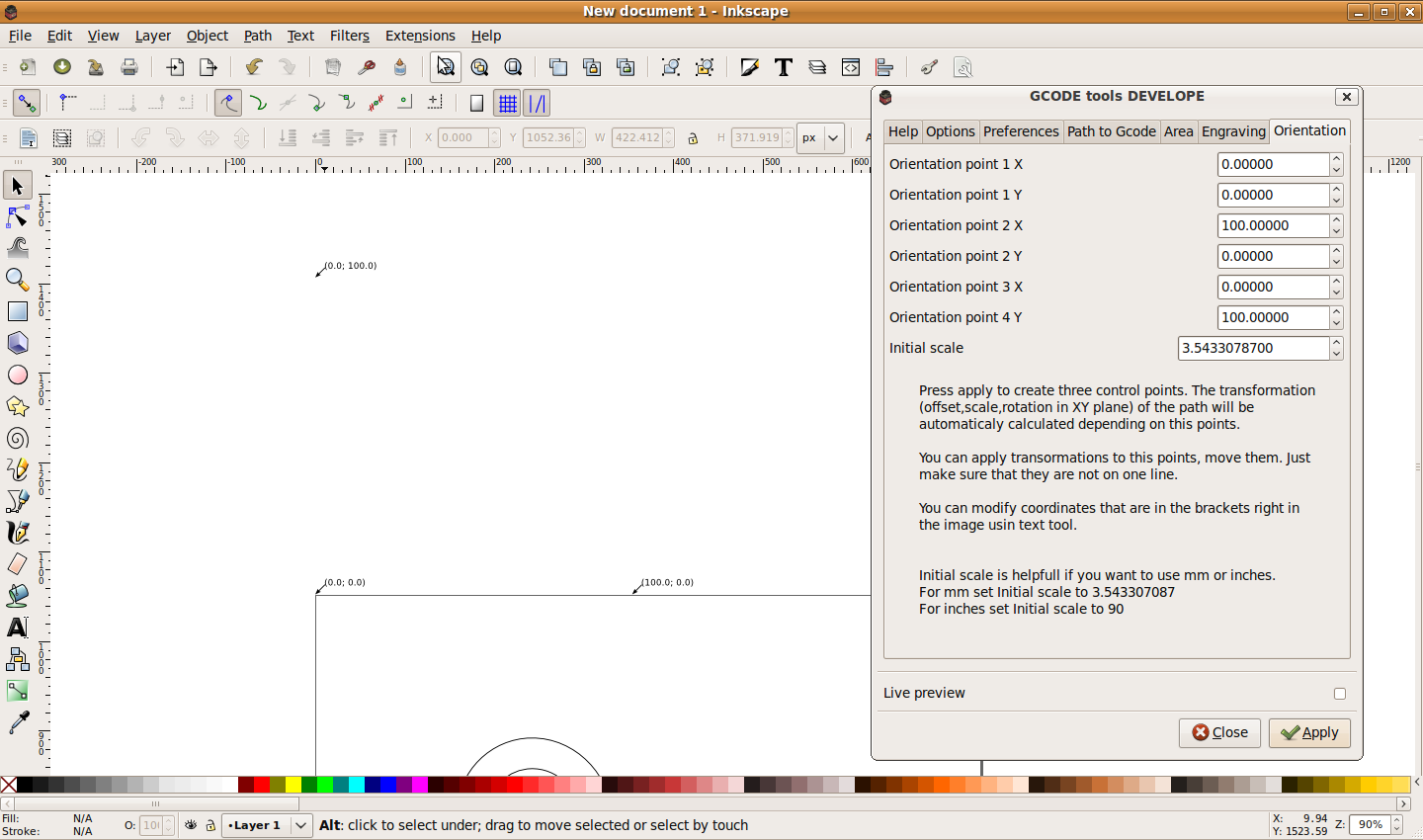

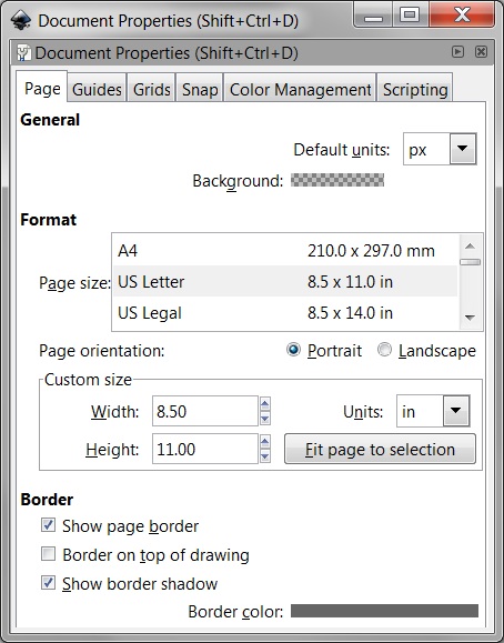

I believe the details for Inkscape units are located in the file c:\Program Files\Inkscape\share\ui\units.txt
# Simple unit configuration file
# This is a space-delimited list of unit definitions.
# name name_plural abbr type factor PRI description
% % % DIMENSIONLESS 1.00 Y Percentage
pixel pixels px LINEAR 1.00 Y CSS Pixels (90/inch)
point points pt LINEAR 1.25 N PostScript points (72/inch)
pica picas pc LINEAR 15.0 N 12 points
inch inches in LINEAR 90.0 N Inches (90 px/in)
millimeter millimeters mm LINEAR 3.543307 N Millimeters (25.4 mm/in)
centimeter centimeters cm LINEAR 35.43307 N Centimeters (10 mm/cm)
meter meters m LINEAR 3543.307 N Meters (100 cm/m)
foot feet ft LINEAR 1080 N Feet (12 in/ft)
degree degrees deg RADIAL 1.00 Y Degrees
radian radians rad RADIAL 57.296 N Radians (57.296 deg/rad)
font-height font-heights em FONT_HEIGHT 1.00 Y Font height
x-height x-heights ex FONT_HEIGHT 0.50 N Height of letter 'x'
half-em half-ems en FONT_HEIGHT 0.50 N Half of font height
From what I can tell the native units are Pixels which is the unit stored in the XML file regardless of which unit you display on the screen. You can change which units you are using with File-> Document Properties. If you use inches then the scaling is 1/90 or 0.11111. If you use mm then the scaling is 1/3.543307 or 0.282222. This may result is some rounding error and might not be appropriate for all cases but it worked well for me. I'm also no sure how your tool accounts for the tool width so this could be another source of error but it could be easily eliminated if your code works with the users unit preferences and implemented the scaling.
The screen shots below with the width and height info from Inkscape would support my information above.
Settings in px (50812 просмотров) <a class='original' href='./download/file.php?id=309&mode=view' target=_blank>Загрузить оригинал (84.08 КБ)</a>
Settings in px
Setting in inches (50812 просмотров) <a class='original' href='./download/file.php?id=307&mode=view' target=_blank>Загрузить оригинал (83.49 КБ)</a>
Setting in inches
Settings in mm (50812 просмотров) <a class='original' href='./download/file.php?id=308&mode=view' target=_blank>Загрузить оригинал (85.25 КБ)</a>
Settings in mm
GCode Plugin Scaling for inches (50812 просмотров) <a class='original' href='./download/file.php?id=310&mode=view' target=_blank>Загрузить оригинал (70.99 КБ)</a>

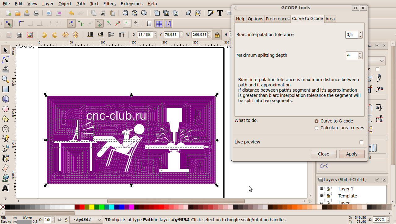

Re: Inkscape Gcode tools plug-in English support forum
Gcode tools ver. 1.2 Area processing tutorial
At this tutorial I'll explain how to make area cutting G-code of the path using Gcode tools and Inkscape.
1. First of all we will need a path. You can draw it by yourself, or download from the internet.
I've chosen cnc-club logo. If you want you can get it here:
logo_0002.svg
(19.08 КБ) 3776 скачиваний

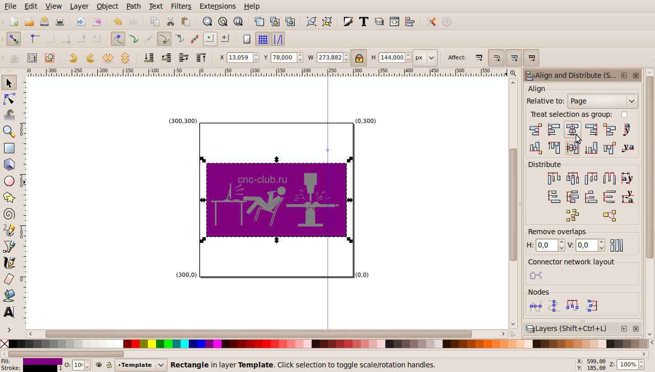

gcode tools area processing 0001.png (50783 просмотра) <a class='original' href='./download/file.php?id=351&mode=view' target=_blank>Загрузить оригинал (125.73 КБ)</a>
2. If your drawing consists not only from paths you should convert it to paths. (It may not contain some groups, ellipsis, texts, rectangles etc.). To do this select your drawing, check the status bar, if it says that selection contains Groups do Object - >Ungroup (Ctrl+Shift+G). If it contains text, or other geometry except paths do Path -> Object to path (Shift+Ctrl+C). Repeat this until status bar will say something like "5 objects of type Path in Layer...". Notice that when you convert Text to path it will create a Group with letters, so you will need to ungroup them.
3. Unite all paths into one path (Ctrl+"+").
4. I want cnc-club logo to offset from the surface so I'll need to cut the area outside the logo. Draw a rectangle, put it behind of your path (End or Page Down) and make it align to the center of the path (select path and Rectangle Ctrl+Shift+A and choose Center objects vertically and Center objects horizontally).
gcode tools area processing 0002.png (50783 просмотра) <a class='original' href='./download/file.php?id=352&mode=view' target=_blank>Загрузить оригинал (145.54 КБ)</a>
5. Subtract path from rectangle (Ctrl+"-").
gcode tools area processing 0003.png (50783 просмотра) <a class='original' href='./download/file.php?id=353&mode=view' target=_blank>Загрузить оригинал (145.65 КБ)</a>
6. Now we have a path of which area we want to cut.
Next we need to calculate paths that will cover the area (these paths will be the cutter's trajectory).
Go to Extensions -> Gcode tools ...
Fill in Tool diameter in the Preferences tab
Then go to Area tab, and fill in Area radius. What is Area radius or how can it been calculated?
First of all Area radius must be in px (pixels) no mater which units you have been selected!
There some ways to calculate Area radius:
  • The easies way is: find the thickest part of the path and measure it by eye (Joke)
  • The second easies way is: find the thickest part of the path and measure it with Bizier tool. When you draw a path with the Bizier tool status bar shows it last segment length.
  • The hardest way is: convert path to dynamic offset (Ctlr+J), then press F2 and move the control point to make your path disappear. Then press Ctrl+Shif+X to open XML editor and find there inkscape:radius parameter, it's value is the exact value that you'll need
So anyway fill in Area radius.
Choose Calculate Area curves at the bottom and press Apply.
gcode tools area processing 0004.png (50783 просмотра) <a class='original' href='./download/file.php?id=354&mode=view' target=_blank>Загрузить оригинал (218.16 КБ)</a>
Sometimes it's better to convert path to dynamic offset before doing Calculate Area curves.
gcode tools area processing 0005.png (50783 просмотра) <a class='original' href='./download/file.php?id=355&mode=view' target=_blank>Загрузить оригинал (232.87 КБ)</a>
7. After applying Calculate area curves you should have a new group containing paths that cover the area of the source path. But unfortunately this paths cat contain some errors.
To correct the errors go into the group (double click on the group), select all objects (Ctrl+A) convert them to Paths (shift+Ctrl+C). Brake paths apart (Ctrl+Shift+K) to delete some unnecessary paths and correct others.
8. All is ready to convert paths to Gcode. Select the paths that we've got, do Extensions -> Gcode tools... Go to Preferences tab fill in cutter parameters, directory and filename for in which you want Gcode to be exported. Then go to Path to Gcode tab, fill in tolerance and maximum subdivision parameters. (Notice number of subdivisions means means number of iterative subdivisions not number of segvenst that you'll get from one segment. So you cat get up to 2^n segment from one segment.)
Choose Path to Gcode at the bottom. Press apply.
gcode tools area processing 0006.png (50783 просмотра) <a class='original' href='./download/file.php?id=356&mode=view' target=_blank>Загрузить оригинал (255.34 КБ)</a>
What you'll get: a group will be added to the drawing which shows cutter's working trajectory, and of cause a file in specified directory which will contain Gcode.

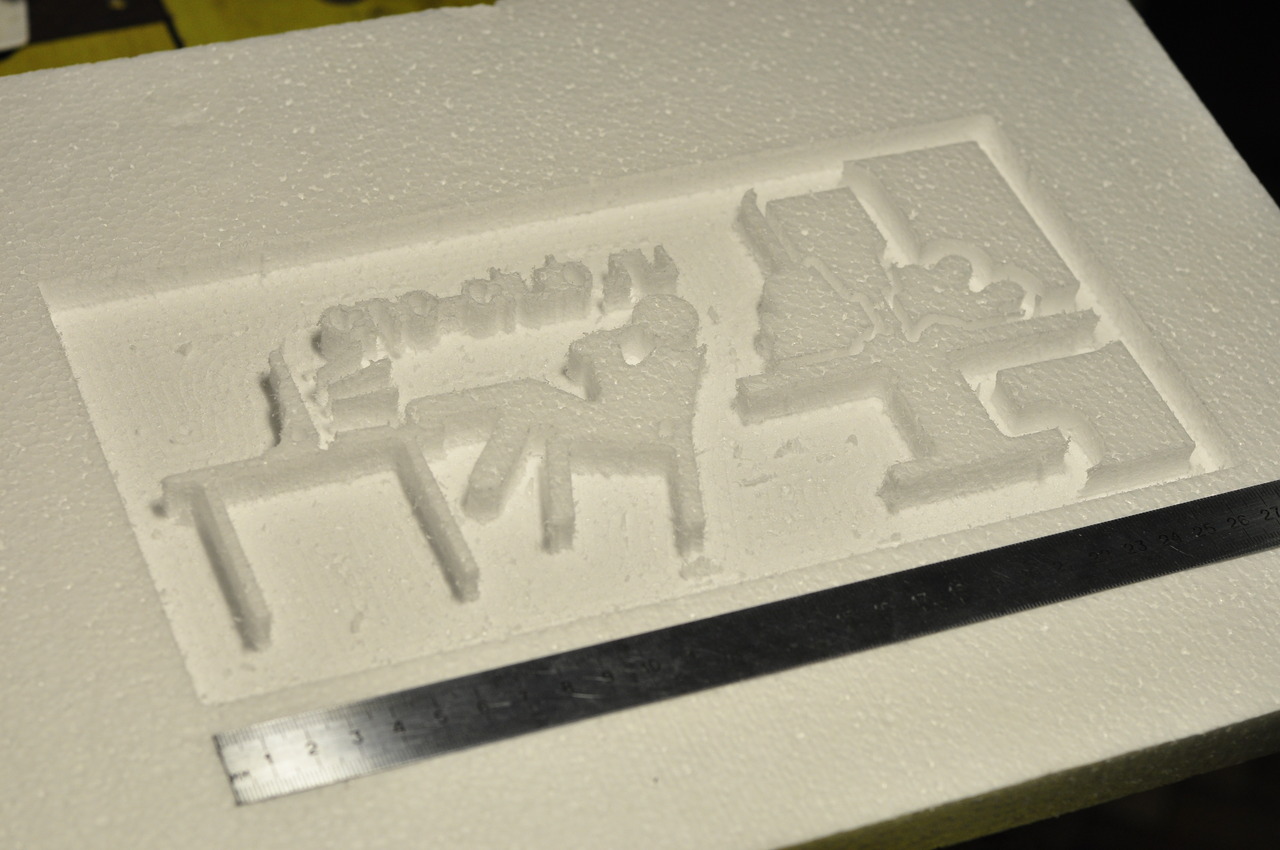

Let's check the results:
gcode tools area processing 0007.png (50783 просмотра) <a class='original' href='./download/file.php?id=357&mode=view' target=_blank>Загрузить оригинал (44.56 КБ)</a>
Everything is nice except that I missed the working area of my cutter :) but do not worry if you have not chosen "Generate not parametric code" it is very easy to correct the situation. Just correct first lines in the Gcode file:
#4  = 4.000000 (Feed)
#5  = 0.900000 (Scale xy)
#7  = 1.000000 (Scale z)
#8  = 0.000000 (Offset x)
#9  = 0.000000 (Offset y)
#10 = 0.000000 (Offset z)
#11 = 5.000000 (Safe distanse)
And situation solved :).

Here are the results of cutting this Gcode on my hobby router:
Unfortunately it was the first run of my router and almost at the end of cutting one coupling broke down, so this cutting is unfinished :(.
Material is foam (it was the first run :) ).
Cutting time with maximum cutting speed 7mm per second is about 18 minutes. Dimensions are about 270x140mm, tool diameter 3.2mm.
gcode tools area processing 0011.jpg (50783 просмотра) <a class='original' href='./download/file.php?id=360&mode=view' target=_blank>Загрузить оригинал (256.47 КБ)</a>
gcode tools area processing 0012.jpg (50783 просмотра) <a class='original' href='./download/file.php?id=361&mode=view' target=_blank>Загрузить оригинал (244.31 КБ)</a>

We've made a new beta version.
Upon many request we've made Orientation function
It helps to move/rotate/scale your drawing, with out doing any calculations.
How it works:
  1. Open Orientation tab.
    • You will see inputs with desired coordinate of orientation control points.
      You can fill this inputs with values of desired coordinates of three points on your object. Or just live them with default values (They define origin point (0,0) and two axis (100,0) and (0,100)). Note you will be able to change this values at any time later.
      If you use inches it will be better to you to change 100 to something like 1 or 5 because the point will appear at coordinates (100,0) which can be really far away from the page bounds.
    • And one input containing Initial scale value.
      This value is helpful if you want to use natural units (inches or mm or others). For inches this value must be 90 for mm 3.543307087, which is 90/25.4.
    Снимок-GCODE tools DEVELOPE.png (50720 просмотров) <a class='original' href='./download/file.php?id=399&mode=view' target=_blank>Загрузить оригинал (70.99 КБ)</a>
  2. After you press apply a new group containing three orientation points will be added to the active layer.
    Arrows point to control point position. You can put the points wherever you want. Just be sure that they do not lay on one straight line. Also you cat modify their desired values by modifying the text near each arrow with the text tool. (Be sure to remain text's format " ( value ; value )" spaces are not taken into account.)
    You can move, rotate, scale, skew, etc. this points.
    Attention do not ungroup arrow from the text! You can ungroup points from each other but not further!
    Снимок-New document 1 - Inkscape.png (50720 просмотров) <a class='original' href='./download/file.php?id=400&mode=view' target=_blank>Загрузить оригинал (170.15 КБ)</a>
  3. Now you can apply any other functions. All exported will be in new coordinate system defined by these points. You will not see any changes in the preview, but the will be in generated Gcode. (If you apply different scale to X and Y axis preview of arcs will be ruined (their ending points wont be on correct places) but we thin this case is really rare and this will be a todo for a while.)
  4. You can add more than one set of orientation control points, but if you want them to make any effect you need to put them to different layers. Gcode tools firs searches in the active layer for orientation points and then searches in whole painting.

I've found Engraving is a Very nice feature .
I've test it. very promising. Some prob I list it.
I draw on Inkscape some text.
I draw rectangle. And do logical operation diference..
After start gcodetools last one version post in this thread.
do engraving.
and have this:
Capture-2.jpg (50714 просмотров) <a class='original' href='./download/file.php?id=405&mode=view' target=_blank>Загрузить оригинал (16.84 КБ)</a>
inkscape file:
test_engraving.svg
(772.29 КБ) 2333 скачивания
On emc I have this:
screen_capture10.jpg (50714 просмотров) <a class='original' href='./download/file.php?id=407&mode=view' target=_blank>Загрузить оригинал (29.61 КБ)</a>
and Z view that show the errors , some point are very very on the bottom of Z axis.
I have try with many others tune of gcode tools but always this bad points.
And with the last version beta of gcode tools the gcode have mirroring verticaly the engraving.
screen_capture9.jpg (50714 просмотров) <a class='original' href='./download/file.php?id=408&mode=view' target=_blank>Загрузить оригинал (14.79 КБ)</a>
Here the gcode file generate:
test_engraving.ngc
(88.48 КБ) 2637 скачиваний
I've correct some points that show me to be very very bad in the gcode and engrave it in my router with two different cone cuter shape.
And the result is very nice.
I like it.
Else if some z coordinate are bad and make some big circular cone hole. But it's a very very good start for this engraving funtion.
result:
SNV30126.JPG (50714 просмотров) <a class='original' href='./download/file.php?id=410&mode=view' target=_blank>Загрузить оригинал (146.27 КБ)</a>
same but big zoom and different angle:
SNV30127.JPG (50714 просмотров) <a class='original' href='./download/file.php?id=411&mode=view' target=_blank>Загрузить оригинал (125.25 КБ)</a>
last one better engraving but problem wiht photo luminosity sorry.
SNV30128.JPG (50714 просмотров) <a class='original' href='./download/file.php?id=412&mode=view' target=_blank>Загрузить оригинал (69.87 КБ)</a>
I wait with enthusiasm the new version whith debug of this. Congratulation for the good work.

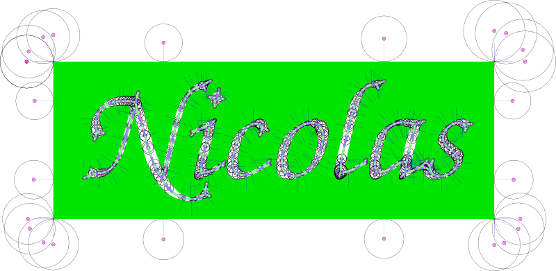

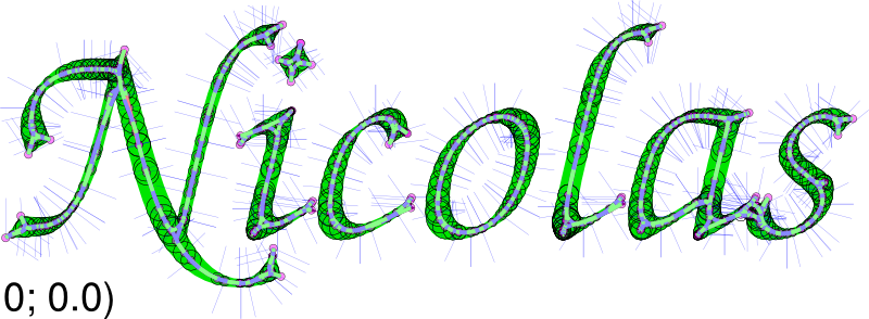

I've broke apart your path and combined "a", "s" and "a"'s hole together. And using latest beta version of Gcode tools the plug-in got these results:
G-code tools engraving (50689 просмотров) <a class='original' href='./download/file.php?id=413&mode=view' target=_blank>Загрузить оригинал (154.74 КБ)</a>
I've used these parameters to generate Engraving trajectory:
Снимок-GCODE tools DEVELOPE.png (50689 просмотров) <a class='original' href='./download/file.php?id=415&mode=view' target=_blank>Загрузить оригинал (34.39 КБ)</a>
Unfortunately it takes a lot of time for me to test it in EMC, so I've not done it.
Here's Gcode for it.
output.ngc
(93.34 КБ) 2692 скачивания
I've tried to process your Path with the latest beta and got nice results. I think you should try latest version it works pretty stable.
g63733.png (50688 просмотров) <a class='original' href='./download/file.php?id=416&mode=view' target=_blank>Загрузить оригинал (130.11 КБ)</a>

Orientation tab
Orientation point 1 X
Orientation point 1 y
Orientation point 2 X
Orientation point 2 y
Orientation point 3 X
Orientation point 3 y
Initial scale
Press apply to create three control points. The transformation (offset,scale,rotation in XY plane) of the path will be automaticaly calculated depending on this points.
You can apply transormations to this points, move them. Just make sure that they are not on one line.
You can modify coordinates that are in the brackets right in the image using text tool.
Initial scale is helpfull if you want to use mm or inches.
For mm set Initial scale to 3.543307087 or use any negative value ("-1" for example).
For inches set Initial scale to 90

root писал(а):Hi Alfcnc!
Thank you for the good words! :)
Now to the case:
First of all I want give some tips about working with engraving
  • You do not have to subtract your path from anything.
    Just make sure that it is a Path. (Ctrl+Shift+C to Oject to Path and Ctrl+Shift+G to ungroup)
    If Engraving's trajectory is outside of the Path you can do Path->Reverse to fix it.
  • Try to avoid combining Paths that do not intersect.
    Engraving calculate offset using all segments of the path and do this calculations n*n times where n is segments number of the path.
    So for the text it's better to convert it to path and combine only those letters that intersect. ("a" and "s" from your example)
  • If you increase number of sample point in the Engraving tab you can get better results.
  • Also some times it could be better to add some nodes to the Path by Extension->Modify Path->Add nodes, but it'll take more time for calculations.
Вложение g47631.png больше недоступно
Вложение Снимок-GCODE tools DEVELOPE.png больше недоступно
Вложение output.ngc больше недоступно
