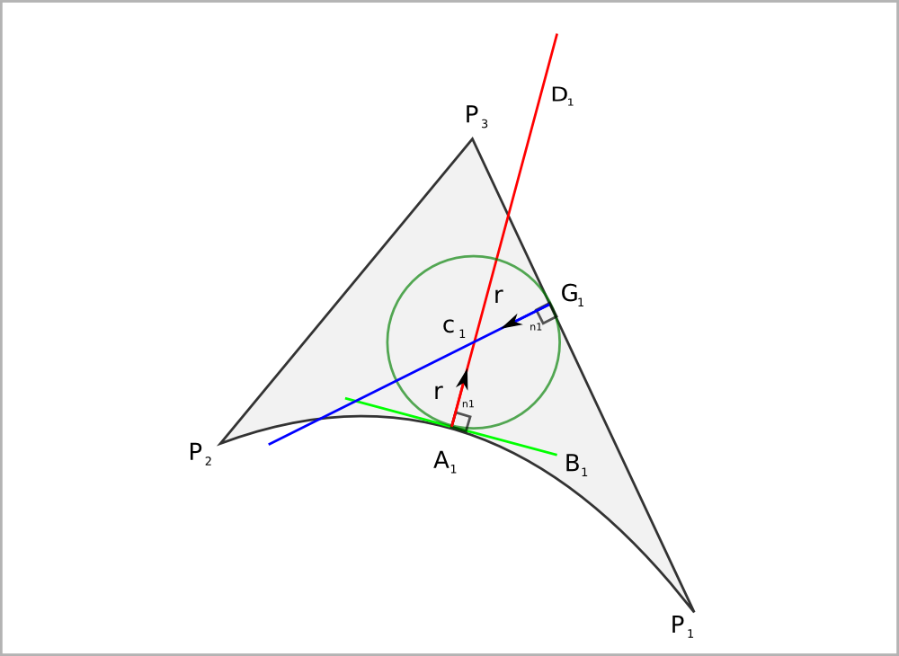

1. To create area paths do the following. Open Gcodetools -> Area and assign Area width, it is the width of the thickest part of the path. You can find thickest path by creating dynamic offset from the path (Ctrl+J) and contract it using node editing tool F2.
gcode pocketing.png (11177 просмотров) <a class='original' href='./download/file.php?id=1399&mode=view' target=_blank>Загрузить оригинал (16.52 КБ)</a>
2. Tool's diameter can be set using tools library by adding tool's definition. If there's no tools definition in the drawing before Area function is applied the default tool will be automatically added to the drawing.
3. In Gcodetools-dev there are some new functions to create area paths. They usually work better than Area function from the Gcodetools 1.6. And allow to get path's like this:
gcode area pocketing.png (11177 просмотров) <a class='original' href='./download/file.php?id=1400&mode=view' target=_blank>Загрузить оригинал (20.59 КБ)</a>
I highly recommend to use gcodetools-dev. See the header of the thread to know how to get Gcodetools-dev.

The problem is that area width is to big. You can notice that after area function you have a group with 61 path. And you have about 55 copyes of outer path. Gcdetools will create (Area width)/(tool diameter) paths. So you have to set area width more carefuly.
Here's a how-to. You can open it in inkscape and try the thing out:
svg to gcode pocketing.svg
(247.18 КБ) 1388 скачиваний
cnc pocketing with inkscape.png (11165 просмотров) <a class='original' href='./download/file.php?id=1403&mode=view' target=_blank>Загрузить оригинал (335.98 КБ)</a>
And here's generated Gcode from one of trials:

Here's a little more detailed explanation of algorithm:
Lets assume these points:
engraving gcode.png (11082 просмотра) <a class='original' href='./download/file.php?id=1446&mode=view' target=_blank>Загрузить оригинал (53.3 КБ)</a>
What we have: a number of Besier's cubic curve segments P1P2 P2P3 and P3P1, and we are given point A1.
What we want: find maximum radius "r" of the circle that lies inside the curve for the given Point A1.
Unfortunately we do not know the point on the other side of the curve (G1).
What do we know about the circle:
1. It's center lies on the normal to the curve at the point A1 (A1D1).
2. It's center lies on the normal to the curve at point G1, we do not know where G point is but know about the normal.
3. Distance A1C1 = r and G1C1 = r.
These give us three equations:
1,2) C1 = A1 + t1*n1 = G1 + t2*n2 // this gives two equations because all points and normals are defined by two parametric functions x(t) and y(t)
3) |A1C1| = |G1C1|
so this gives us the system (last system from my previous post) from 3 parameters t1,t2 and t3. Solving this system we get exact position of point C1 and value for radius r.
When we solve such system for all segments of the curve we can get the maximum radius of the circle that liec inside the curve and touches the path at given point A1. Problem solved :).
