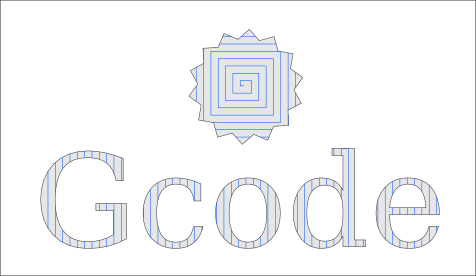

1. To create area paths do the following. Open Gcodetools -> Area and assign Area width, it is the width of the thickest part of the path. You can find thickest path by creating dynamic offset from the path (Ctrl+J) and contract it using node editing tool F2.
gcode pocketing.png (10914 просмотров) <a class='original' href='./download/file.php?id=1399&mode=view' target=_blank>Загрузить оригинал (16.52 КБ)</a>
2. Tool's diameter can be set using tools library by adding tool's definition. If there's no tools definition in the drawing before Area function is applied the default tool will be automatically added to the drawing.
3. In Gcodetools-dev there are some new functions to create area paths. They usually work better than Area function from the Gcodetools 1.6. And allow to get path's like this:
gcode area pocketing.png (10914 просмотров) <a class='original' href='./download/file.php?id=1400&mode=view' target=_blank>Загрузить оригинал (20.59 КБ)</a>
I highly recommend to use gcodetools-dev. See the header of the thread to know how to get Gcodetools-dev.

The problem is that area width is to big. You can notice that after area function you have a group with 61 path. And you have about 55 copyes of outer path. Gcdetools will create (Area width)/(tool diameter) paths. So you have to set area width more carefuly.
Here's a how-to. You can open it in inkscape and try the thing out:
svg to gcode pocketing.svg
(247.18 КБ) 1377 скачиваний
cnc pocketing with inkscape.png (10902 просмотра) <a class='original' href='./download/file.php?id=1403&mode=view' target=_blank>Загрузить оригинал (335.98 КБ)</a>
And here's generated Gcode from one of trials:
output.ngc
(31.26 КБ) 1520 скачиваний

Fill area is one of the last functions and filling the path with straight lines is much easier, so usually Fill area works better, faster, easier, etc. :)
>> Inicial.svg
Great work! Best possible with Area function not from gcodetools-dev version.

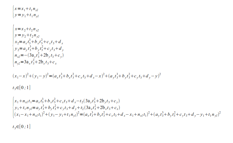

Engraving has some bugs to :). There's no Inkscape function that uses variable radius offset. To find Engraving function in the code search for "def engraving", ant it lasts until the orientation function.
Here's approximate algorithm of Engraving Function:
1. Go trough all path's segments.
2. Get offset for the 4 points of the segment in t=0,0.25,0.75,1.
3. Calculate maximum radius of the circle which will lie inside the path and have center at the normal to the path at specified points. this radius is calculated using numerical methods solving one of these systems:
formula.png (10856 просмотров) <a class='original' href='./download/file.php?id=1427&mode=view' target=_blank>Загрузить оригинал (31.34 КБ)</a>
4. Then a new segment that goes through offsetted points is created.
Most of artifacts appear if there's a lack of nodes in the path near the corners or on the very long segments. You can find problem places turning on show additional debug graphics.
To make engraving trajectory for whole path, not only thing places set Maximum distance for engraving to large value.
To do comments in the Gcode about the tool I belive you can use "tool's change Gcode" and put all comments there. This Gcode will appear just before using current tool, or put it Gcode before path (will appear before cutting each path).

Here's a little more detailed explanation of algorithm:
Lets assume these points:
engraving gcode.png (10819 просмотров) <a class='original' href='./download/file.php?id=1446&mode=view' target=_blank>Загрузить оригинал (53.3 КБ)</a>
What we have: a number of Besier's cubic curve segments P1P2 P2P3 and P3P1, and we are given point A1.
What we want: find maximum radius "r" of the circle that lies inside the curve for the given Point A1.
Unfortunately we do not know the point on the other side of the curve (G1).
What do we know about the circle:
1. It's center lies on the normal to the curve at the point A1 (A1D1).
2. It's center lies on the normal to the curve at point G1, we do not know where G point is but know about the normal.
3. Distance A1C1 = r and G1C1 = r.
These give us three equations:
1,2) C1 = A1 + t1*n1 = G1 + t2*n2 // this gives two equations because all points and normals are defined by two parametric functions x(t) and y(t)
3) |A1C1| = |G1C1|
so this gives us the system (last system from my previous post) from 3 parameters t1,t2 and t3. Solving this system we get exact position of point C1 and value for radius r.
When we solve such system for all segments of the curve we can get the maximum radius of the circle that liec inside the curve and touches the path at given point A1. Problem solved :).
