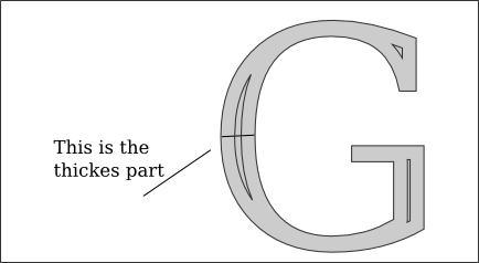

Re: Inkscape Gcodetools plug-in English support forum
Сообщение aguseguedre »
Hello root,
I tried but the file is too big more than 12 MBI
I am goin to try again from the beginning. I make paths to G code from a file saved the day before with the area.
Regards.
aguseguedre
Сообщения: 26
Зарегистрирован: 13 апр 2011, 23:11
Hello again ,
I do not know what I am doing wrong . I have delete the Area 's paths . I deleted the outlines of the logo and letters many times perhaps 20 ,30 times. They are cloned?
I have start from a file with 31,5 Kib
I click ungroup objects
I click objects to paths
I cick Gcode Tools ---> Area---max curves cutting 100 area width 80
area artefacts ---artefacts diameter 2( this is the size of the tool?)
Paths to g code--- Biarc interpolation tolerance 0,5 Maximum splitting deep 4
Options-----scale along z axis 0 offset along z axis 0 Minimum Arc Radius 0,3
In area tab I click Apply............ After a while the area is created and the file is 1.3 MBI
I ungroup the objects and ..............................more while I start to thinking something is bad in my PC some days ago it go extremely slow.
I click --objects to paths
I click ----- extensions---Gcode tools ---Area---Paths to G code I tried two times but the only marked is the outlines and the letters.
I click undo I tried again and now all paths are marked but the file has 12,2 MBI
I don't know what's the problem.
Regards.
Attach your initial svg.
1. To create area paths do the following. Open Gcodetools -> Area and assign Area width, it is the width of the thickest part of the path. You can find thickest path by creating dynamic offset from the path (Ctrl+J) and contract it using node editing tool F2.
gcode pocketing.png (11172 просмотра) <a class='original' href='./download/file.php?id=1399&mode=view' target=_blank>Загрузить оригинал (16.52 КБ)</a>
2. Tool's diameter can be set using tools library by adding tool's definition. If there's no tools definition in the drawing before Area function is applied the default tool will be automatically added to the drawing.
3. In Gcodetools-dev there are some new functions to create area paths. They usually work better than Area function from the Gcodetools 1.6. And allow to get path's like this:
gcode area pocketing.png (11172 просмотра) <a class='original' href='./download/file.php?id=1400&mode=view' target=_blank>Загрузить оригинал (20.59 КБ)</a>
I highly recommend to use gcodetools-dev. See the header of the thread to know how to get Gcodetools-dev.
The problem is that area width is to big. You can notice that after area function you have a group with 61 path. And you have about 55 copyes of outer path. Gcdetools will create (Area width)/(tool diameter) paths. So you have to set area width more carefuly.
Here's a how-to. You can open it in inkscape and try the thing out:
svg to gcode pocketing.svg
(247.18 КБ) 1388 скачиваний
Step 1.
1. Select the path. Make sure it's one path not a Group or several paths.
2. Press Crtl+D to duplicate it.
3. Ctrl+J to make it not Path but Dynamic offset.
4. Press F2 to select Node Editing tool.
5. You'll see only one node on the path. Dragging that node will offset/inset the path.
6. So contract the path to find the thickest place.
Yes yes yes try the second part. To be true Area function was the second function I've made just after Path to Gcode, and it was the second time I programmed python. So it's far not perfect. And it's a kind of difficult thing to work with offsets.
Fill area is one of the last functions and filling the path with straight lines is much easier, so usually Fill area works better, faster, easier, etc. :)
Here's a little more detailed explanation of algorithm:
Lets assume these points:
engraving gcode.png (11077 просмотров) <a class='original' href='./download/file.php?id=1446&mode=view' target=_blank>Загрузить оригинал (53.3 КБ)</a>
What we have: a number of Besier's cubic curve segments P1P2 P2P3 and P3P1, and we are given point A1.
What we want: find maximum radius "r" of the circle that lies inside the curve for the given Point A1.
Unfortunately we do not know the point on the other side of the curve (G1).
What do we know about the circle:
1. It's center lies on the normal to the curve at the point A1 (A1D1).
2. It's center lies on the normal to the curve at point G1, we do not know where G point is but know about the normal.
3. Distance A1C1 = r and G1C1 = r.
These give us three equations:
1,2) C1 = A1 + t1*n1 = G1 + t2*n2 // this gives two equations because all points and normals are defined by two parametric functions x(t) and y(t)
3) |A1C1| = |G1C1|
so this gives us the system (last system from my previous post) from 3 parameters t1,t2 and t3. Solving this system we get exact position of point C1 and value for radius r.
When we solve such system for all segments of the curve we can get the maximum radius of the circle that liec inside the curve and touches the path at given point A1. Problem solved :).
engraving.svg
(20.73 КБ) 1130 скачиваний
