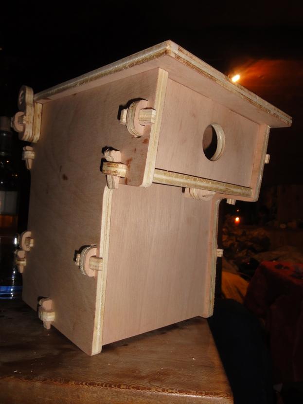

I use linuxCNC on my router for gluing solarpanels at work, and when work is done, I pretty often unscrew the glue pump from the machine, put a spindle on it, and play with gcodetools... And here is my Xmas gift of this year : a little bird's house. To be cut in a 800x600x10mm wood panel with a 6mm cylindrical tool, glue/nails-free assembly, suitable for chidren.
Here are the svg and the ngc files for those who want to try it :
ok_COMPLET_trous_larges_1passe_0001.ngc
(187.74 КБ) 1392 скачивания
chemins -3mm, calepinage 800x600, chemins, trous larges.svg
(59.2 КБ) 1133 скачивания
Should look like this at the end :
DSC04556_1.JPG (7323 просмотра) <a class='original' href='./download/file.php?id=22842&mode=view' target=_blank>Загрузить оригинал (58.43 КБ)</a>

Re: Inkscape Gcodetools plug-in English support forum
Wow cool! Birds should like it :).
