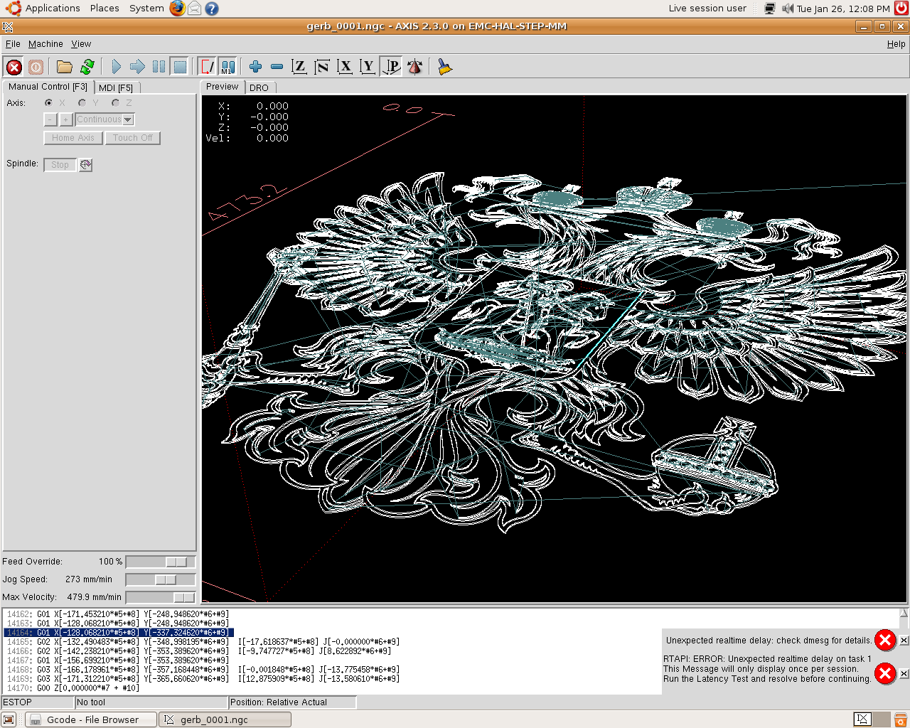

Generated Gcode in EMC2 (1459080 просмотров) <a class='original' href='./download/file.php?id=508&sid=c9a2b766ac109a1ea9bdd5631fa5404c&mode=view' target=_blank>Загрузить оригинал (21.99 КБ)</a>

Preview of the generated Gcode in EMC (1462004 просмотра) <a class='original' href='./download/file.php?id=130&sid=c9a2b766ac109a1ea9bdd5631fa5404c&mode=view' target=_blank>Загрузить оригинал (154.76 КБ)</a>

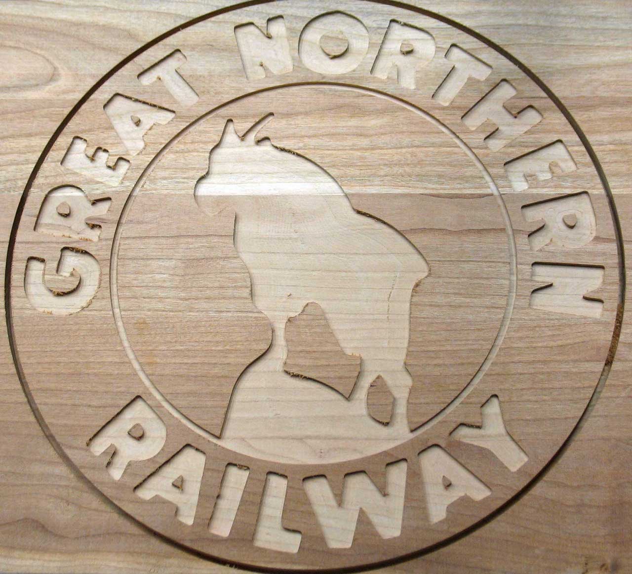

Gcodetools area pocketing (1448107 просмотров) <a class='original' href='./download/file.php?id=772&sid=c9a2b766ac109a1ea9bdd5631fa5404c&mode=view' target=_blank>Загрузить оригинал (147.75 КБ)</a>

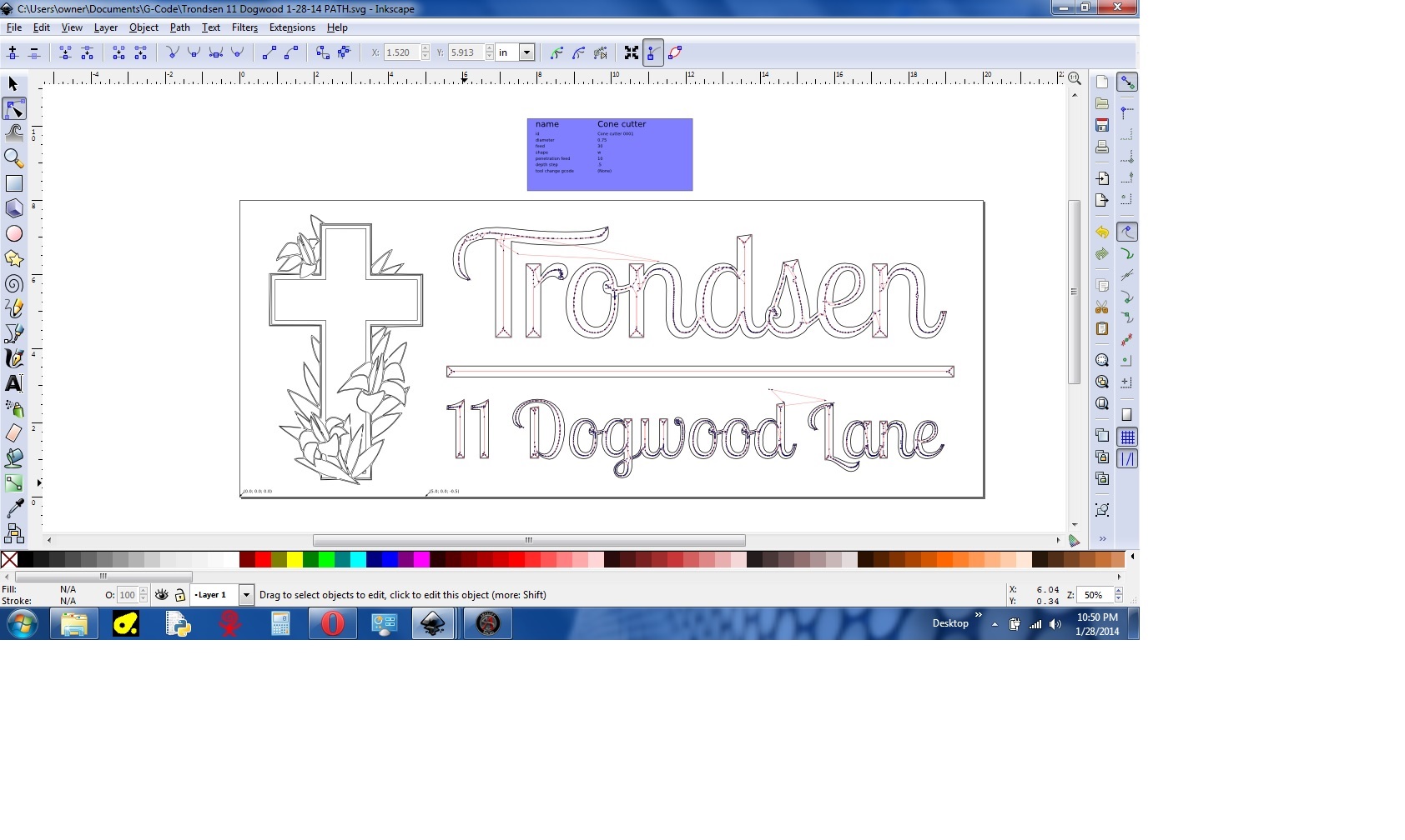

Great work on this extension! It's the only g-code generator I've seen that can generate lead-ins and lead-outs for plasma cutting. I am using the version 1.7, linked to on the first post. I assume this is the latest version?
Two questions though:
1. Is it possible to control the order of the cut paths? Right now if I have a hollow drawing object (say a circle with another circle removed from the inside of it), the generated g-code cuts the outer path first, before the inner path. This is not correct. The inner paths should always be cut first with a plasma cutter (well most 2-d cutters I imagine, such as vinyl).
2. Is it possible to change the direction of the paths? For plasma cutting the current generated directions are backwards. Outer cuts should always be clockwise and inner cuts should be counter-clockwise because of the way the plasma jet swirls. I understand that this is backwards of the direction rotary cutters are typically moved.
I can hack the python code easily enough, if I am pointed in the right direction.
Re: Inkscape Gcodetools plug-in English support forum
torriem писал(а):1. Is it possible to control the order of the cut paths? Right now if I have a hollow drawing object (say a circle with another circle removed from the inside of it), the generated g-code cuts the outer path first, before the inner path. This is not correct. The inner paths should always be cut first with a plasma cutter (well most 2-d cutters I imagine, such as vinyl).
Right now you can control order by moving paths up/down along imaginary Z axis. I.e. the paths that are above others will be cut firstly.
(and you will probably need to uncheck auto sort paths to reduce rapid moves).

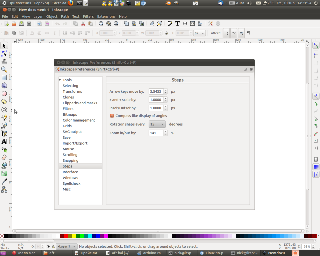

bricofoy писал(а):inkscape should ask for the amount of units you want to inset or outset the path... so you can move your path for half your tool size and it's ok. And now with the newest version I have, the amout of move is defaulted to 2px and I can't find any way to change this.
There are two ways either Path - Dynamyc offset (Ctrl+J) and edit amount in XML editor (Ctrl+Shift+X), or you can define offset's step in Preferences- File-Preferences-Steps.
The bad thing that offset is really complicated procedure and it changes the path from time to time, i.e. offset can be not accurate.
Снимок-70.png (7320 просмотров) <a class='original' href='./download/file.php?id=23287&sid=c9a2b766ac109a1ea9bdd5631fa5404c&mode=view' target=_blank>Загрузить оригинал (187.68 КБ)</a>

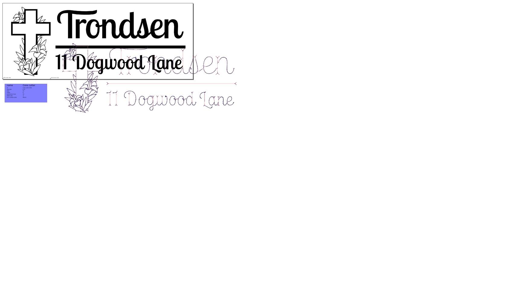

I have used the engrave tool on the path shown, however it produces extra engraving paths at the upper "T" and the lower "d". Is this a problem with my settings, or could it be an issue with the gcode program? svg and ngc files are attached as well. Thanks - BillT
Trondsen Sign path problems.jpg (6812 просмотров) <a class='original' href='./download/file.php?id=24026&sid=c9a2b766ac109a1ea9bdd5631fa5404c&mode=view' target=_blank>Загрузить оригинал (251.48 КБ)</a>
Trondsen 11 Dogwood 1-28-14 PATH.svg
(884.02 КБ) 1107 скачиваний
output_0034.ngc
(99.69 КБ) 1325 скачиваний
billt
Сообщения: 8
Зарегистрирован: 21 окт 2013, 18:11
Сообщение billt »
I eventually figured this one out.
There were duplicate path points that caused the engraving path problems.
After removing the duplicate points, the engraving path is now fixed.
For some reason the engraving is now offset from the original path.
I am not sure what causes this issue.
All of the paths have been combined prior to running the engrave operation.
Any help would be appreciated.
Thanks - BillT
Trondsen sign path offset.jpg (6767 просмотров) <a class='original' href='./download/file.php?id=24269&sid=c9a2b766ac109a1ea9bdd5631fa5404c&mode=view' target=_blank>Загрузить оригинал (105.79 КБ)</a>
billt
Сообщения: 8
Сообщение billt »
Oops.
I must have ungrouped the orientation points from the path group.
When I grouped everything plus orientation points, the result was corrected.
I also found that you need to group the tool definition box as well.
Sorry for the lame posts - hopefully my ignorance may be helpful (or at least entertaining...) to others.
