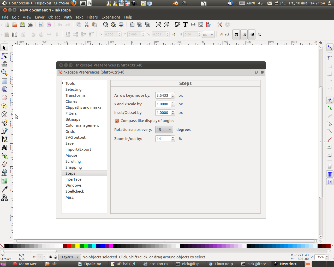

This is what I do myself : I draw my path right where it should be, and then I use the inkscape command "inset" or "outset" from the "Path" menu, Ctrl+( or Ctrl+)
Buuuuuuut....... I look into inkscape to see the exact english menu name to tell you... and there is a big problem, inkscape should ask for the amount of units you want to inset or outset the path... so you can move your path for half your tool size and it's ok. And now with the newest version I have, the amout of move is defaulted to 2px and I can't find any way to change this. Documentation just says the default is 2px. Looks like they changed a very usefull feature to a totally pointless one :cry:
Does anyone know if there is a way to change that value ?
EDIT : ok I found out one solution, it's explained into the "gears" tutorial here : http://www.cnc-club.ru/forum/viewtopic. ... rt=20#p194
you should use "dynamic offset" and do some boring xml editing to adjust the value. But at least you can do it.

bricofoy писал(а):inkscape should ask for the amount of units you want to inset or outset the path... so you can move your path for half your tool size and it's ok. And now with the newest version I have, the amout of move is defaulted to 2px and I can't find any way to change this.
There are two ways either Path - Dynamyc offset (Ctrl+J) and edit amount in XML editor (Ctrl+Shift+X), or you can define offset's step in Preferences- File-Preferences-Steps.
The bad thing that offset is really complicated procedure and it changes the path from time to time, i.e. offset can be not accurate.

Thanks for the tip ! Why the hell is this not mentionned in inkscape documentation ?
Can we imagine a future version of gcodetools can have an option to use G41/G42 for tool radius compensation when using path-to-gcode ? http://linuxcnc.org/docs/html/gcode/gco ... 41_1-G42_1
So we can draw the exact path, set a tool to use, and the rest is automatic...
Problem in that case can be for determining if it should use left or right compensation, but I think you can select this with the color asigned to the path stroke, e.g. green for right and red for left.
Or with the path direction, maybe ?
