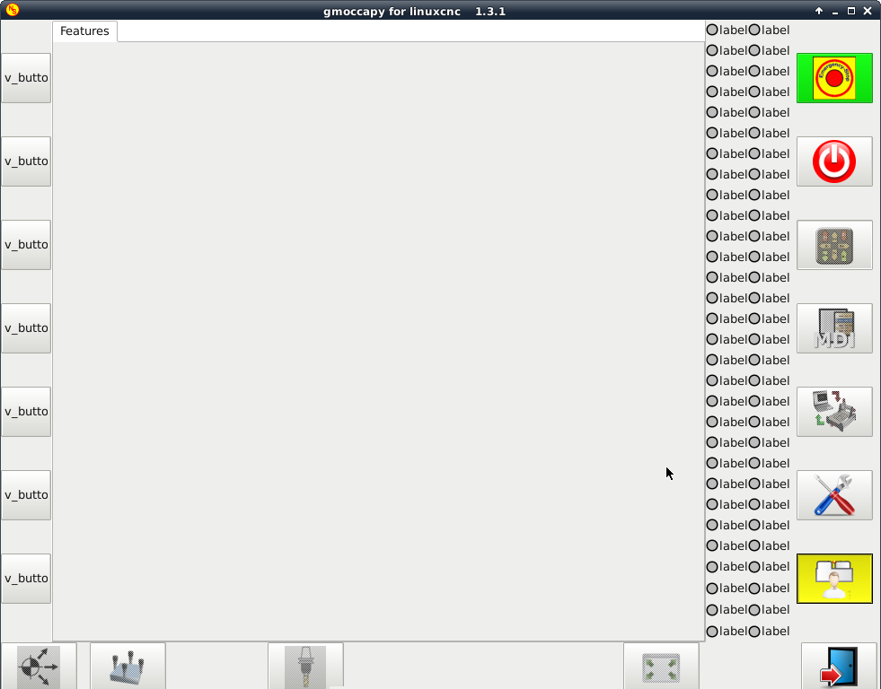

Поставил http://linuxcnc.org/binary.hybrid.iso
обновил linuxcnc до 2.6.4
gmoccapy 1.3.1
никак не активируются кнопки

Вот сообщения при загрузке
 linuxcnc /home/cnc/linuxcnc/configs/test/test.ini
LINUXCNC - 2.6.4
Machine configuration directory is '/home/cnc/linuxcnc/configs/test'
Machine configuration file is 'test.ini'
Starting LinuxCNC...
RTAPI: ERROR: Unexpected realtime delay on task 1
This Message will only display once per session.
Run the Latency Test and resolve before continuing.
/usr/bin/gmoccapy:147: GtkWarning: IA__gtk_entry_set_text: assertion `text != NULL' failed
  self.builder.add_from_file(XMLNAME)
**** GMOCCAPY GETINIINFO ****
 Preference file path: gmoccapy_preferences
/usr/bin/gmoccapy:227: GtkWarning: Invalid icon size 48
  self.widgets.window1.show()
**** GMOCCAPY INFO ****
**** No gmoccapy2.glade file present ****
**** GMOCCAPY ERROR ****
**** Invalid embeded tab configuration ****
**** No tabs will be added! ****
**** audio available! ****
**** No virtual keyboard installed, we checked for <onboard> and <matchbox-keyboard>.
'bool' object has no attribute 'lower'
**** no valid probe config in INI File ****
**** disabled tool measurement ****
******************************* Gcode.lang found
(gmoccapy:4843): GtkSourceView-CRITICAL **: gtk_source_language_manager_set_search_path: assertion `lm->priv->ids == NULL' failed
**** GMOCCAPY INFO : inifile = /home/cnc/linuxcnc/configs/test/test.ini ****:
**** GMOCCAPY INFO : postgui halfile = custom_postgui.hal ****:
/usr/lib/pymodules/python2.7/gmoccapy/notification.py:168: GtkWarning: Invalid icon size 48
  self.popup.show()
('Error: \xd0\xa0\xd0\xb5\xd1\x81\xd1\x83\xd1\x80\xd1\x81 \xd0\xbd\xd0\xb5 \xd0\xbd\xd0\xb0\xd0\xb9\xd0\xb4\xd0\xb5\xd0\xbd.', 'gstfilesrc.c(1042): gst_file_src_start (): /GstPlayBin:player/GstFileSrc:source:\nNo such file "/usr/share/sounds/ubuntu/stereo/dialog-question.ogg"')
/usr/bin/gmoccapy:4028: GtkWarning: Invalid icon size 48
как быть ?

"Home all axis" делал?

UAVpilot писал(а):"Home all axis" делал?
Спасибо мил человек. Все теперь работает.

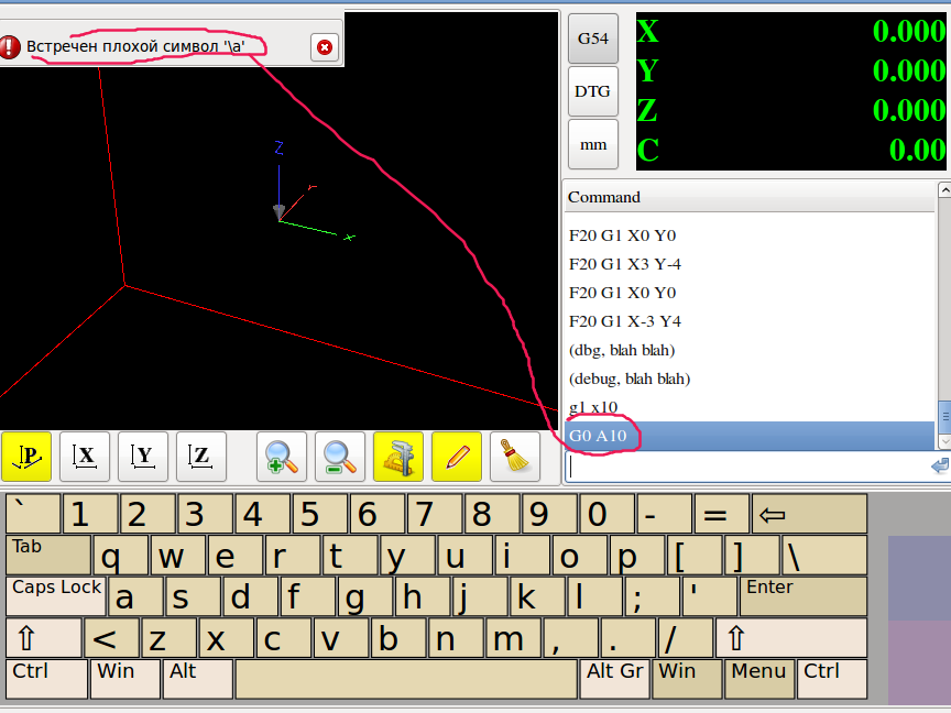

Только я не нашёл где пишутся ошибки при загрузке файлов УП содержащих оные?.. :thinking:

Они, по-моему, сами появляются в выпадающих сообщениях (по умолчанию из левого верхнего угла) .
Re: [WIKI] Интерфейс Gmoccapy , делаем свои дополнения.
Нет, это-бы я заметил - внимательно изучал всевозможные места...
Единственный индикатор ошибки - отсутствие превью после загрузки. А вот какая именно ошибка нигде не узнать... :(

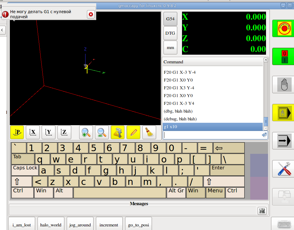

UAVpilot писал(а):всевозможные места...
вы про это:
Выделение_097.png (5274 просмотра) <a class='original' href='./download/file.php?id=36914&sid=754761b0b84c087a7ca53fad5b0f0a26&mode=view' target=_blank>Загрузить оригинал (107.7 КБ)</a>

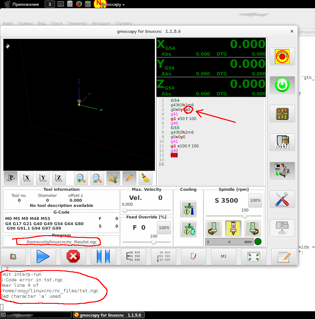

UAVpilot писал(а): Единственный индикатор ошибки - отсутствие превью после загрузки. А вот какая именно ошибка нигде не узнать... :(
А если стартануть gmoccapy из терминала? в терминале вроде все ошибки показываются?
nkp писал(а):вы про это:
Нет, я про загрузку файла с УП:
err.png (5269 просмотров) <a class='original' href='./download/file.php?id=36915&sid=754761b0b84c087a7ca53fad5b0f0a26&mode=view' target=_blank>Загрузить оригинал (174.9 КБ)</a>

verser писал(а): А если стартануть gmoccapy из терминала? в терминале вроде все ошибки показываются?
вижу ты в курсе :)

Странно что этот "Bad character 'a' used" не появился во всплывающем сообщении в gmoccapy..
Доберусь до станка, попробую проверить как у меня этот факт происходит.

UAVpilot писал(а):Нет, я про загрузку файла с УП:
ну так ошибки интерпретатора тоже туда выводятся: кстати - на первом скрине тоже была ошибка интерпретатора)
nkp писал(а):ну так ошибки интерпретатора тоже туда выводятся:
Речь не про MDI, а про загрузку файла с УП.

UAVpilot писал(а): Речь не про MDI, а про загрузку файла с УП.
Такая проблема есть.
Спросил разработчика
Hi Norbert,
 whether а gmoccapy can alert the errors of g-code when loading g-code program?
получил ответ
Hallo verser,
 I am looking for a solution, unfortunately the glade widgets do not have that option yet.
 But it is on my to do list.
 Norbert
