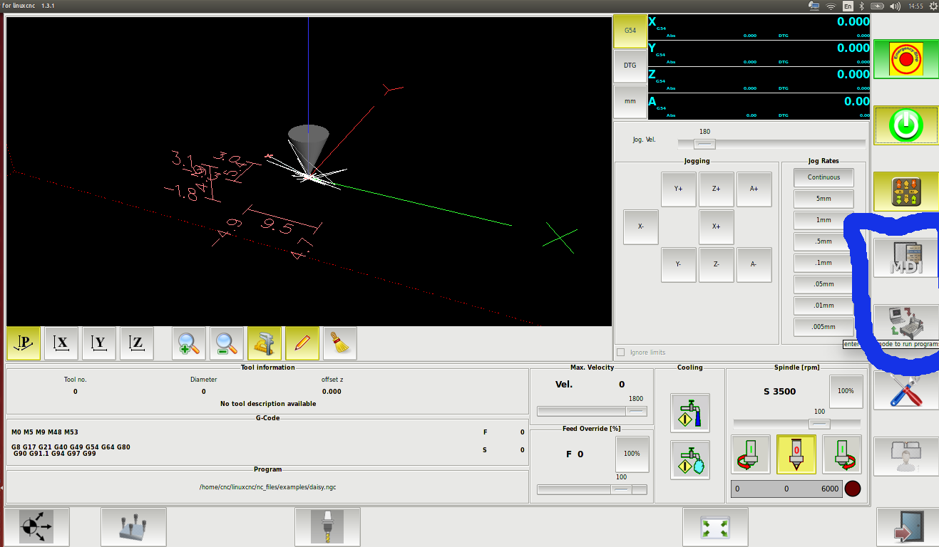

Поставил http://linuxcnc.org/binary.hybrid.iso
обновил linuxcnc до 2.6.4
gmoccapy 1.3.1
никак не активируются кнопки

Вот сообщения при загрузке
 linuxcnc /home/cnc/linuxcnc/configs/test/test.ini
LINUXCNC - 2.6.4
Machine configuration directory is '/home/cnc/linuxcnc/configs/test'
Machine configuration file is 'test.ini'
Starting LinuxCNC...
RTAPI: ERROR: Unexpected realtime delay on task 1
This Message will only display once per session.
Run the Latency Test and resolve before continuing.
/usr/bin/gmoccapy:147: GtkWarning: IA__gtk_entry_set_text: assertion `text != NULL' failed
  self.builder.add_from_file(XMLNAME)
**** GMOCCAPY GETINIINFO ****
 Preference file path: gmoccapy_preferences
/usr/bin/gmoccapy:227: GtkWarning: Invalid icon size 48
  self.widgets.window1.show()
**** GMOCCAPY INFO ****
**** No gmoccapy2.glade file present ****
**** GMOCCAPY ERROR ****
**** Invalid embeded tab configuration ****
**** No tabs will be added! ****
**** audio available! ****
**** No virtual keyboard installed, we checked for <onboard> and <matchbox-keyboard>.
'bool' object has no attribute 'lower'
**** no valid probe config in INI File ****
**** disabled tool measurement ****
******************************* Gcode.lang found
(gmoccapy:4843): GtkSourceView-CRITICAL **: gtk_source_language_manager_set_search_path: assertion `lm->priv->ids == NULL' failed
**** GMOCCAPY INFO : inifile = /home/cnc/linuxcnc/configs/test/test.ini ****:
**** GMOCCAPY INFO : postgui halfile = custom_postgui.hal ****:
/usr/lib/pymodules/python2.7/gmoccapy/notification.py:168: GtkWarning: Invalid icon size 48
  self.popup.show()
('Error: \xd0\xa0\xd0\xb5\xd1\x81\xd1\x83\xd1\x80\xd1\x81 \xd0\xbd\xd0\xb5 \xd0\xbd\xd0\xb0\xd0\xb9\xd0\xb4\xd0\xb5\xd0\xbd.', 'gstfilesrc.c(1042): gst_file_src_start (): /GstPlayBin:player/GstFileSrc:source:\nNo such file "/usr/share/sounds/ubuntu/stereo/dialog-question.ogg"')
/usr/bin/gmoccapy:4028: GtkWarning: Invalid icon size 48
как быть ?
Re: [WIKI] Интерфейс Gmoccapy , делаем свои дополнения.
"Home all axis" делал?
esengul
Сообщения: 41
Зарегистрирован: 29 июл 2014, 17:49
Репутация: 7
Откуда: Bishkek, Kyrgyzstan
Сообщение esengul »
UAVpilot писал(а):"Home all axis" делал?
Спасибо мил человек. Все теперь работает.
