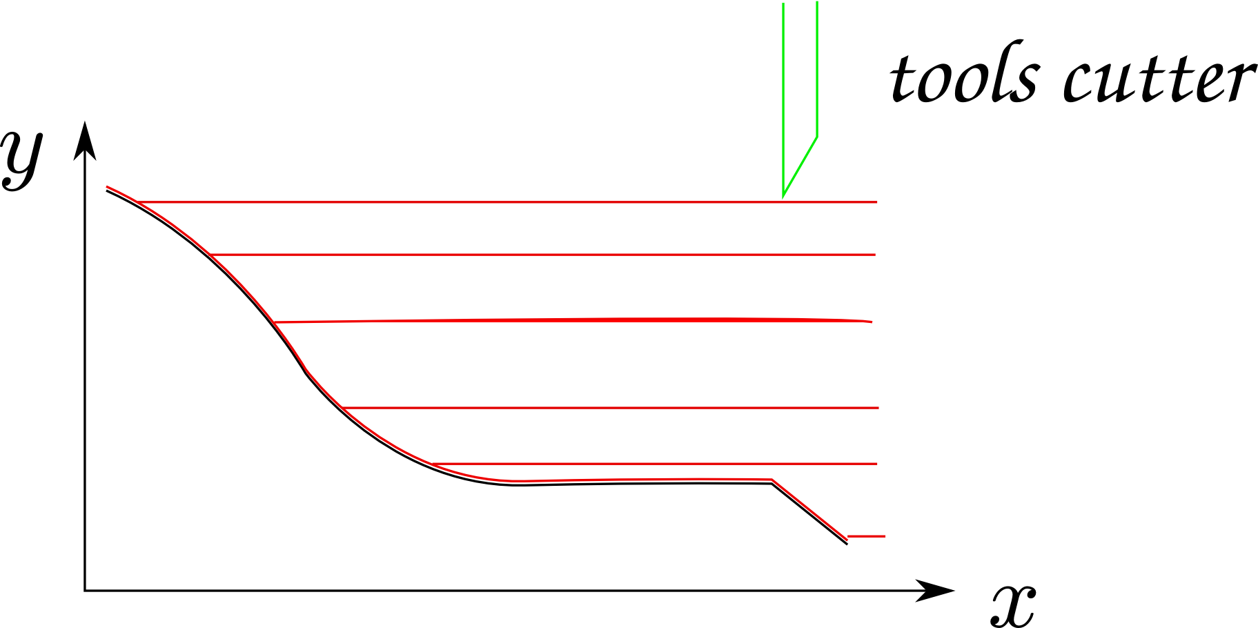

Hi , i've vote For improve path to gcode !
But i think that's its a new feature...
That's be nice to be able to do gcode for turning from a path.
The XY for final cutting was the same than the generate paht-to-gcode and i think that just add an X cycle step for cuting along X axis was enought to be able to do turning path .. !
That's be nice to be able to set the y pass step depth.
turning_path.jpg.png (19100 просмотров) <a class='original' href='./download/file.php?id=483&mode=view' target=_blank>Загрузить оригинал (50.08 КБ)</a>
Have a good night !

Turning path
I think it will be very good if we do extension for turning lathe.
But I can not do it by myself because I have no experience of working with lathe. In our Russian forum there are some different threads than focus on Gcode tools develop. And every thread is pushed by somebody, for example Engraving was involved by Dormouse, Plasma cutting by Aftaev. So I need your help to create this extension, or I can help you to write it by yourself.
There are some questions that should be discussed before implementing lathe extension. I'll create new thread for it.

Сообщение alfcnc »
Ok ! the problem come that I think that the coordinate reference take the point 0,0 automatically
and I have not see the little offset on the coordinate point 0,0...
Excuse me for loose your time.
I have tried and no problem ! very well.
For develop new turning feature I'm not a python programmer.
But can try to make a new tab and see what that do.
Re: Inkscape Gcode tools plug-in English support forum
alfcnc писал(а):For develop new turning feature I'm not a python programmer.
I can do all programing work. I need answers on some technical questions and advises about the interface.
