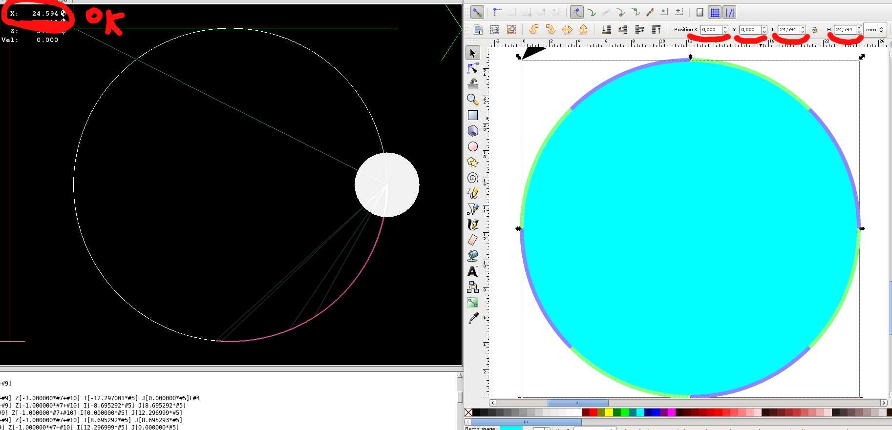

Hi ! I have made some try with path to gcode ! and find error precision in Y conversion.
First screen shot show that in the gcode in left the max X coordinate is good and 2.594.
path_to_gcode_error_X.jpg (19094 просмотра) <a class='original' href='./download/file.php?id=481&sid=01f1d2e8cfd49d6c024cf67babe9a1b4&mode=view' target=_blank>Загрузить оригинал (85.3 КБ)</a>
In this second screen shot when tool is at max Y the value is -24.697 and musd be -24.594 = 0,103mm error...big for some things
good for other but bad for me.
path_to_gcode_error_Y.jpg (19094 просмотра) <a class='original' href='./download/file.php?id=482&sid=01f1d2e8cfd49d6c024cf67babe9a1b4&mode=view' target=_blank>Загрузить оригинал (89.55 КБ)</a>

Re: Inkscape Gcode tools plug-in English support forum
Is there an orientation point at the top of the circle? I see a small distance between orientation point and top of circle. It could be the reason of the circle been moved a little bit to the bottom.
I've tried to reproduce this error but everything seems fine to me.
G02 X[12.348501*#5+#8] Y[-24.697000*#5+#9] Z[-0.282222*#7+#10] I[-8.731709*#5] J[8.731709*#5]

Ok ! the problem come that I think that the coordinate reference take the point 0,0 automatically
and I have not see the little offset on the coordinate point 0,0...
Excuse me for loose your time.
I have tried and no problem ! very well.
