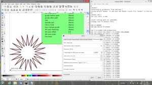

Hello there
I finally managed to engrave my first simple paths with inkscape on the cnc, with a Little help of a friend..
the only Problem according to him, was that the machine, running on Siemens Sinumerik 802D SL.. had Problems with reading everything
between brackets ( ) in the cgode file...
So I had to delete all that manualy.. Is there like a Kind of program who can do that for me??? :thinking:
that would save a lot of time for me
thanks a lot in advance
DSC04140.JPG (22720 просмотров) <a class='original' href='./download/file.php?id=13875&mode=view' target=_blank>Загрузить оригинал (128.34 КБ)</a>
Re: mpf file
you can add to additional postprocessor
regex(r"\(.*\)","");
this will remove any of () and all the content between them.

Сообщение schoggi »
Had another try at it, with the additional stuff ;) unfortunately in the note pad the brackets and their Content are still there ...
the post-ptocessor have to be set at None???
Screenshot (67).png (22658 просмотров) <a class='original' href='./download/file.php?id=13979&mode=view' target=_blank>Загрузить оригинал (446 КБ)</a>
Re: mpf file
Two things.
It seems that postprocessor does not affect Header and Footer. You can change them as it said in the standard header or footer:
(Using default footer. To add your own footer create file "footer" in the output dir.)
Second - recheck that you are opening correct file, there's active option that adds numeric suffix...
I've tried the same postprocessor and it removed all () exept header and footer.

Сообщение schoggi »
all turned out just fine now !!!!!!!!! You saved me a lot of work
thanks again for your time and effort
