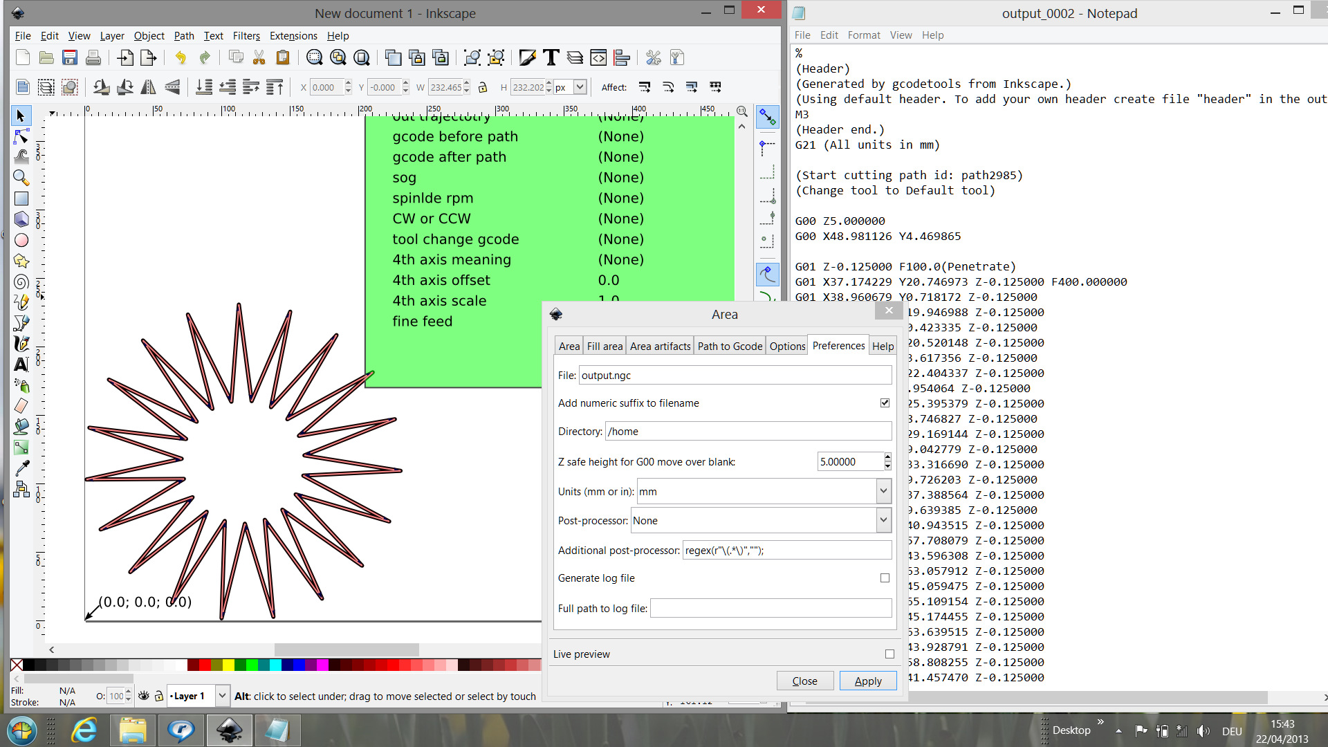

Hello there
I finally managed to engrave my first simple paths with inkscape on the cnc, with a Little help of a friend..
the only Problem according to him, was that the machine, running on Siemens Sinumerik 802D SL.. had Problems with reading everything
between brackets ( ) in the cgode file...
So I had to delete all that manualy.. Is there like a Kind of program who can do that for me??? :thinking:
that would save a lot of time for me
thanks a lot in advance

you can add to additional postprocessor
regex(r"\(.*\)","");
this will remove any of () and all the content between them.

Had another try at it, with the additional stuff ;) unfortunately in the note pad the brackets and their Content are still there ...
the post-ptocessor have to be set at None???
Screenshot (67).png (22713 просмотров) <a class='original' href='./download/file.php?id=13979&mode=view' target=_blank>Загрузить оригинал (446 КБ)</a>
Re: mpf file
Two things.
It seems that postprocessor does not affect Header and Footer. You can change them as it said in the standard header or footer:
(Using default footer. To add your own footer create file "footer" in the output dir.)
Second - recheck that you are opening correct file, there's active option that adds numeric suffix...
I've tried the same postprocessor and it removed all () exept header and footer.

all turned out just fine now !!!!!!!!! You saved me a lot of work
