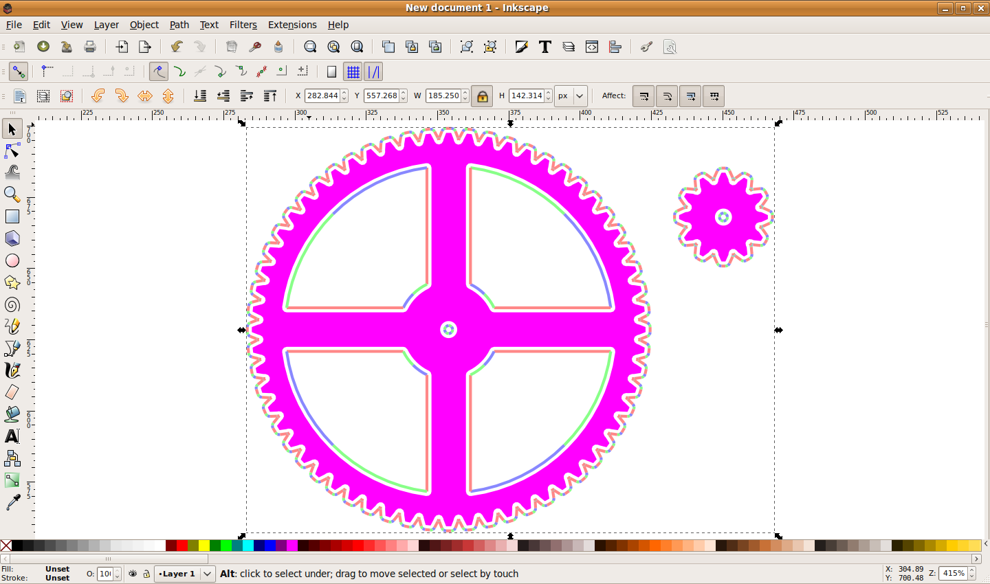

Tutorial 01. Make some gears using Gcode tools and Gear extension.
1. First of all let's draw some gears using Gear extension
Fill in parameters. Note that gear radius depends on Number of teeth and Circular pitch. So if you want your gearbox be 1:5 you should fill in Numbers of teeth 1:5 (12 and 60 for example) other parameters live the same for both gears.
Notice that gears are Group Objects so Ungroup them (Ctrl+Shift+G).
gcode_tools_gear_tutorial_0001.png (129640 просмотров) <a class='original' href='./download/file.php?id=278&mode=view' target=_blank>Загрузить оригинал (118.56 КБ)</a>

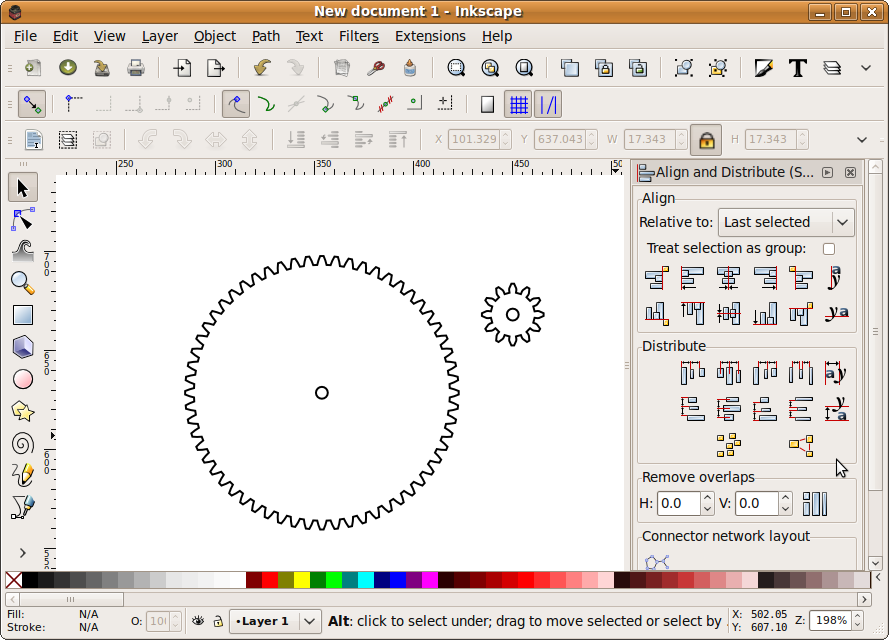

2. Making holes for the roller
Draw the circle with following dimensions 6x6 px.
Attention When Inkscape calculates dimensions it includes stroke width in width and height. So if you want to define exact values remove stroke paint and define values in numerical fields. You can change fill color to see your object.
Make a copy of circle (We have tow gears we need two circles).
Select gear and the circle. Make alignments so circle will be at the center of the gear. (Ctrl+Shift+A -> Center objects horizontally and Center objects vertically).
gcode_tools_gear_tutorial_0002.png (129640 просмотров) <a class='original' href='./download/file.php?id=279&mode=view' target=_blank>Загрузить оригинал (140.31 КБ)</a>
Press Ctrl+"-" or Path->Difference.
Repeat with the second gear.

5. Prepare gears for export to Gcode
If you want your gears be precise you should offset the path by 1/2 of tool diameter to material only outside the gear. You can do it in your controlling software or in Inkscape.
So if you want to do it in Inkscape:
Select first gear. Path->Dynamic offset. Then open XML editor (Ctrl+Shift+X) to define exact value.
Set "inkscape:radius" to the tool diameter/2 (for me it's 1.6 because I have 3.2mm cutter).
Note if you use inches instead of mm you should fill in diameter/2 in inches so it will be 0.125 for 1/4 cutter.
gcode_tools_gear_tutorial_0010.png (129640 просмотров) <a class='original' href='./download/file.php?id=287&mode=view' target=_blank>Загрузить оригинал (105.63 КБ)</a>
Hmmm... It does not look like a good gear, isn't it?
gcode_tools_gear_tutorial_0011.png (129640 просмотров) <a class='original' href='./download/file.php?id=288&mode=view' target=_blank>Загрузить оригинал (126.12 КБ)</a>
But do not worry it should look like that. To see how your gear will look like after cutting, set fill to some color, stroke to white
and stroke width equals to your cutter diameter. Also set stroke join to round join and stroke cap to round cap.
That's better :).
gcode_tools_gear_tutorial_0012.png (129640 просмотров) <a class='original' href='./download/file.php?id=289&mode=view' target=_blank>Загрузить оригинал (127.33 КБ)</a>
You cat see that space between teeth become rounded it is because this distance is only 7mm long and cutter diameter is 3.2mm.
Once more do Path->Object to path to make your gears path not dynamic offsets. (For dynamic offset it is not actually needed but it better be done just in case :) )

I am an EMC2 user as well and would like to do use the area function but cannot understand it. Could you please post back to the forum how you actually made this work.
all you have to do:
1. start thinking in pixels. Start thinking that 1 inch = 1 px
2. Fill in tool diameter.
3. Go to area tab and fill in area radius parameter:
it's area radius in px = area thickest plase in px
you can use Pen (beiser) tool to measure it.
4. Choose Calculate area curves
4. Select your path and press apply.
5. You'll get a group of paths that will cover the area.
Now you can modify them if needed and do ungroup and Path to gcode to export them to Gcode.
One of the interesting things I've found out about inkscape and this plugin is the units. The author recommends to draw in px and then select the units in the G-Code Plugin. I prefer to view my drawing in inches since that is what my machine is configured for. What I do is just put a scaling factor of 1/90 for each of the x and y axis. To set this up I followed the instructions from the website http://www.freesoftwaremagazine.com/boo ... s/inkscape
I then set up the grid (see figure 3). First, I selected File->Document Properties, and set the paper size to US letter and all of the units to “inches”. I then went to the “Grid” tab; started a new “rectangular” grid; and specified minor spacings of 0.05” with major grid lines for every 20 minor lines (which puts the major grid lines on 1” intervals). I then set the colors to something visible enough. Finally, I went to the “Snap” tab; enabled snapping to the grid; and set the sensitivity to the maximum (50 pixels).
About inches:
There are a lot of thin places, for example EMC2 raises an error if arc radius is smaller than .02 mm, but for inches this value is different. I can implement units conversion but we have to describe all thin places first to prevent future bugs.
As for now you can use scaling that provided by the plug-in to convert any units to pixels. And if you'll do it could you write your experience. That will show us a lot of things that have to be done to implement native unit cinversion.
