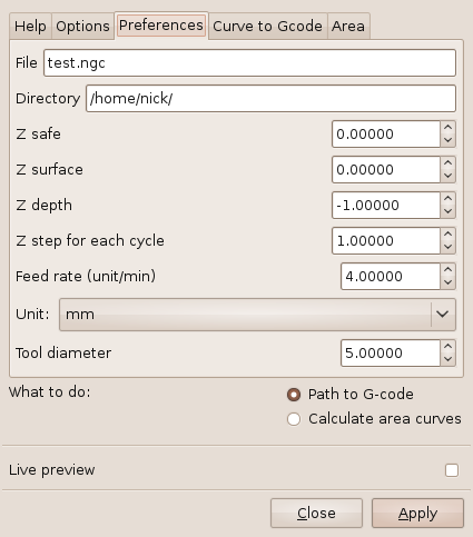

Preferences tab
Снимок-GCODE tools-1.png (127504 просмотра) <a class='original' href='./download/file.php?id=166&sid=9ede8e2fed0ee244c336409be9b448bb&mode=view' target=_blank>Загрузить оригинал (32.67 КБ)</a>
File - file name for output.
Directory - Directory for output. If output directory contains 'header' and/or 'footer' file they will be used as header and footer for resulting Gcode.
Attention! You must specify directory in which you have rights to write! (For example my home directory '/home/nick/')
Z safe - Z coordinate for safe traverse above the object.
Z surface - Z coordinate of the surface.
Z depth - Z coordinate of cutting depth.
Z step for each cycle - The increment value for Z axis for each cycle of multi pass cutting.
Feed rate - feed rate in selected units.
Unit - units. Attention! This value affects only one string in Gcode (in the header there wiil be "G21 (All units in mm)" or "G20 (All units in inch)") no additional calculations are made. This plug-in uses Inkscape's native unit - px, so if mm is selected 1px=1mm, if inch is selected 1px=1". So no mater what is selected result's bounds will be the same in units.
Tool diameter - is tool's diameter in units.

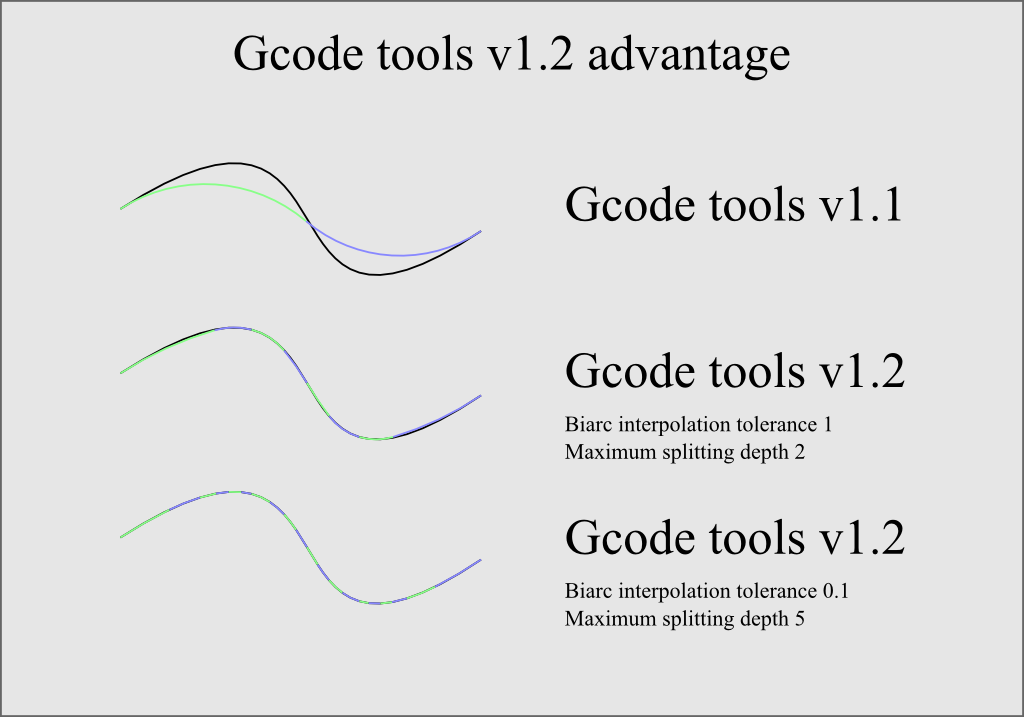

Biarc interpolation tolerance - every time the path's segment being approximated by biarc, distance between biarc and path's segment is calculated. If this distance exceeds difened value the segment splits into two segments, and each of them will be approximated separately.
Maximum splitting depth - defines home many times one segment can be splitted.

Here is an illustration of automatic path subdivision (from ver. 1.2.):
g24649.png (127496 просмотров) <a class='original' href='./download/file.php?id=169&sid=9ede8e2fed0ee244c336409be9b448bb&mode=view' target=_blank>Загрузить оригинал (90.88 КБ)</a>

Select paths you want to export. Open Extensions->Gcode tools.
Fill in parameters in Preferences and Path to Gcode tab.
You will need to fill:
  • Filename
  • Directory
  • Z axis parameters
  • Optionally other parameters
gcode_tools_gear_tutorial_0014.png (129646 просмотров) <a class='original' href='./download/file.php?id=291&sid=9ede8e2fed0ee244c336409be9b448bb&mode=view' target=_blank>Загрузить оригинал (120.74 КБ)</a>
Press Apply.
Gcode tools will convert all paths to circular and straight interpolations (G02, G03 and G01), create file containing Gcode + standard header and footer (in there's no "header" and "footer" files in selected directory), create preview of cutting trajectory (red lines - G01, green and blue - G02 and G03).

  5. Extensions -> Gcode tools... Now we are almost ready to calculate area curves. Fill in the following parameters:
    • At the Preferences tab
      • Tool diameter. Tool diameter mast be in selected units!
    • At the Area tab
      • Maximum area cutting curves (maximum offsets)- this parameter is needed to eliminate infinite loop or creation of big amount of offsets.
      • Area radius - this parameter defines maximum area radius in pixels (Note that 1 px = 1 unit selected in the Preferences tab with out any conversion).

I am an EMC2 user as well and would like to do use the area function but cannot understand it. Could you please post back to the forum how you actually made this work.
all you have to do:
1. start thinking in pixels. Start thinking that 1 inch = 1 px
2. Fill in tool diameter.
3. Go to area tab and fill in area radius parameter:
it's area radius in px = area thickest plase in px
you can use Pen (beiser) tool to measure it.
4. Choose Calculate area curves
4. Select your path and press apply.
5. You'll get a group of paths that will cover the area.
Now you can modify them if needed and do ungroup and Path to gcode to export them to Gcode.
