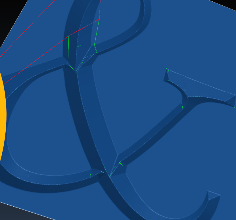

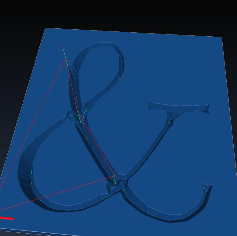

Hello Nick, this is a very cool extension. I have used it for some time past and i turned into a problem now. The engraving path in the gcode is shifted to a higher "y" posiotion and happened a little distorsion in x axis too.
This is the original:
to engrave
and the result:
result
I am puzzled over it, please help!

Thanks for the bug report!
As I thought, still engraving does have some problems with inkscape's transform-matrix. Transromr matrix is inkscape's (and svg's) internal transform which is usually applied by Inkscape or other svg viewer. It helps to prevent distortion after several transforms, where floating point numbers will be rounded to some values.
You can find this transform element in the XML-browser (Ctrl+Shift+X) and check the path and it's parents for transform element.
If you assign it to "" then you'll see the paths are moving...
PS there's a newer version Gcodetools v 1.7. It has new engraving function. But it still has same problem... I'll try to fix it...

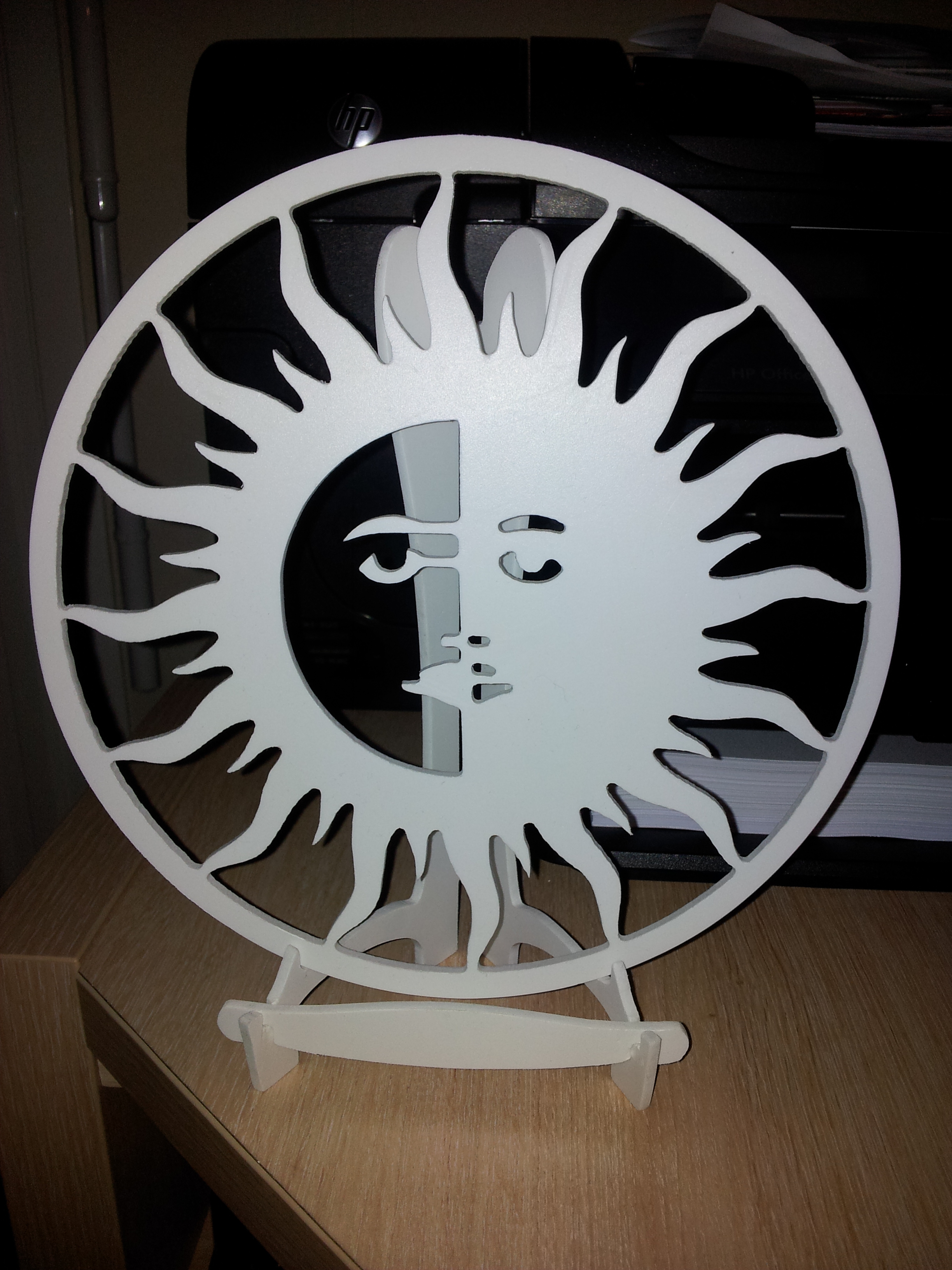

20130508_222732.jpg (25129 просмотров) <a class='original' href='./download/file.php?id=14456&mode=view' target=_blank>Загрузить оригинал (3.07 МБ)</a>
Re: Engraving
Hi!
Sorry for late answer!
migoupil писал(а): R-math.sqrt(max(0,R**2,w**2))
Yes this sounds better :)
migoupil писал(а): It seems better but it's not very clean.
Can you attach the image that shows that non clean result?
PS there's a nice sun you've cut!
