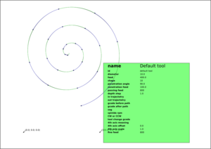

Re: Null output file from gcodetools?
Does it adds any path to the drawing? Like this:
Are you selecting the path?
Is Select all paths if nothing is selected on the Options tab being checked?
Is output.ngc completely empty or it contains something?
What's about header and footer files in the output dir?
And one more, turn on logging: checbox at the preferences tab, and fill in full file name and path to save the log. And attach log here please.
I've done path to gcode using several different versions of gcodetools, and all of them worked fine with your drawing...

Hello,
Sorry for the slow response, have been outside doing chores around the house.
Does it adds any path to the drawing? Like this: "drawing to gcode.png"
No -- have never seen these paths added to the drawing.
Yes, the path is selected
Yes, if I do not select the path the routine tries to use all paths
On ONE occasion, I did get a top and bottom header output. Think this happened after I changed the units on the drawing to inches (was px, previously). Maybe, this is a clue? Other than this one occasion, the file is size 0 and I have not been able to reproduce the output! Strange.
Log file is attached.
Well, there is hope. I still suspect something simple/stupid on my part in the Inkscape setup.
No there should not be any connection to that.Think this happened after I changed the units on the drawing to inches (was px, previously).
According to log, Gcodetools stops somewhere in the Orientation points procedure...
Can you attach your svg file after applying Path to Gcode. With all orientation points ad tool's definition added.
Orientation points procedure uses numpy module, check it's version. But if there any problem with it the error message should be raised...
Try add this line to gcodetools.py remaining indents
print_("Computing transformation matrixes")
self.transform_matrix_reverse[layer] = numpy.linalg.inv(self.transform_matrix[layer]).tolist()
print_("\n Layer '%s' transformation matrixes:" % layer.get(inkex.addNS('label','inkscape')) )
