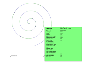

Does it adds any path to the drawing? Like this:
Are you selecting the path?
Is Select all paths if nothing is selected on the Options tab being checked?

Does it adds any path to the drawing? Like this: "drawing to gcode.png"
No -- have never seen these paths added to the drawing.
