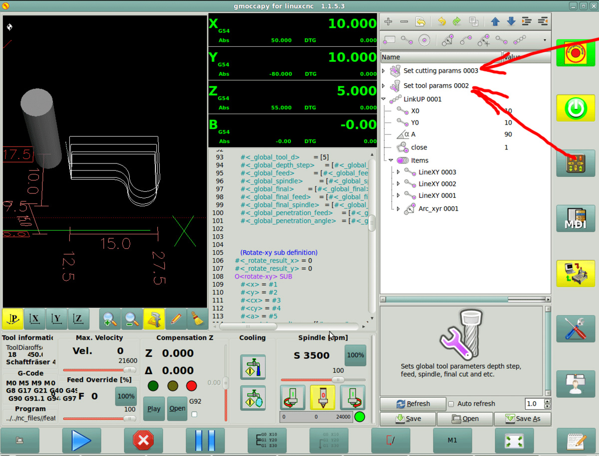

Simply displayed g-code file is not generated as expected.
This is due to the fact that the global variables in processing are not initialized
Try to start the most simple processing - the circle or hexagon.

These treatments should be added and filled at the beginning

Hi,
I tried to make it according to your recommendations.
I checked several videos, but can't figure out what is wrong...
