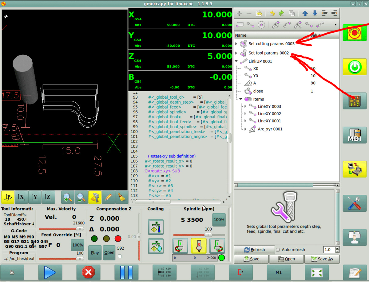

These treatments should be added and filled at the beginning
comp1.jpg (17408 просмотров) <a class='original' href='./download/file.php?id=43079&mode=view' target=_blank>Загрузить оригинал (392.3 КБ)</a>

I tried to make it according to your recommendations.
I checked several videos, but can't figure out what is wrong...

Are you want to use lathe or mill processing?
