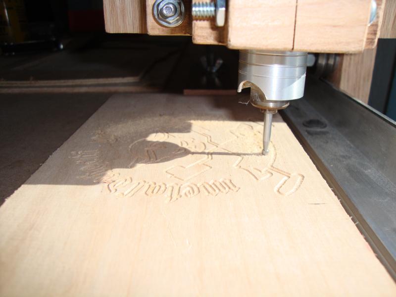

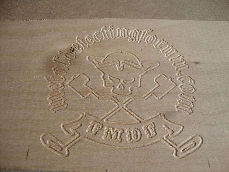

Been playing around yesterday with gcodetools, and did a basic cut to path of a logo I did in inkscape.
I'm starting to really like inkscape and your plugin!
Used a 1/8 ball cutter on a jewellers type dremel. Approximate size of the logo is about 100mm, cut 0.5mm deep, material - cherry wood.
Everything went good.

finished (20366 просмотров) <a class='original' href='./download/file.php?id=1133&mode=view' target=_blank>Загрузить оригинал (58.69 КБ)</a>
finished

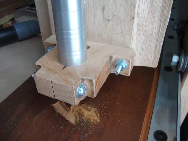

Machine is home built, I started last year and did a lot of upgrades this winter.
Rebuilt the table out of 80/20 aluminum, new Y axis, rebuilt X and Z.
Tool holder is 3/4 cherry wood cut on the cnc.
Will take some photos and post later on.

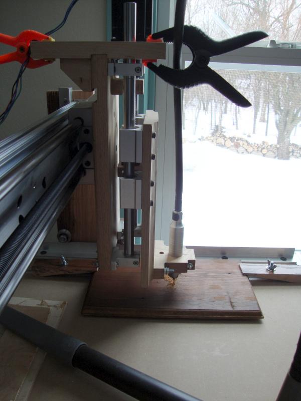

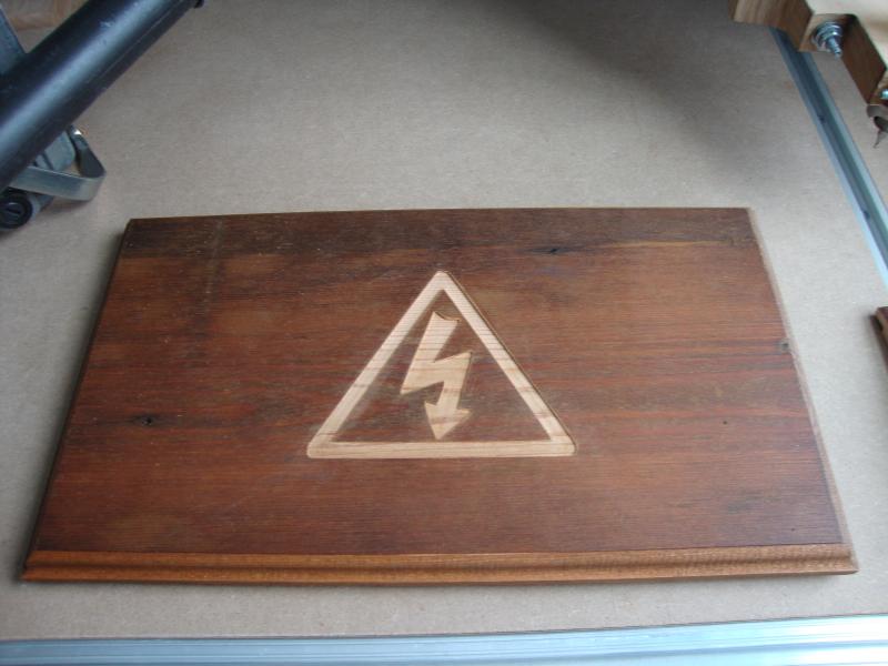

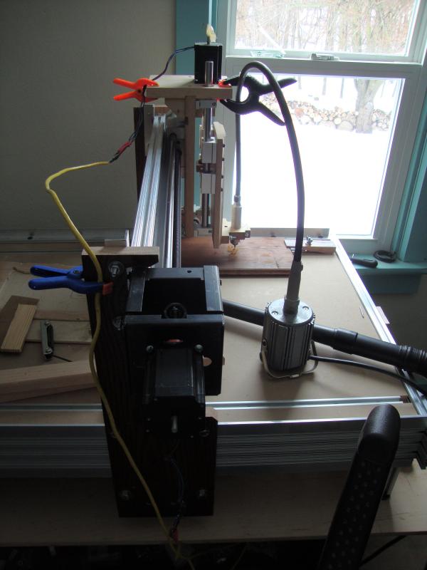

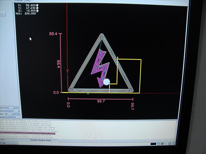

Here are some more pictures of the machine and I cut a little cover door for an electrical box using "area" today.
The machine
cnc.JPG (20347 просмотров) <a class='original' href='./download/file.php?id=1137&mode=view' target=_blank>Загрузить оригинал (50.87 КБ)</a>
Tool holder
toolholder.JPG (20347 просмотров) <a class='original' href='./download/file.php?id=1138&mode=view' target=_blank>Загрузить оригинал (53.39 КБ)</a>

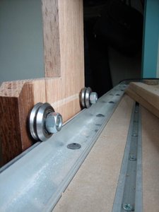

X axis rail, angle aluminium on top and bottom and v-grove berrings
xrails.JPG (20347 просмотров) <a class='original' href='./download/file.php?id=1139&mode=view' target=_blank>Загрузить оригинал (44.04 КБ)</a>
Y&Z axis
yz.JPG (20347 просмотров) <a class='original' href='./download/file.php?id=1140&mode=view' target=_blank>Загрузить оригинал (49.73 КБ)</a>
EMC screen
emc.JPG (20347 просмотров) <a class='original' href='./download/file.php?id=1141&mode=view' target=_blank>Загрузить оригинал (46.65 КБ)</a>
Finished product
finished.JPG (20347 просмотров) <a class='original' href='./download/file.php?id=1142&mode=view' target=_blank>Загрузить оригинал (49.9 КБ)</a>

Thanks for the photos.
What are your rails on X axis made of? Is there any backlash compenstaion?
And does your spindle make a lot of noise or not. I want to by a new spindle for my home cnc, but I'm afraid that my neighbor's wont like it's noise.

Rails on the x are aluminum L angle.
Motor/spindle is very quiet but its not made for running at long periods of time so I have to pause if the code is long, maybe run it for 30-45 minutes at a time. There is no fan on the motor.
Here is what you are looking for http://cgi.ebay.com/FORDOM-C-30-20-000- ... 33620a9103

Backlash is big on the x because I use a regular threaded bar (need to upgrade soon) but easy to compensate in EMC so no big deal.
