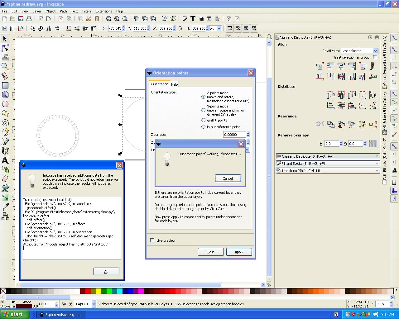

How to fix this? Is there something I need to add? Trudging along.
unittouu.JPG (18752 просмотра) <a class='original' href='./download/file.php?id=67721&mode=view' target=_blank>Загрузить оригинал (204.04 КБ)</a>

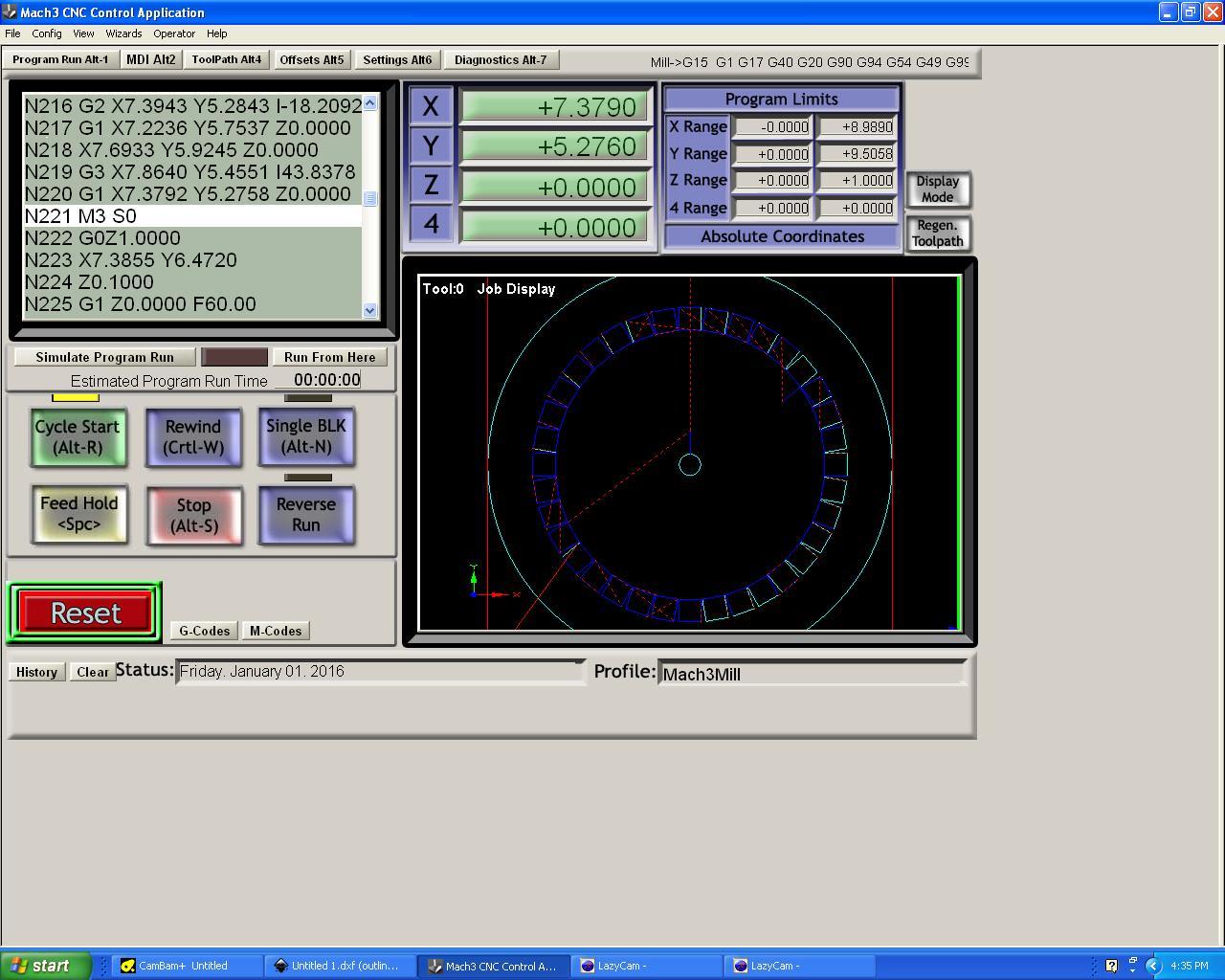

I beating my way through this one perimeter at a time.
I getting closer, everything is in the mach3 program and cutting, BUT, the smoothing effect was to much when getting rid of the splines, so the squares are being cut as rounded squares a bummer, :thinking: but its progress.
gettting closer.JPG (18739 просмотров) <a class='original' href='./download/file.php?id=67750&mode=view' target=_blank>Загрузить оригинал (173.83 КБ)</a>

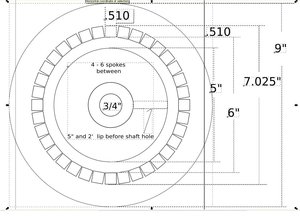

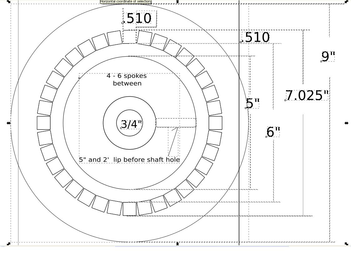

This is the end result I working on. A 9" disk with 36 squares and 1 shaft hole. EMS was so much easier but learning something new is always the way it goes for me.
9 in alternator dimentions.jpg (18739 просмотров) <a class='original' href='./download/file.php?id=67751&mode=view' target=_blank>Загрузить оригинал (105.7 КБ)</a>

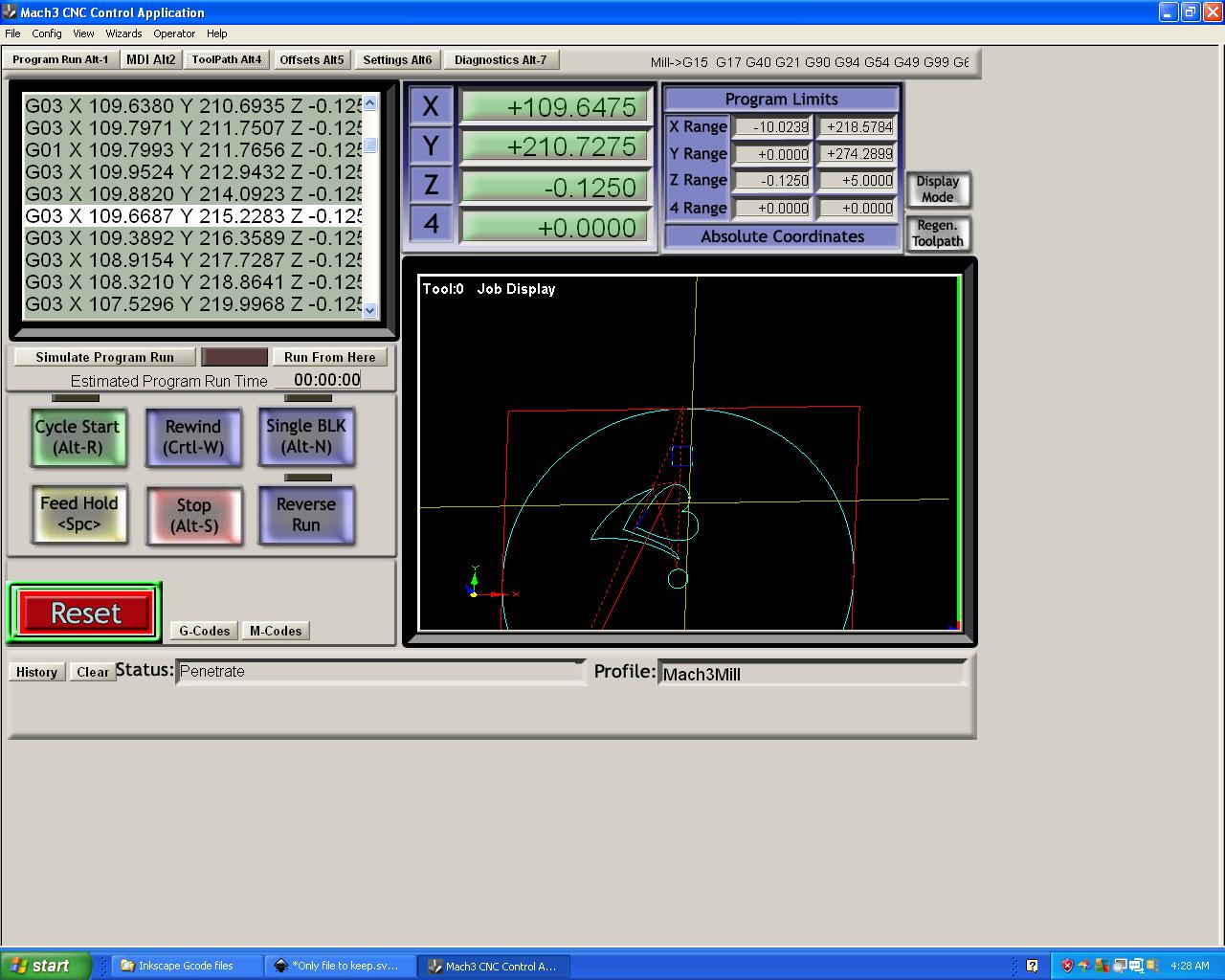

With 4 programs I have my Gcode basics for my disc.
My only issue is with "Modify Path", spline issues in the squares. It works, but not correctly yet, the squares are rounded after modifying. Any suggestions?
I'll keep trudging on through the fog.
:freak_in_action:
GCODE.JPG (18726 просмотров) <a class='original' href='./download/file.php?id=67763&mode=view' target=_blank>Загрузить оригинал (169.14 КБ)</a>

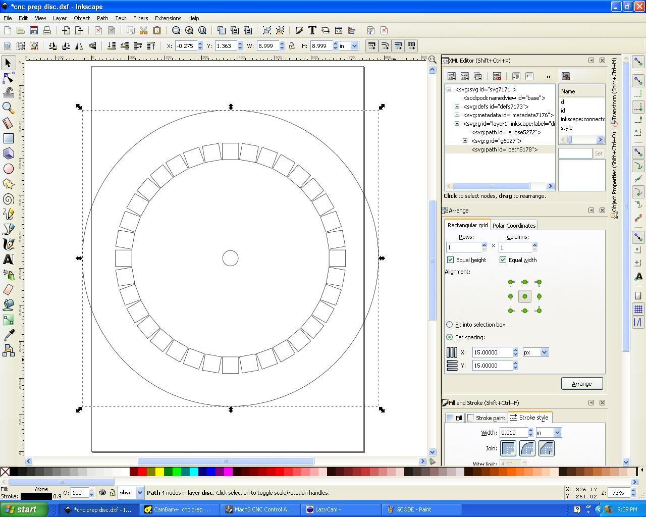

Сообщение AAronvb »
As drawn.
cncprep disc.JPG (18720 просмотров) <a class='original' href='./download/file.php?id=67764&mode=view' target=_blank>Загрузить оригинал (184.56 КБ)</a>

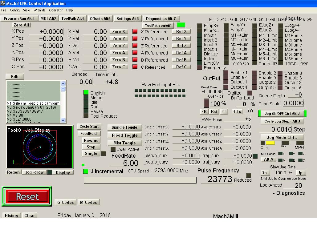

I found the setting for my size issue in the MACH3 CNC settings MM or Inch. The ShapeOKo (http://www.shapeoko.com/wiki/index.php/ ... s_Tutorial) tutorial Gave me the steps to complete the rotor and generate usable Gcode.
This is the completed "9 rotor disc" components which does work size wise on CNC machine in display mode. Time for some wood to test.
My next step is to duplicate everything to complete the disc openings.
I finally got it!
completed disc components.JPG (18688 просмотров) <a class='original' href='./download/file.php?id=68668&mode=view' target=_blank>Загрузить оригинал (175.05 КБ)</a>

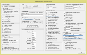

Re: Starting from Scratch, Windows XP installed
01.png (18686 просмотров) <a class='original' href='./download/file.php?id=68671&mode=view' target=_blank>Загрузить оригинал (82.02 КБ)</a>
pup
Сообщения: 673
Репутация: 11

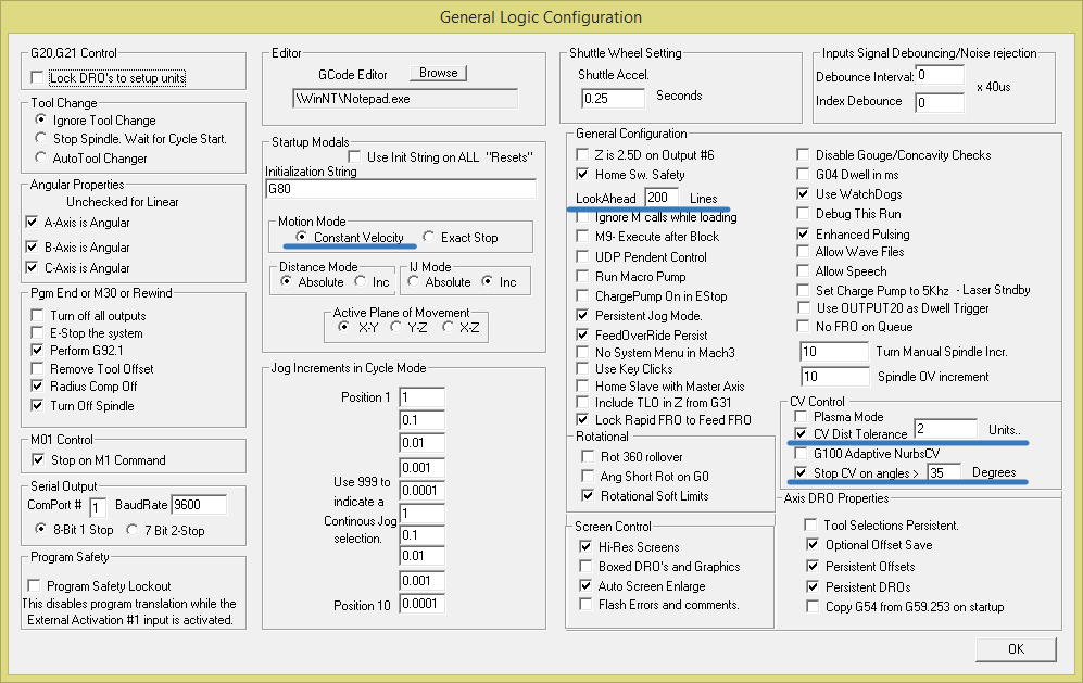

Сообщение pup »

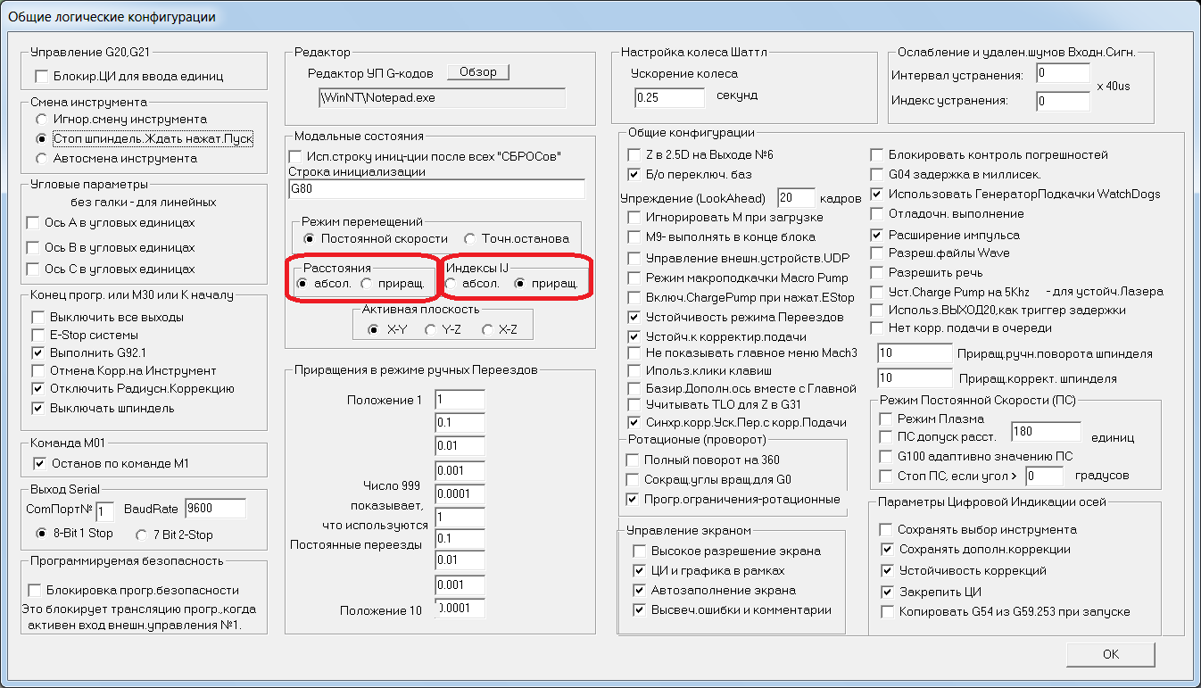

here are the settings that seem to help you with rounded squares...
mach3.png (18675 просмотров) <a class='original' href='./download/file.php?id=68672&mode=view' target=_blank>Загрузить оригинал (31.84 КБ)</a>

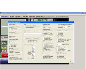

First, why are you using XP?
Second, where are those General Logic Configuration dialogs?
AAronvb
Сообщения: 10
Зарегистрирован: 24 фев 2015, 20:35
Настоящее имя: AAron
Откуда: Ellensburg, wa.
Сообщение AAronvb »
When I purchased the 3040 Chinese CNC mill, I had 3 choices of operating systems to run the machine, XP, WIN 7, and win 2000. I like the XP operating system so that's what I chose.
To be honest I have never seen a dialog box like that. :oops:
I did find it though, nothing is adjusted from factory settings.
I found the issue with the Squares. My error, my squares were not squares, I had hit a node tab and altered it. After redrawing the square the issue was resolved.
general logic configuration.JPG (18620 просмотров) <a class='original' href='./download/file.php?id=70283&mode=view' target=_blank>Загрузить оригинал (194.59 КБ)</a>
