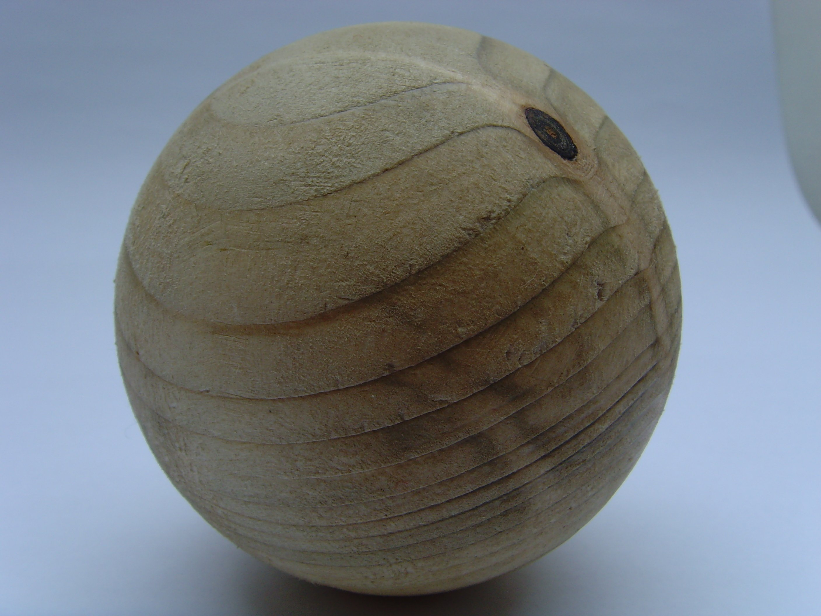

Making a wood ball...
boule.png (14224 просмотра) <a class='original' href='./download/file.php?id=583&mode=view' target=_blank>Загрузить оригинал (134.9 КБ)</a>
boule1.svg
(385.8 КБ) 1609 скачиваний

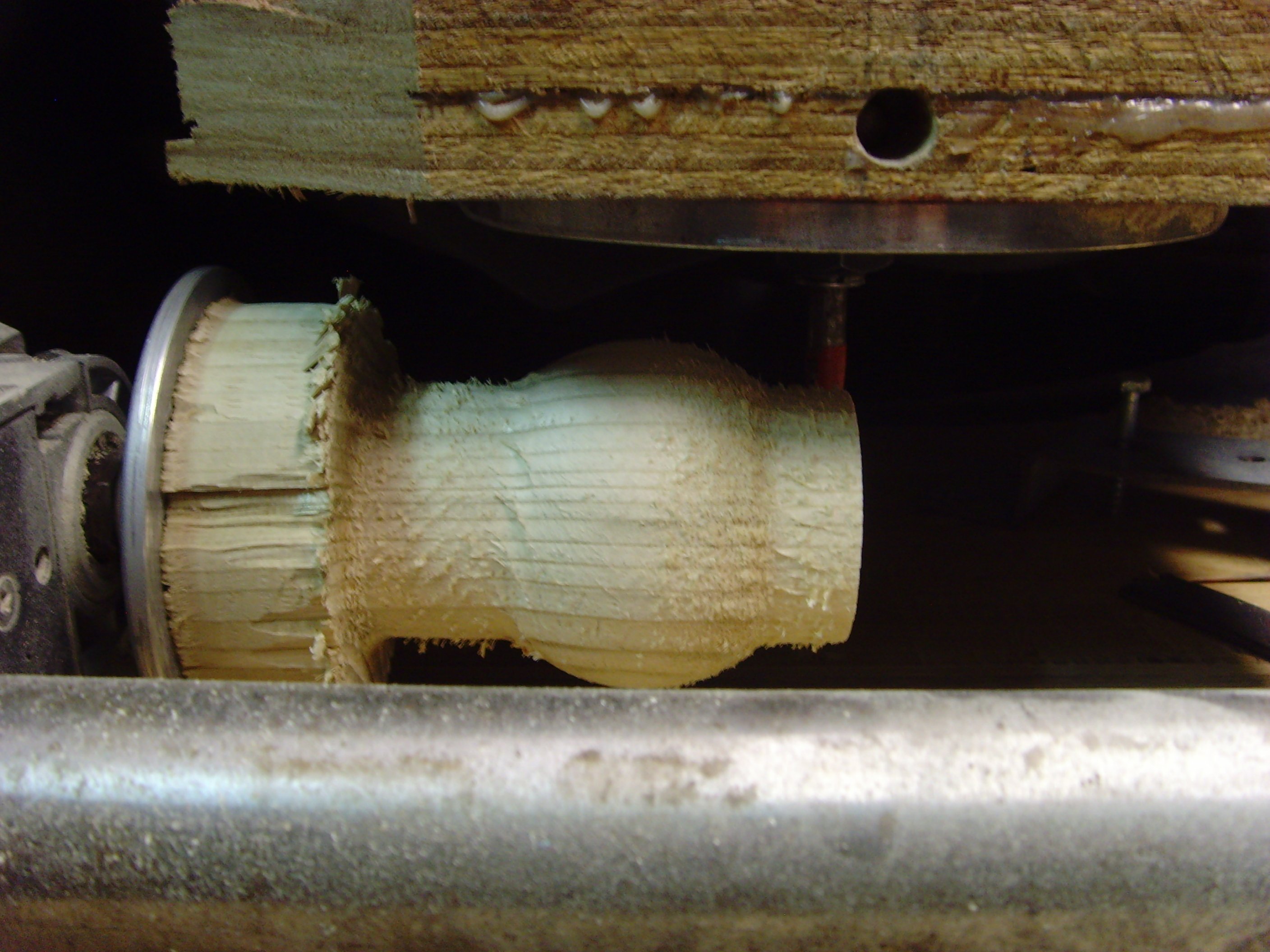

On turning...
turning_ball.jpeg (14224 просмотра) <a class='original' href='./download/file.php?id=584&mode=view' target=_blank>Загрузить оригинал (603.58 КБ)</a>
The result.... :
turning_ball_finish.jpeg (14224 просмотра) <a class='original' href='./download/file.php?id=585&mode=view' target=_blank>Загрузить оригинал (509.41 КБ)</a>

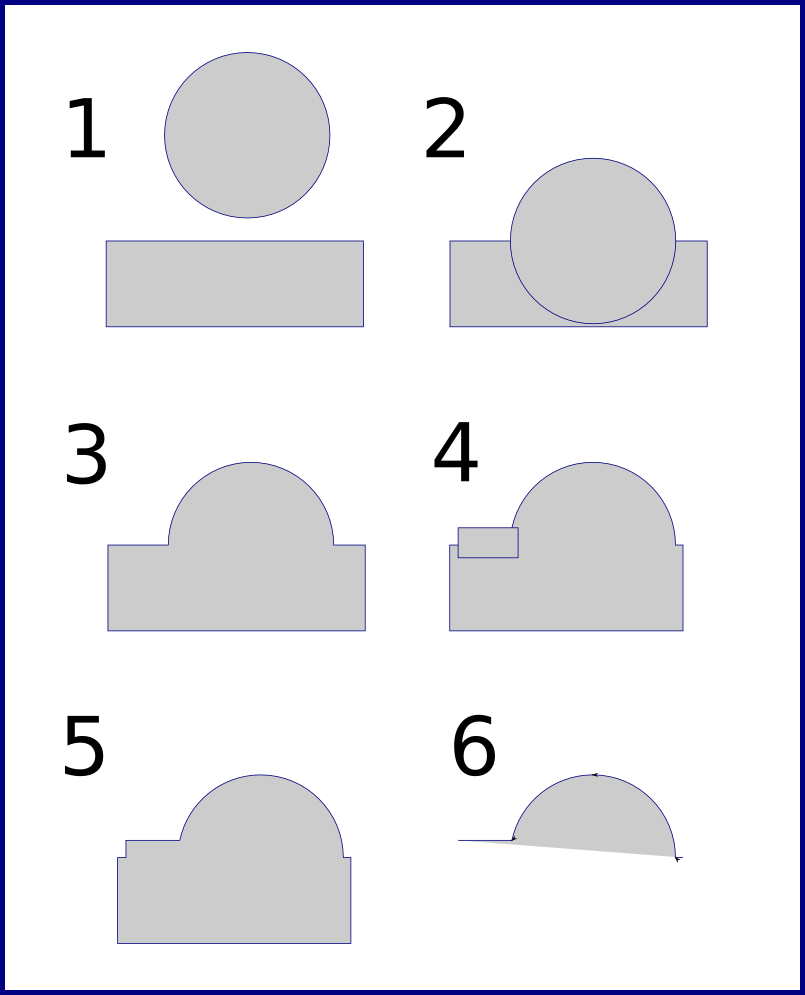

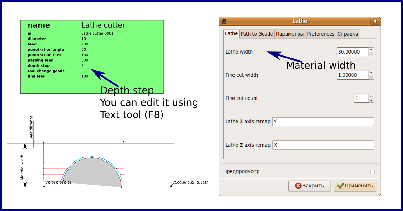

I have some advises:
  1. Remove that vertical line from the left. Material width should be defined in the lathe window.
  2. Add horizontal line at level 0 from the right. Doing this you avoid high depth step during the fine cut at the right.
    0068 gcode tools lathe.png (14219 просмотров) <a class='original' href='./download/file.php?id=589&mode=view' target=_blank>Загрузить оригинал (41.88 КБ)</a>
  3. Define depth step at the tools parameters.
  4. Define material width at lathe's window.
    0066 gcode tools lathe.png (14219 просмотров) <a class='original' href='./download/file.php?id=591&mode=view' target=_blank>Загрузить оригинал (119.29 КБ)</a>
  5. Some advises how to draw your scene:
    1. Draw a circle and a rectangle.
    2. Move circle until it's center not on the rectangle's edge. It will be easy if you turn on snapping and grab circle near the left or right points.
    3. Add them together (Ctrl+Shit+"+")
    4. Add rectangle at the left to hold your ball while it's being cut.
    5. Add them together (Ctrl+Shit+"+")
    6. Using knots editing tool (F2) remove unnecessary knots.
    0067 gcode tools lathe.png (14219 просмотров) <a class='original' href='./download/file.php?id=592&mode=view' target=_blank>Загрузить оригинал (36.58 КБ)</a>
  6. Image that just showing that reverse works:
    0070 gcode tools lathe.png (14219 просмотров) <a class='original' href='./download/file.php?id=593&mode=view' target=_blank>Загрузить оригинал (16.16 КБ)</a>

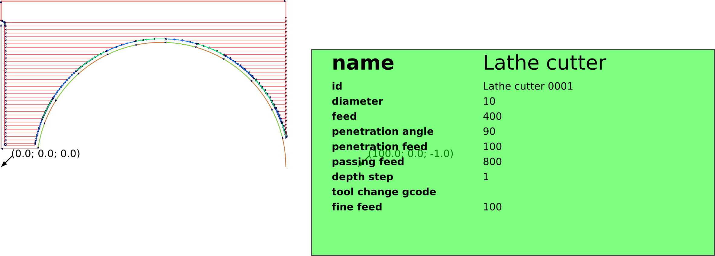

Just for illustrate and show you the errors... of no subdivide of end cutting depth and why i have a vertical line to the left of end of drawing...
because gcodetools go wrong in depht at the start or end of cutting depending the direction...
See on picture...and in gcode file were Y go to negative value....
lathe_error_end_cutting.png (14216 просмотров) <a class='original' href='./download/file.php?id=594&mode=view' target=_blank>Загрузить оригинал (89.85 КБ)</a>
The svg...
lathe_error_end_cutting.svg
(32.72 КБ) 1480 скачиваний

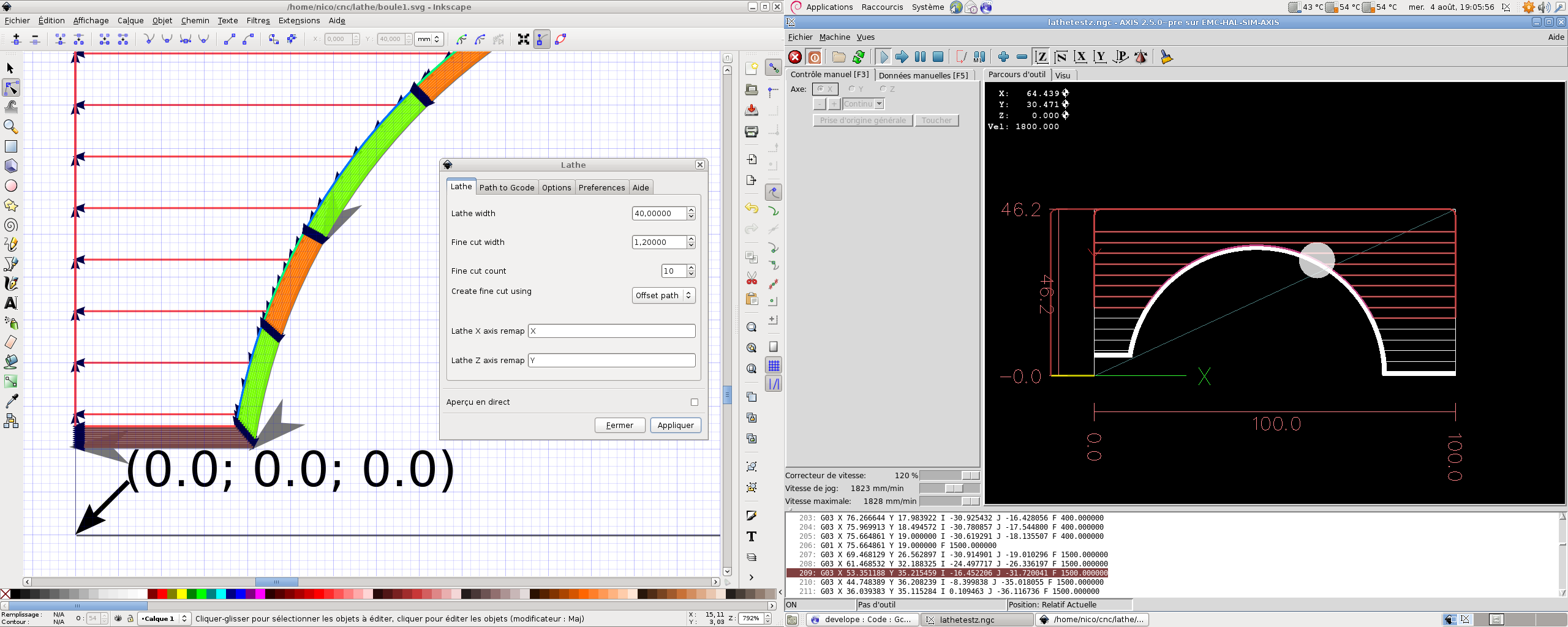

There was a bug... while doing fine cutting penetration g00 was path.y - fine_cutting_width instead of path.y + fine_cutting_width.
I'll correct this in some minutes...
Re: Gcode tools - lathe extension develop
Revision 139
I've add a parameter "Create fine cut using" and two options:
"Move path" just moves original path up. And so creates a number of fine cuts. Gives worse results than offset but there should not be bugs.
"Offsets" offsets original path up. And so creates a number of fine cuts. Gives the best result but could be bugs due to offsets bugs. You can always try it first and in case of bugs try to add some knots to the path near the problem places or just use the first option.
I've changed the inx file so you'll have to run python create_inx.py before using separate lathe window.
Here's an illustration:
0071 gcode tools lathe fine cut.png (14214 просмотров) <a class='original' href='./download/file.php?id=597&mode=view' target=_blank>Загрузить оригинал (111.9 КБ)</a>

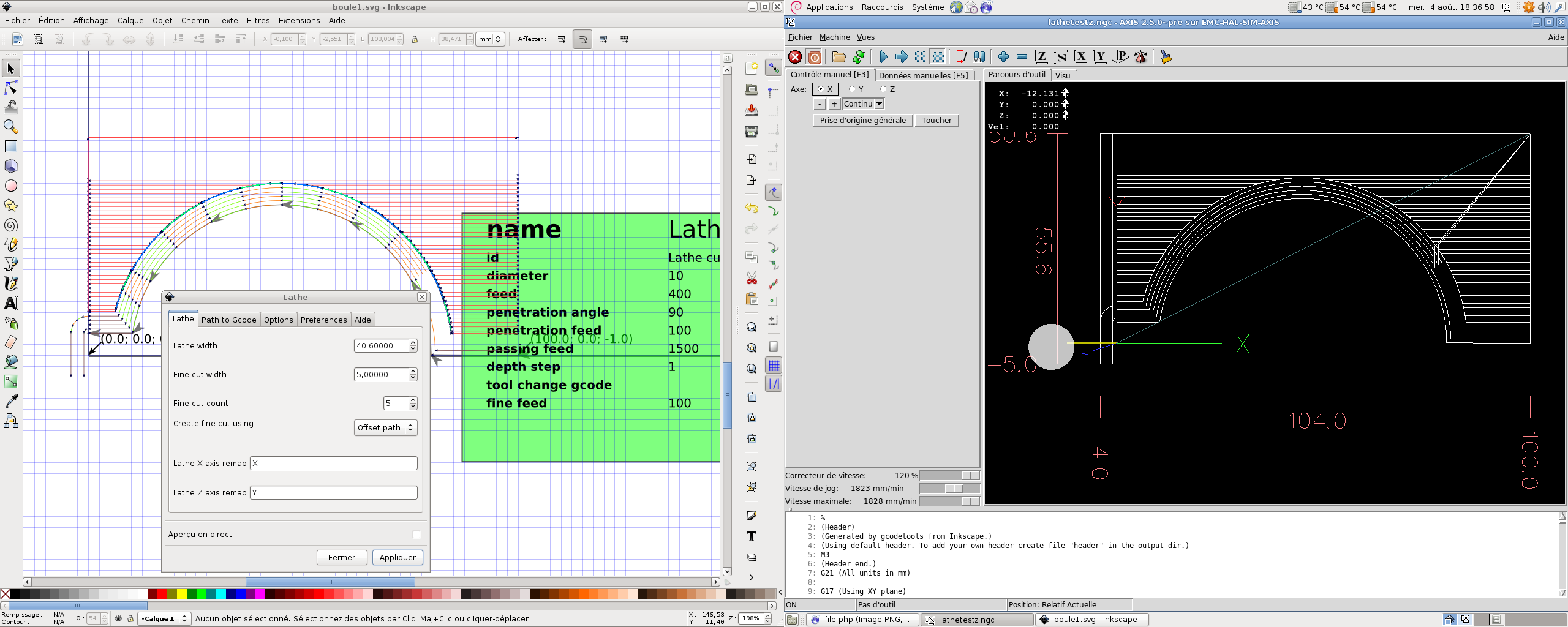

Ok ! That's come great... but little error with offset...
The fine cuting path goes out on the left...
And on the right start at curious position for some of them....
finishing_offset_error.png (14210 просмотров) <a class='original' href='./download/file.php?id=598&mode=view' target=_blank>Загрузить оригинал (292.71 КБ)</a>
svg file with trajectory and setting...
boule1.svg
(368.04 КБ) 1621 скачивание
if setting 1mm fine cut and 5 count the right is good... but left alwas go out...
more_thin_finishing_pass_error_on_left.png (14209 просмотров) <a class='original' href='./download/file.php?id=600&mode=view' target=_blank>Загрузить оригинал (251.4 КБ)</a>
Hum Curious ! I see now with different setting all is ok... curious..perhaps this can help you to find
were is the bug..
fine_cuting_error_ok_with_this_parameters.png (14209 просмотров) <a class='original' href='./download/file.php?id=601&mode=view' target=_blank>Загрузить оригинал (299.73 КБ)</a>
Revision 142
I've found the bug. While calculating line and Bezier curve intersection we have to solve cubic equation and take only real roots that are 0<=root<=1. But due to calculation tolerances root becomes 1.000000001 which was ignored. Now we take roots that's abs(root.imag)<1e-7 = 0.0000001 and -0.0000000001<=root.real<=1.0000000001.
Thanks for the bug report :D!

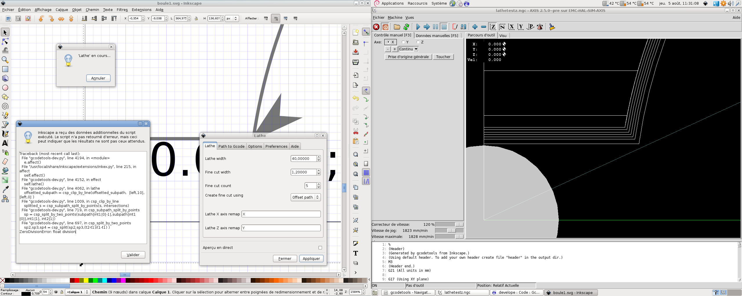

Hi despit the debugging another bug arrive... :think:
With some value gcodetools give a zero division error see on screen capture...
lathebug_rev142_divisionerror.png (14200 просмотров) <a class='original' href='./download/file.php?id=604&mode=view' target=_blank>Загрузить оригинал (270.45 КБ)</a>
And with another value that's work but the before last fine cuting path is lost....
see another screen capture...
lathe_rev_142_one_line_missing.png (14200 просмотров) <a class='original' href='./download/file.php?id=603&mode=view' target=_blank>Загрузить оригинал (265.66 КБ)</a>

Revision 142
I think I've fixed first problem.
I've added tolerance=0.0000000001 into csp_split_by_two_points function.
The second problem caused by offset's clipping errors. I really do not know how to fix them right now. You can add some knots to path to do a "local" fix.

Ok ! process, processing...
The svg file is the same than post just previous this post... Boule1.svg...
were I have just change the direction of cutting path from "right to left" to
" left to right" with revert path... you'll have the bug with about all the value
you can set for fine cut.... very easy to reproduce...
