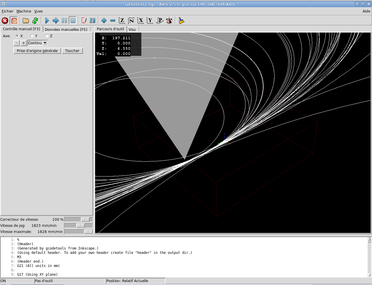

Ok for the I,J,K problem you must just add the G17 or G18 or G19 word before G02 command for select the good working plane because
the default one in EMC² is the XY plane.
For example when remapping in gcode tools is
X rempa to Z
and
Z remap to X
or X to X an Z to Z
The gcode after G21 must be G18 see the screenshot !
and gcodefile
lathe_on_mill_in_ZX_configuration.png (16586 просмотров) <a class='original' href='./download/file.php?id=562&mode=view' target=_blank>Загрузить оригинал (88.16 КБ)</a>

If generate gcode for lathe config of EMC² : gcodetools remaping X to X and Z to Z .the AXE for arcs are invert in J and K see screenshot in next post for see the effect... big problem...
I must set remap with X remap to Z and Z remap to X to have gcode who show good shape in emc..
And must add the G18 after G21 !
And the last move for return the tools to G0 X0 Z0 was broken and Gcode tools have set G0 X0 "Y0"....that's block loading and running of the gcode in the EMC² lathe config...
After this change the code load and run good in EMC² config and in emc mill config and run like a Vertical lathe : Wonderful ! Big thank's for this that's give to almost cnc mill config to turn little part or Big part if big CNC or BIG mill that was convert to EMC ...

Re: Gcode tools - lathe extension develop
1. I'll add G18 or etc if plane is not XY.
2. The last G01 x0 y0 are taken from the default footer. You can add your own header and footers if you want (just add "header" and "footer" files into output directory).
3. Gcode breaks because of that X and Z axis have been flipped. If you flip the axis ccw turns to cw, so G03 and G02 has to be swapped. I'll fix that.
4. By the way are you using full version of inx file or not. If not try to run "python create_inx.py" and then copy all created inx's into your inkscape's extensions directory. A new section Gcodetools will be added into extensions menu.
