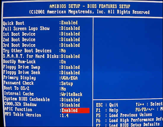

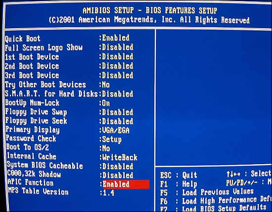

Короче, соль в том что я юзаю EMC2 месяцев 7-8.
Потекли у меня электролиты на матери, отдал мать в ремон. Перепаяли, всё ок.
Сейчас стартую EMC2 и получаю такое вот сообщение (даже с дэфолтными конфигами).
Кто знает, в чём дело?

[    0.000000] Local APIC disabled by BIOS -- you can enable it with "lapic"
[    0.000000] APIC: disable apic facility

[    0.000000] Enabling unmasked SIMD FPU exception support... done.
[    0.000000] Initializing CPU#0
[    0.000000] allocated 2620800 bytes of page_cgroup
[    0.000000] please try 'cgroup_disable=memory' option if you don't want memory cgroups
[    0.000000] Initializing HighMem for node 0 (00000000:00000000)
[    0.000000] Memory: 495588k/524224k available (4539k kernel code, 27864k reserved, 1928k data, 620k init, 0k highmem)
[    0.000000] virtual kernel memory layout:
[    0.000000]     fixmap  : 0xfff1e000 - 0xfffff000   ( 900 kB)
[    0.000000]     pkmap   : 0xff800000 - 0xffc00000   (4096 kB)
[    0.000000]     vmalloc : 0xe07f0000 - 0xff7fe000   ( 496 MB)
[    0.000000]     lowmem  : 0xc0000000 - 0xdfff0000   ( 511 MB)
[    0.000000]       .init : 0xc0751000 - 0xc07ec000   ( 620 kB)
[    0.000000]       .data : 0xc056ecbc - 0xc0750e68   (1928 kB)
[    0.000000]       .text : 0xc0100000 - 0xc056ecbc   (4539 kB)
[    0.000000] Checking if this processor honours the WP bit even in supervisor mode...Ok.
[    0.000000] SLUB: Genslabs=13, HWalign=32, Order=0-3, MinObjects=0, CPUs=1, Nodes=1
[    0.000000] Hierarchical RCU implementation.
[    0.000000] NR_IRQS:2304 nr_irqs:256
[    0.000000] I-pipe 2.6-03: pipeline enabled.
[    0.000000] Console: colour VGA+ 80x25
[    0.000000] console [tty0] enabled
[    0.000000] Fast TSC calibration using PIT
[    0.000000] Detected 1677.656 MHz processor.
[    0.008006] Calibrating delay loop (skipped), value calculated using timer frequency.. 3355.31 BogoMIPS (lpj=6710624)
[    0.008035] Security Framework initialized
[    0.008074] AppArmor: AppArmor initialized
[    0.008086] Mount-cache hash table entries: 512
[    0.008277] Initializing cgroup subsys ns
[    0.008283] Initializing cgroup subsys cpuacct
[    0.008289] Initializing cgroup subsys memory
[    0.008303] Initializing cgroup subsys devices
[    0.008307] Initializing cgroup subsys freezer
[    0.008310] Initializing cgroup subsys net_cls
[    0.008335] CPU: CLK_CTL MSR was 60031223. Reprogramming to 20031223
[    0.008341] CPU: L1 I Cache: 64K (64 bytes/line), D cache 64K (64 bytes/line)
[    0.008344] CPU: L2 Cache: 256K (64 bytes/line)
[    0.008350] mce: CPU supports 4 MCE banks
[    0.008377] Performance Events: AMD PMU driver.
[    0.008394] ... version:                0
[    0.008396] ... bit width:              48
[    0.008399] ... generic registers:      4
[    0.008402] ... value mask:             0000ffffffffffff
[    0.008405] ... max period:             00007fffffffffff
[    0.008408] ... fixed-purpose events:   0
[    0.008410] ... event mask:             000000000000000f
[    0.008416] Checking 'hlt' instruction... OK.
[    0.024720] SMP alternatives: switching to UP code
[    0.031835] Freeing SMP alternatives: 31k freed
[    0.031880] ACPI: Core revision 20090903
[    0.039115] ACPI: setting ELCR to 0200 (from 0a20)
[    0.040108] ftrace: converting mcount calls to 0f 1f 44 00 00
[    0.040127] ftrace: allocating 21003 entries in 42 pages
[    0.050731] Enabling APIC mode:  Flat.  Using 0 I/O APICs
[    0.050739] weird, boot CPU (#0) not listed by the BIOS.
[    0.050742] SMP motherboard not detected.
[    0.050746] Local APIC not detected. Using dummy APIC emulation.
[    0.050749] SMP disabled
[    0.051124] Brought up 1 CPUs
[    0.051128] Total of 1 processors activated (3355.31 BogoMIPS).
[    0.051476] CPU0 attaching NULL sched-domain.
[    0.051748] devtmpfs: initialized
[    0.052234] regulator: core version 0.5
[    0.052310] NET: Registered protocol family 16
[    0.052495] EISA bus registered
[    0.052508] ACPI: bus type pci registered
[    0.054412] PCI: PCI BIOS revision 2.10 entry at 0xfb200, last bus=1
[    0.054416] PCI: Using configuration type 1 for base access
[    0.055527] bio: create slab <bio-0> at 0
[    0.056161] ACPI: EC: Look up EC in DSDT
[    0.062045] ACPI: Interpreter enabled
[    0.062049] ACPI: (supports S0 S5)
[    0.062065] ACPI: Using PIC for interrupt routing
[    0.067906] ACPI: No dock devices found.
[    0.068048] ACPI: PCI Root Bridge [PCI0] (0000:00)
[    0.068113] pci 0000:00:00.0: reg 10 32bit mmio pref: [0xe8000000-0xe9ffffff]
[    0.068206] pci 0000:00:01.0: supports D1
[    0.068237] pci 0000:00:0a.0: reg 10 io port: [0xd000-0xd01f]
[    0.068264] pci 0000:00:0a.0: reg 30 32bit mmio pref: [0x000000-0x007fff]
[    0.068388] pci 0000:00:11.1: reg 20 io port: [0xd400-0xd40f]
[    0.068461] pci 0000:00:11.2: reg 20 io port: [0xd800-0xd81f]
[    0.068529] pci 0000:00:11.3: reg 20 io port: [0xdc00-0xdc1f]
[    0.068583] pci 0000:00:11.5: reg 10 io port: [0xe000-0xe0ff]
[    0.068675] pci 0000:01:00.0: reg 10 32bit mmio: [0xea000000-0xeaffffff]
[    0.068682] pci 0000:01:00.0: reg 14 32bit mmio pref: [0xe0000000-0xe7ffffff]
[    0.068701] pci 0000:01:00.0: reg 30 32bit mmio pref: [0x000000-0x00ffff]
[    0.068750] pci 0000:00:01.0: bridge 32bit mmio: [0xea000000-0xebffffff]
[    0.068756] pci 0000:00:01.0: bridge 32bit mmio pref: [0xe0000000-0xe7ffffff]
[    0.068765] pci_bus 0000:00: on NUMA node 0
[    0.068771] ACPI: PCI Interrupt Routing Table [\_SB_.PCI0._PRT]
[    0.086663] ACPI: PCI Interrupt Link [LNKA] (IRQs 1 3 4 *5 6 7 10 11 12 14 15)
[    0.086849] ACPI: PCI Interrupt Link [LNKB] (IRQs 1 3 4 5 6 7 10 11 12 14 15) *0, disabled.
[    0.087080] ACPI: PCI Interrupt Link [LNKC] (IRQs 1 3 4 5 6 7 10 *11 12 14 15)
[    0.087300] ACPI: PCI Interrupt Link [LNKD] (IRQs 1 3 4 5 6 7 10 *11 12 14 15)
[    0.087473] vgaarb: device added: PCI:0000:01:00.0,decodes=io+mem,owns=io+mem,locks=none
[    0.087478] vgaarb: loaded
[    0.087679] SCSI subsystem initialized
[    0.087821] libata version 3.00 loaded.
[    0.087938] usbcore: registered new interface driver usbfs
[    0.087956] usbcore: registered new interface driver hub
[    0.088023] usbcore: registered new device driver usb
[    0.088230] ACPI: WMI: Mapper loaded
[    0.088233] PCI: Using ACPI for IRQ routing
[    0.088397] NetLabel: Initializing
[    0.088400] NetLabel:  domain hash size = 128
[    0.088403] NetLabel:  protocols = UNLABELED CIPSOv4
[    0.088426] NetLabel:  unlabeled traffic allowed by default
[    0.088479] Switching to clocksource tsc
[    0.091636] AppArmor: AppArmor Filesystem Enabled
[    0.091666] pnp: PnP ACPI init
[    0.091699] ACPI: bus type pnp registered
[    0.096101] pnp: PnP ACPI: found 16 devices
[    0.096104] ACPI: ACPI bus type pnp unregistered
[    0.096110] PnPBIOS: Disabled by ACPI PNP
[    0.096131] system 00:02: ioport range 0x4000-0x407f has been reserved
[    0.096136] system 00:02: ioport range 0x5000-0x500f has been reserved
[    0.096144] system 00:03: ioport range 0x4d0-0x4d1 has been reserved
[    0.096148] system 00:03: ioport range 0x800-0x805 has been reserved
[    0.096153] system 00:03: ioport range 0x290-0x297 has been reserved
[    0.130945] pci 0000:00:01.0: PCI bridge, secondary bus 0000:01
[    0.130949] pci 0000:00:01.0:   IO window: disabled
[    0.130957] pci 0000:00:01.0:   MEM window: 0xea000000-0xebffffff
[    0.130962] pci 0000:00:01.0:   PREFETCH window: 0xe0000000-0xe7ffffff
[    0.130981] pci 0000:00:01.0: setting latency timer to 64
[    0.130989] pci_bus 0000:00: resource 0 io:  [0x00-0xffff]
[    0.130993] pci_bus 0000:00: resource 1 mem: [0x000000-0xffffffff]
[    0.130997] pci_bus 0000:01: resource 1 mem: [0xea000000-0xebffffff]
[    0.131001] pci_bus 0000:01: resource 2 pref mem [0xe0000000-0xe7ffffff]
[    0.131055] NET: Registered protocol family 2
[    0.131183] IP route cache hash table entries: 4096 (order: 2, 16384 bytes)
[    0.131576] TCP established hash table entries: 16384 (order: 5, 131072 bytes)
[    0.131800] TCP bind hash table entries: 16384 (order: 5, 131072 bytes)
[    0.132021] TCP: Hash tables configured (established 16384 bind 16384)
[    0.132025] TCP reno registered
[    0.132149] NET: Registered protocol family 1
[    0.132175] pci 0000:00:01.0: disabling DAC on VIA PCI bridge
[    0.132222] pci 0000:01:00.0: Boot video device
[    0.132575] Scanning for low memory corruption every 60 seconds
[    0.132706] audit: initializing netlink socket (disabled)
[    0.132724] type=2000 audit(1364470258.131:1): initialized
[    0.142784] Trying to unpack rootfs image as initramfs...
[    0.155977] HugeTLB registered 4 MB page size, pre-allocated 0 pages
[    0.158228] VFS: Disk quotas dquot_6.5.2
[    0.158319] Dquot-cache hash table entries: 1024 (order 0, 4096 bytes)
[    0.164037] fuse init (API version 7.13)
[    0.164238] msgmni has been set to 968
[    0.164629] alg: No test for stdrng (krng)
[    0.164679] Block layer SCSI generic (bsg) driver version 0.4 loaded (major 253)
[    0.164684] io scheduler noop registered
[    0.164687] io scheduler anticipatory registered
[    0.164690] io scheduler deadline registered
[    0.164744] io scheduler cfq registered (default)
[    0.164889] pci_hotplug: PCI Hot Plug PCI Core version: 0.5
[    0.164922] pciehp: PCI Express Hot Plug Controller Driver version: 0.4
[    0.165037] input: Power Button as /devices/LNXSYSTM:00/LNXSYBUS:00/PNP0C0C:00/input/input0
[    0.165044] ACPI: Power Button [PWRB]
[    0.165112] input: Sleep Button as /devices/LNXSYSTM:00/LNXSYBUS:00/PNP0C0E:00/input/input1
[    0.165121] ACPI: Sleep Button [SLPB]
[    0.165214] input: Power Button as /devices/LNXSYSTM:00/LNXPWRBN:00/input/input2
[    0.165218] ACPI: Power Button [PWRF]
[    0.167309] Serial: 8250/16550 driver, 4 ports, IRQ sharing enabled
[    0.167433] serial8250: ttyS0 at I/O 0x3f8 (irq = 4) is a 16550A
[    0.167568] serial8250: ttyS1 at I/O 0x2f8 (irq = 3) is a 16550A
[    0.167921] 00:09: ttyS0 at I/O 0x3f8 (irq = 4) is a 16550A
[    0.168055] 00:0a: ttyS1 at I/O 0x2f8 (irq = 3) is a 16550A
[    0.169600] brd: module loaded
[    0.170295] loop: module loaded
[    0.170459] input: Macintosh mouse button emulation as /devices/virtual/input/input3
[    0.171193] ACPI: PCI Interrupt Link [LNKA] enabled at IRQ 5
[    0.171198] PCI: setting IRQ 5 as level-triggered
[    0.171206] pata_acpi 0000:00:11.1: PCI INT A -> Link[LNKA] -> GSI 5 (level, low) -> IRQ 5
[    0.171213] pata_acpi 0000:00:11.1: VIA VLink IRQ fixup, from 255 to 5
[    0.171328] pata_acpi 0000:00:11.1: PCI INT A disabled
[    0.171580] isapnp: Scanning for PnP cards...
[    0.184096] Fixed MDIO Bus: probed
[    0.184152] PPP generic driver version 2.4.2
[    0.184245] tun: Universal TUN/TAP device driver, 1.6
[    0.184249] tun: (C) 1999-2004 Max Krasnyansky <maxk@qualcomm.com>
[    0.184402] ehci_hcd: USB 2.0 'Enhanced' Host Controller (EHCI) Driver
[    0.184445] ohci_hcd: USB 1.1 'Open' Host Controller (OHCI) Driver
[    0.184463] uhci_hcd: USB Universal Host Controller Interface driver
[    0.185123] ACPI: PCI Interrupt Link [LNKD] enabled at IRQ 11
[    0.185128] PCI: setting IRQ 11 as level-triggered
[    0.185136] uhci_hcd 0000:00:11.2: PCI INT D -> Link[LNKD] -> GSI 11 (level, low) -> IRQ 11
[    0.185152] uhci_hcd 0000:00:11.2: UHCI Host Controller
[    0.185222] uhci_hcd 0000:00:11.2: new USB bus registered, assigned bus number 1
[    0.185258] uhci_hcd 0000:00:11.2: irq 11, io base 0x0000d800
[    0.185432] usb usb1: configuration #1 chosen from 1 choice
[    0.185476] hub 1-0:1.0: USB hub found
[    0.185493] hub 1-0:1.0: 2 ports detected
[    0.185571] uhci_hcd 0000:00:11.3: PCI INT D -> Link[LNKD] -> GSI 11 (level, low) -> IRQ 11
[    0.185581] uhci_hcd 0000:00:11.3: UHCI Host Controller
[    0.185635] uhci_hcd 0000:00:11.3: new USB bus registered, assigned bus number 2
[    0.185658] uhci_hcd 0000:00:11.3: irq 11, io base 0x0000dc00
[    0.185790] usb usb2: configuration #1 chosen from 1 choice
[    0.185834] hub 2-0:1.0: USB hub found
[    0.185847] hub 2-0:1.0: 2 ports detected
[    0.185969] PNP: PS/2 Controller [PNP0303:PS2K,PNP0f13:PS2M] at 0x60,0x64 irq 1,12
[    0.229857] serio: i8042 KBD port at 0x60,0x64 irq 1
[    0.229872] serio: i8042 AUX port at 0x60,0x64 irq 12
[    0.230064] mice: PS/2 mouse device common for all mice
[    0.230275] rtc_cmos 00:05: RTC can wake from S4
[    0.230351] rtc_cmos 00:05: rtc core: registered rtc_cmos as rtc0
[    0.230377] rtc0: alarms up to one year, y3k, 242 bytes nvram
[    0.230511] device-mapper: uevent: version 1.0.3
[    0.233501] device-mapper: ioctl: 4.15.0-ioctl (2009-04-01) initialised: dm-devel@redhat.com
[    0.233810] device-mapper: multipath: version 1.1.0 loaded
[    0.233816] device-mapper: multipath round-robin: version 1.0.0 loaded
[    0.235063] EISA: Probing bus 0 at eisa.0
[    0.235085] Cannot allocate resource for EISA slot 4
[    0.235088] Cannot allocate resource for EISA slot 5
[    0.235102] EISA: Detected 0 cards.
[    0.235106] cpuidle: using governor ladder
[    0.235110] cpuidle: using governor menu
[    0.235701] TCP cubic registered
[    0.235919] NET: Registered protocol family 10
[    0.236467] lo: Disabled Privacy Extensions
[    0.236849] NET: Registered protocol family 17
[    0.236899] Using IPI No-Shortcut mode
[    0.237064] registered taskstats version 1
[    0.237303] rtc_cmos 00:05: setting system clock to 2013-03-28 11:30:58 UTC (1364470258)
[    0.237308] BIOS EDD facility v0.16 2004-Jun-25, 0 devices found
[    0.237311] EDD information not available.
[    0.249536] input: AT Translated Set 2 keyboard as /devices/platform/i8042/serio0/input/input4
[    0.843286] isapnp: No Plug & Play device found
[    0.974380] Freeing initrd memory: 12797k freed
[    0.996109] Freeing unused kernel memory: 620k freed
[    0.997221] Write protecting the kernel text: 4540k
[    0.997254] Write protecting the kernel read-only data: 1668k
[    1.035916] udev: starting version 151
[    1.316883] pata_via 0000:00:11.1: version 0.3.4
[    1.316911] pata_via 0000:00:11.1: PCI INT A -> Link[LNKA] -> GSI 5 (level, low) -> IRQ 5
[    1.316918] pata_via 0000:00:11.1: VIA VLink IRQ fixup, from 255 to 5
[    1.334431] scsi0 : pata_via
[    1.341393] scsi1 : pata_via
[    1.349273] ata1: PATA max UDMA/133 cmd 0x1f0 ctl 0x3f6 bmdma 0xd400 irq 14
[    1.349280] ata2: PATA max UDMA/133 cmd 0x170 ctl 0x376 bmdma 0xd408 irq 15
[    1.356980] ne2k-pci.c:v1.03 9/22/2003 D. Becker/P. Gortmaker
[    1.357585] ACPI: PCI Interrupt Link [LNKC] enabled at IRQ 11
[    1.357592] ne2k-pci 0000:00:0a.0: PCI INT A -> Link[LNKC] -> GSI 11 (level, low) -> IRQ 11
[    1.358442] eth0: RealTek RTL-8029 found at 0xd000, IRQ 11, 00:c0:df:f4:18:75.
[    1.359193] Linux agpgart interface v0.103
[    1.376094] FDC 0 is a post-1991 82077
[    1.512397] ata1.00: ATAPI: ASUS    DRW-1612BL, 1.06, max UDMA/66
[    1.512426] ata1.00: limited to UDMA/33 due to 40-wire cable
[    1.528263] ata1.00: configured for UDMA/33
[    1.529119] scsi 0:0:0:0: CD-ROM            ASUS     DRW-1612BL       1.06 PQ: 0 ANSI: 5
[    1.532815] sr0: scsi3-mmc drive: 48x/48x writer dvd-ram cd/rw xa/form2 cdda tray
[    1.532823] Uniform CD-ROM driver Revision: 3.20
[    1.533020] sr 0:0:0:0: Attached scsi CD-ROM sr0
[    1.533144] sr 0:0:0:0: Attached scsi generic sg0 type 5
[    1.696518] ata2.00: ATA-6: SAMSUNG SP8004H, QW100-60, max UDMA/100
[    1.696525] ata2.00: 156368016 sectors, multi 16: LBA
[    1.704376] ata2.00: configured for UDMA/100
[    1.704569] scsi 1:0:0:0: Direct-Access     ATA      SAMSUNG SP8004H  QW10 PQ: 0 ANSI: 5
[    1.704833] sd 1:0:0:0: Attached scsi generic sg1 type 0
[    1.704958] sd 1:0:0:0: [sda] 156368016 512-byte logical blocks: (80.0 GB/74.5 GiB)
[    1.705036] sd 1:0:0:0: [sda] Write Protect is off
[    1.705041] sd 1:0:0:0: [sda] Mode Sense: 00 3a 00 00
[    1.705082] sd 1:0:0:0: [sda] Write cache: enabled, read cache: enabled, doesn't support DPO or FUA
[    1.705326]  sda: sda1 sda2 < sda5 >
[    1.735393] sd 1:0:0:0: [sda] Attached SCSI disk
[    1.773596] agpgart: Detected VIA KT266/KY266x/KT333 chipset
[    1.776782] [drm] Initialized drm 1.1.0 20060810
[    1.786580] agpgart-via 0000:00:00.0: AGP aperture is 32M @ 0xe8000000
[    1.840877] nouveau 0000:01:00.0: PCI INT A -> Link[LNKA] -> GSI 5 (level, low) -> IRQ 5
[    1.847187] [drm] nouveau 0000:01:00.0: Detected an NV10 generation card (0x011000b2)
[    1.847346] [drm] nouveau 0000:01:00.0: Attempting to load BIOS image from PROM
[    1.981017] [drm] nouveau 0000:01:00.0: ... appears to be valid
[    1.981336] [drm] nouveau 0000:01:00.0: BMP BIOS found
[    1.981340] [drm] nouveau 0000:01:00.0: BMP version 5.17
[    1.981345] [drm] nouveau 0000:01:00.0: Bios version 03.11.00.18
[    1.981351] [drm] nouveau 0000:01:00.0: Found Display Configuration Block version 1.2
[    1.981355] [drm] nouveau 0000:01:00.0: No useful information in BIOS output table; adding all possible outputs
[    1.981359] [drm] nouveau 0000:01:00.0: Probing TV encoders on I2C bus: 1
[    1.985888] [drm] nouveau 0000:01:00.0: No TV encoders found.
[    1.986167] [drm] nouveau 0000:01:00.0: Parsing VBIOS init table 0 at offset 0x07FE
[    1.986184] [drm] nouveau 0000:01:00.0: Parsing VBIOS init table 1 at offset 0x0EA7
[    1.986192] [drm] nouveau 0000:01:00.0: Parsing VBIOS init table 2 at offset 0x0819
[    1.986210] [drm] nouveau 0000:01:00.0: Parsing VBIOS init table 3 at offset 0x0E4E
[    1.986220] [drm] nouveau 0000:01:00.0: Parsing VBIOS init table 4 at offset 0x08AC
[    1.986225] [drm] nouveau 0000:01:00.0: Parsing VBIOS init table 5 at offset 0x09BB
[    1.986246] [drm] nouveau 0000:01:00.0: Parsing VBIOS init table 6 at offset 0x08DA
[    1.986264] [drm] nouveau 0000:01:00.0: Parsing VBIOS init table 7 at offset 0x0956
[    1.997362] [TTM] Zone  kernel: Available graphics memory: 254680 kiB.
[    1.997383] [drm] nouveau 0000:01:00.0: 32 MiB VRAM
[    1.997462] agpgart-via 0000:00:00.0: AGP 2.0 bridge
[    1.997483] agpgart-via 0000:00:00.0: putting AGP V2 device into 2x mode
[    1.997522] nouveau 0000:01:00.0: putting AGP V2 device into 2x mode
[    1.997526] [drm] nouveau 0000:01:00.0: 32 MiB GART (aperture)
[    1.997795] [drm] nouveau 0000:01:00.0: Allocating FIFO number 0
[    1.999174] [drm] nouveau 0000:01:00.0: nouveau_channel_alloc: initialised FIFO 0
[    1.999195] [drm] nouveau 0000:01:00.0: Initial CRTC_OWNER is 0
[    1.999206] [drm] nouveau 0000:01:00.0: Saving VGA fonts
[    2.034454] [drm] nouveau 0000:01:00.0: Detected a VGA connector
[    2.034738] [drm] nouveau 0000:01:00.0: Detected a DVI-D connector
[    2.035655] [drm] nouveau 0000:01:00.0: Setting dpms mode 3 on vga encoder (output 0)
[    2.035661] [drm] nouveau 0000:01:00.0: Setting dpms mode 3 on tmds encoder (output 1)
[    2.174407] [drm] nouveau 0000:01:00.0: allocated 1280x1024 fb: 0x49000, bo d7a5a400
[    2.174693] fb0: nouveaufb frame buffer device
[    2.174696] registered panic notifier
[    2.174706] [drm] Initialized nouveau 0.0.15 20090420 for 0000:01:00.0 on minor 0
[    2.179242] vga16fb: initializing
[    2.179252] vga16fb: mapped to 0xc00a0000
[    2.179262] vga16fb: not registering due to another framebuffer present
[    2.205298] [drm] nouveau 0000:01:00.0: Setting dpms mode 0 on vga encoder (output 0)
[    2.205307] [drm] nouveau 0000:01:00.0: Output VGA-1 is running on CRTC 0 using output @
[    2.212034] Console: switching to colour frame buffer device 160x64
[    2.640155] xor: automatically using best checksumming function: pIII_sse
[    2.660019]    pIII_sse  :  4567.000 MB/sec
[    2.660023] xor: using function: pIII_sse (4567.000 MB/sec)
[    2.667591] device-mapper: dm-raid45: initialized v0.2594b
[    2.846977] EXT4-fs (sda1): INFO: recovery required on readonly filesystem
[    2.846988] EXT4-fs (sda1): write access will be enabled during recovery
[    2.982217] EXT4-fs (sda1): recovery complete
[    2.983328] EXT4-fs (sda1): mounted filesystem with ordered data mode
[   12.461682] udev: starting version 151
[   12.503886] Adding 1489912k swap on /dev/sda5.  Priority:-1 extents:1 across:1489912k
[   12.697430] lp: driver loaded but no devices found
[   12.714459] shpchp: Standard Hot Plug PCI Controller Driver version: 0.4
[   13.154835] type=1505 audit(1364470271.414:2):  operation="profile_load" pid=491 name="/sbin/dhclient3"
[   13.155244] type=1505 audit(1364470271.414:3):  operation="profile_load" pid=491 name="/usr/lib/NetworkManager/nm-dhcp-client.action"
[   13.155475] type=1505 audit(1364470271.414:4):  operation="profile_load" pid=491 name="/usr/lib/connman/scripts/dhclient-script"
[   13.205781] irda_init()
[   13.205813] NET: Registered protocol family 23
[   13.222702] parport_pc 00:0b: reported by Plug and Play ACPI
[   13.222749] parport0: PC-style at 0x378, irq 7 [PCSPP,TRISTATE]
[   13.310212] lp0: using parport0 (interrupt-driven).
[   13.358974] ppdev: user-space parallel port driver
[   13.463473] gameport: NS558 PnP Gameport is pnp00:0f/gameport0, io 0x201, speed 994kHz
[   13.501232] psmouse serio1: ID: 10 00 64
[   13.917595] VIA 82xx Audio 0000:00:11.5: PCI INT C -> Link[LNKC] -> GSI 11 (level, low) -> IRQ 11
[   13.917738] VIA 82xx Audio 0000:00:11.5: setting latency timer to 64
[   14.082913] input: ImPS/2 Generic Wheel Mouse as /devices/platform/i8042/serio1/input/input5
[   14.236273] type=1505 audit(1364470272.498:5):  operation="profile_load" pid=690 name="/usr/share/gdm/guest-session/Xsession"
[   14.255051] type=1505 audit(1364470272.514:6):  operation="profile_replace" pid=692 name="/sbin/dhclient3"
[   14.255495] type=1505 audit(1364470272.514:7):  operation="profile_replace" pid=692 name="/usr/lib/NetworkManager/nm-dhcp-client.action"
[   14.255738] type=1505 audit(1364470272.514:8):  operation="profile_replace" pid=692 name="/usr/lib/connman/scripts/dhclient-script"
[   14.307991] type=1505 audit(1364470272.566:9):  operation="profile_load" pid=694 name="/usr/bin/evince"
[   14.328876] type=1505 audit(1364470272.590:10):  operation="profile_load" pid=694 name="/usr/bin/evince-previewer"
[   14.355168] type=1505 audit(1364470272.614:11):  operation="profile_load" pid=694 name="/usr/bin/evince-thumbnailer"
[   15.217467] [drm] nouveau 0000:01:00.0: Allocating FIFO number 1
[   15.219466] [drm] nouveau 0000:01:00.0: nouveau_channel_alloc: initialised FIFO 1
[   24.452059] eth0: no IPv6 routers present
[   83.870137] RTAI[hal]: ERROR, LOCAL APIC CONFIGURED BUT NOT AVAILABLE/ENABLED.
[  149.812076] usb 1-2: new full speed USB device using uhci_hcd and address 2
[  149.986866] usb 1-2: configuration #1 chosen from 1 choice
[  150.086132] Initializing USB Mass Storage driver...
[  150.088352] scsi2 : SCSI emulation for USB Mass Storage devices
[  150.092453] usbcore: registered new interface driver usb-storage
[  150.092461] USB Mass Storage support registered.
[  150.101533] usb-storage: device found at 2
[  150.101540] usb-storage: waiting for device to settle before scanning
[  155.104228] usb-storage: device scan complete
[  155.447721] scsi 2:0:0:0: Direct-Access     JetFlash Transcend 16GB   1100 PQ: 0 ANSI: 4
[  155.452120] sd 2:0:0:0: Attached scsi generic sg2 type 0
[  155.471521] sd 2:0:0:0: [sdb] 31678464 512-byte logical blocks: (16.2 GB/15.1 GiB)
[  155.474669] sd 2:0:0:0: [sdb] Write Protect is off
[  155.474680] sd 2:0:0:0: [sdb] Mode Sense: 43 00 00 00
[  155.474684] sd 2:0:0:0: [sdb] Assuming drive cache: write through
[  155.491668] sd 2:0:0:0: [sdb] Assuming drive cache: write through
[  155.491686]  sdb: sdb4
[  155.508660] sd 2:0:0:0: [sdb] Assuming drive cache: write through
[  155.508674] sd 2:0:0:0: [sdb] Attached SCSI removable disk
[  157.972101] usb 1-2: reset full speed USB device using uhci_hcd and address 2
[  173.088120] usb 1-2: device descriptor read/64, error -110
[  188.304095] usb 1-2: device descriptor read/64, error -110
[  188.520103] usb 1-2: reset full speed USB device using uhci_hcd and address 2
[  203.632207] usb 1-2: device descriptor read/64, error -110
[  218.848115] usb 1-2: device descriptor read/64, error -110
[  219.064090] usb 1-2: reset full speed USB device using uhci_hcd and address 2
[  229.472068] usb 1-2: device not accepting address 2, error -110
[  229.584090] usb 1-2: reset full speed USB device using uhci_hcd and address 2
[  239.992073] usb 1-2: device not accepting address 2, error -110
[  239.992139] usb 1-2: USB disconnect, address 2
[  239.992665] sd 2:0:0:0: Device offlined - not ready after error recovery
[  239.992983] sd 2:0:0:0: [sdb] Unhandled error code
[  239.992988] sd 2:0:0:0: [sdb] Result: hostbyte=DID_NO_CONNECT driverbyte=DRIVER_OK
[  239.992994] sd 2:0:0:0: [sdb] CDB: Read(10): 28 00 00 00 08 67 00 00 80 00
[  239.993007] end_request: I/O error, dev sdb, sector 2151
[  239.993162] sd 2:0:0:0: [sdb] Unhandled error code
[  239.993166] sd 2:0:0:0: [sdb] Result: hostbyte=DID_NO_CONNECT driverbyte=DRIVER_OK
[  239.993170] sd 2:0:0:0: [sdb] CDB: Read(10): 28 00 00 00 08 e7 00 00 7e 00
[  239.993181] end_request: I/O error, dev sdb, sector 2279
[  239.997662] FAT: FAT read failed (blocknr 2088)
[  240.132086] usb 1-2: new full speed USB device using uhci_hcd and address 3
[  241.195564] FAT: Directory bread(block 30944) failed
[  241.195628] FAT: Directory bread(block 30945) failed
[  241.195644] FAT: Directory bread(block 30946) failed
[  241.195658] FAT: Directory bread(block 30947) failed
[  241.195672] FAT: Directory bread(block 30948) failed
[  241.195686] FAT: Directory bread(block 30949) failed
[  241.195699] FAT: Directory bread(block 30950) failed
[  241.195713] FAT: Directory bread(block 30951) failed
[  241.195727] FAT: Directory bread(block 30952) failed
[  241.195741] FAT: Directory bread(block 30953) failed
[  241.195755] FAT: Directory bread(block 30954) failed
[  241.195768] FAT: Directory bread(block 30955) failed
[  241.195782] FAT: Directory bread(block 30956) failed
[  241.195796] FAT: Directory bread(block 30957) failed
[  241.195810] FAT: Directory bread(block 30958) failed
[  241.195824] FAT: Directory bread(block 30959) failed
[  241.245391] FAT: Directory bread(block 30944) failed
[  241.245412] FAT: Directory bread(block 30945) failed
[  241.245427] FAT: Directory bread(block 30946) failed
[  241.245441] FAT: Directory bread(block 30947) failed
[  241.245456] FAT: Directory bread(block 30948) failed
[  241.245470] FAT: Directory bread(block 30949) failed
[  241.245484] FAT: Directory bread(block 30950) failed
[  241.245499] FAT: Directory bread(block 30951) failed
[  241.245513] FAT: Directory bread(block 30952) failed
[  241.245527] FAT: Directory bread(block 30953) failed
[  241.245541] FAT: Directory bread(block 30954) failed
[  241.245555] FAT: Directory bread(block 30955) failed
[  241.245569] FAT: Directory bread(block 30956) failed
[  241.245583] FAT: Directory bread(block 30957) failed
[  241.245598] FAT: Directory bread(block 30958) failed
[  241.245612] FAT: Directory bread(block 30959) failed
[  241.245741] FAT: Directory bread(block 30944) failed
[  241.245757] FAT: Directory bread(block 30945) failed
[  241.245772] FAT: Directory bread(block 30946) failed

[  417.896741] RTAI[hal]: ERROR, LOCAL APIC CONFIGURED BUT NOT AVAILABLE/ENABLED.

Re: Помогите разобраться
Сообщение Алексс »
Local APIC support on uni processors { MUST be deactivated or the error RTAI[hal]:ERROR,
LOCAL APIC CONFIGURED BUT NOT AVAILABLE/ENABLED will show when
running RTAI apps
в биосе нужно отключить APIC = advanced programmable interrupt controller
Сообщение Алексс »
apic[1].jpg (2290 просмотров) <a class='original' href='./download/file.php?id=13294&mode=view' target=_blank>Загрузить оригинал (44.17 КБ)</a>
выключить
osminoglover
Сообщения: 42
Зарегистрирован: 18 сен 2012, 15:49
Сообщение osminoglover »
В Award Bios нет таких настроек. Есть некий "ACIP".
Я так понимаю что "APIC" это серия тумблеров на материнке?
Алексс
Сообщения: 2099
Репутация: 266
Заслуга: IQ32
Откуда: Прага
Сообщение Алексс »
ACPI тоже выключить.
osminoglover
Сообщения: 42
Загуглил, это не то.
Однако совершенно не понятно как его выключть, если раньше я даже не знал о существовании такого параметра и работе это не мешало.
К тому же в Award Bios таких параметров нет. (Это тоже загугли)
Вот это сделай, должно помочь:
Проблема с установкой EMC2 #48
osminoglover
Сообщения: 42
Ты просто супер Иисус!
Сработало, спасибо, Nick.
