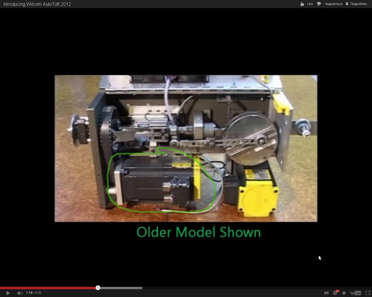

This motor is used only for rotate along A axis???
Снимок-5.png (21275 просмотров) <a class='original' href='./download/file.php?id=10649&mode=view' target=_blank>Загрузить оригинал (492.05 КБ)</a>

I haven't made too much effort to reverse engineer the videos but I will try to in the future. One thing to keep in mind is that the needle mechanism that I am using is a little different and simpler than theirs. They actually have some knife cutting and yarn blowing mechanisms to to handle multiple yarns at once and to produce a cut pile vs a loop pile. There are probably three motors in the head. The big motor probably controls the large wheel with the connecting arm that pushes the needle parts. The other motor you see probably is for the vertical movement of the head along which ever axis it is, either X or Y. There is probably a third motor hidden for the rotation of the needle about the A axis.
