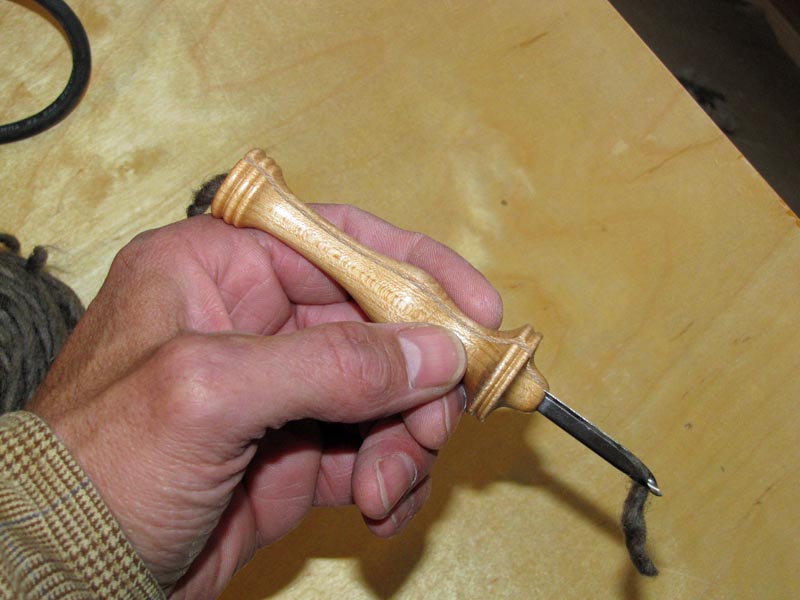

Yes the carpet is made by me. The tool is a punch needle referred to as an "Oxford Punch". No machine yet. You work on linen fabric stretched tightly on a frame. From the backside you push the needle in until it stops, about 40 mm, pull it out and repeat. It works out to about 8 to 10 stitches per inch and 5 or 6 rows per inch the other way.
I am not familiar with regular expressions but the internet can reveal all. Should I be referencing python or some other language?
Thanks for your interest and help, Badger
