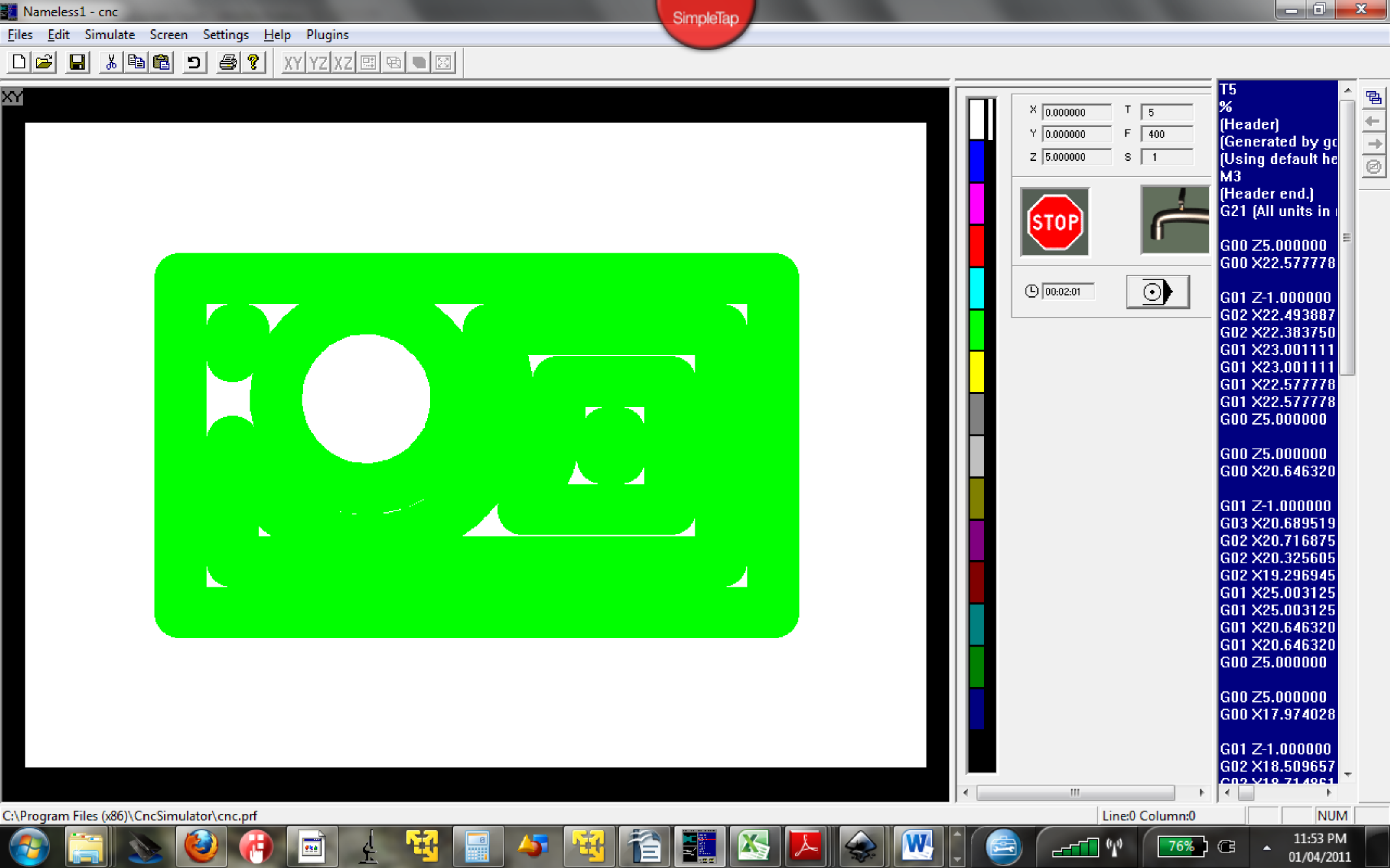

So far, so good. But, when I run the paths through a visualizer (in my case cncSimulator), I notice that the paths leave some chunks of material untouched that should be milled out - especially in corners where the linear outlines inset from the outer border meet the curved lines inset from the circular interior hole
Simulated.png (19005 просмотров) <a class='original' href='./download/file.php?id=1327&mode=view' target=_blank>Загрузить оригинал (273.88 КБ)</a>
Code is used as it comes out of the extension, but I add "T5" as the first line to specify a 2 mm diameter cutter from my library. Visual examination of the last block of Gcode (which makes the outermost cut) shows it is correct to within rounding error for a 2 mm cutter. If I set width to 2 mm under Stroke Style in Inkscape, I see the same gaps, so this is not an artefact of the cncSimulator but a problem with the actual gcoded paths.
It looks to me like what is happening is that there are places where the logic cannot mill out the material without part of the cutter intruding into an area that has already been milled, and so it does not do this. Possibly this is a result of re-using the code that decides where the first boundary is to select subsequent milling paths? (e.g. the initial boundary path must not cut outside the desired area, but subsequent paths can exceed their target area and overlap with previous cuts, as long as they don't go outside the original boundary). Is there a way around this behaviour?

Yes there are some things about that.
First of all if you want to see what will be actually cut you can do it straight from Inkscape. Select all the path's that are forming the trajectory, open fill and stroke dialog (Ctrl+Shift+F), go to the third tab, and set up stroke width equal to your mill's bit width and set up the corners and ending to "round". So thus you'll what will be actually machined.
How to avoid those uncut places
There are some improvements have been made in the Gcodetools-dev version. An overlap parameter has been added to standard Area function. Which defines cutting trajectory overlapping. It is useful to reduce amount of material that is cutting in same time (so you can use weaker routers) and helps to get rid of places.
Then a new function has been involved it fills the path with spiral or zig-zag. There wont be any uncut places and it works without "area artifacts" which are suddenly appear when using path-offset to create area curves.
I highly recommend you to try the dev version.
