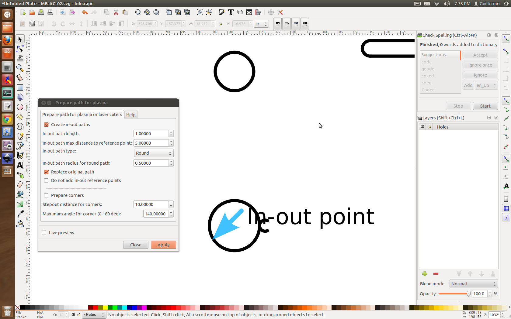

My question is, I have many circles and wish to:
1) <b>select cut from inside</b> <-- Most important right now
2) disable sometimes the OUT option. Only "IN".
3) offset (wished by many)
Some circles accept cut from inside after tring many minutes moving the INOUTORIENTATIONARROW. How ever today finally get stuck because cant choose from inside no matter where i put the arrow.
What can I do ?
Thanks in advance people!

Re: In-out Orientation points
Hi Nick,

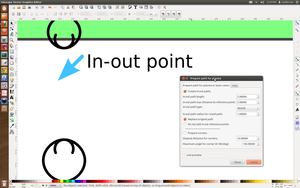

Hope you can help me with this drawing that need to cut, (but for unknow reason for me) it is making the inout outside and cant find the way to choose from inside.
I have tried flipping and scale the arrow, and few other things but nothing seems to work for me.
Thanks a lot lot lot lot !

In/out paths are always added from the right of the path if you look towards on the path. To check paths direction you can adjust stroke marker (at the stroke settings Ctrl+Shift+F) and add End Arrow to the middle marker.
To change paths direction (in/out path orientation) just reverse the path by Path-Reverse menu.
Usually if you combine the paths all internal paths become left orientated and outside paths - right oriented, so the in/out paths should be at the right side, but it can be not always like that. Any way you can break paths apart and manually orient them/

Wow. It was very easy step. Im feeling ashamed.
Just need to click on the circle path and choose "Reverse path", and apply "prepare for plasma" again.
