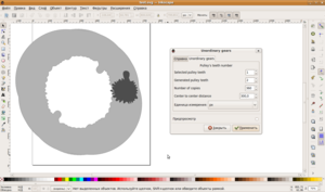

We've made a new extension for creating unordinary gears such those are in the video:
https://www.youtube.com/watch?v=WYcqJ5HdxA4
Usage
1. Draw the first arbitrary gear.
2. Open Extensions -> Render -> Unordinary gears
3. Fill in teeth number for first and second gear. (This numbers are relative to each other, so instead of 14:28 you can enter 1:2.)
4. Enter number of copies. The bigger this number the smoother will be the gear. For the preview 50 copies will be enough, for the final render it could be about 360.
5. Enter the distance between the centers of the gears.
Press apply :)
So you should get something like this:
cnc unordinary gears.png (26646 просмотров) <a class='original' href='./download/file.php?id=1085&mode=view' target=_blank>Загрузить оригинал (588.34 КБ)</a>
Then enter into created group (double click on it), select all paths Ctrl+A and make boolean add Ctrl+Shift+"+":
cnc unordinary gears creation.png (26646 просмотров) <a class='original' href='./download/file.php?id=1086&mode=view' target=_blank>Загрузить оригинал (160.06 КБ)</a>
Now break path apart Ctrl+Shift+K and delete everything except the inner path:
cnc unordinary gears extension.png (26646 просмотров) <a class='original' href='./download/file.php?id=1087&mode=view' target=_blank>Загрузить оригинал (152.11 КБ)</a>
Your extraordinary gear is ready :hehehe:!
You can make it a little smoother, go to node editing mode F2 select all nodes Ctrl+A and make all segments straight (a button at the node editing menu).

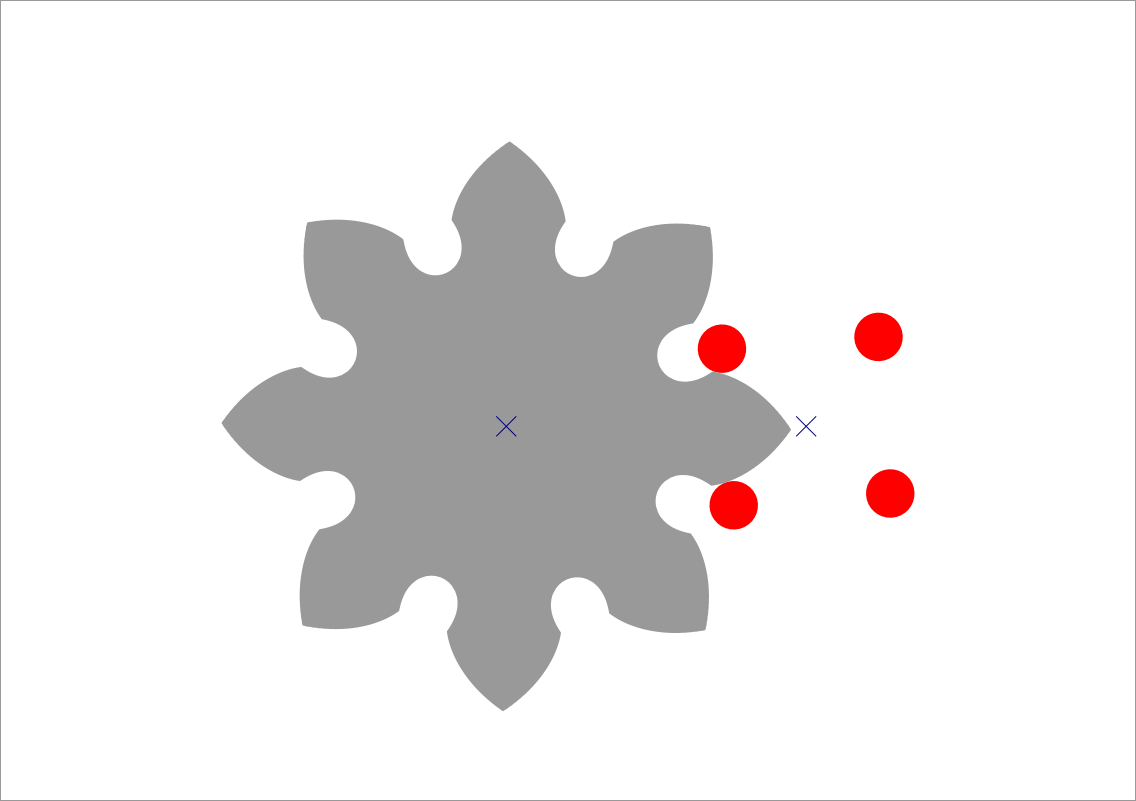

Re: Unordinary gears Inkscape's extension
You can easily create gear for "gear" made of several bearings. Just draw first gear that looks like several circles. And create unordinary gear for it.

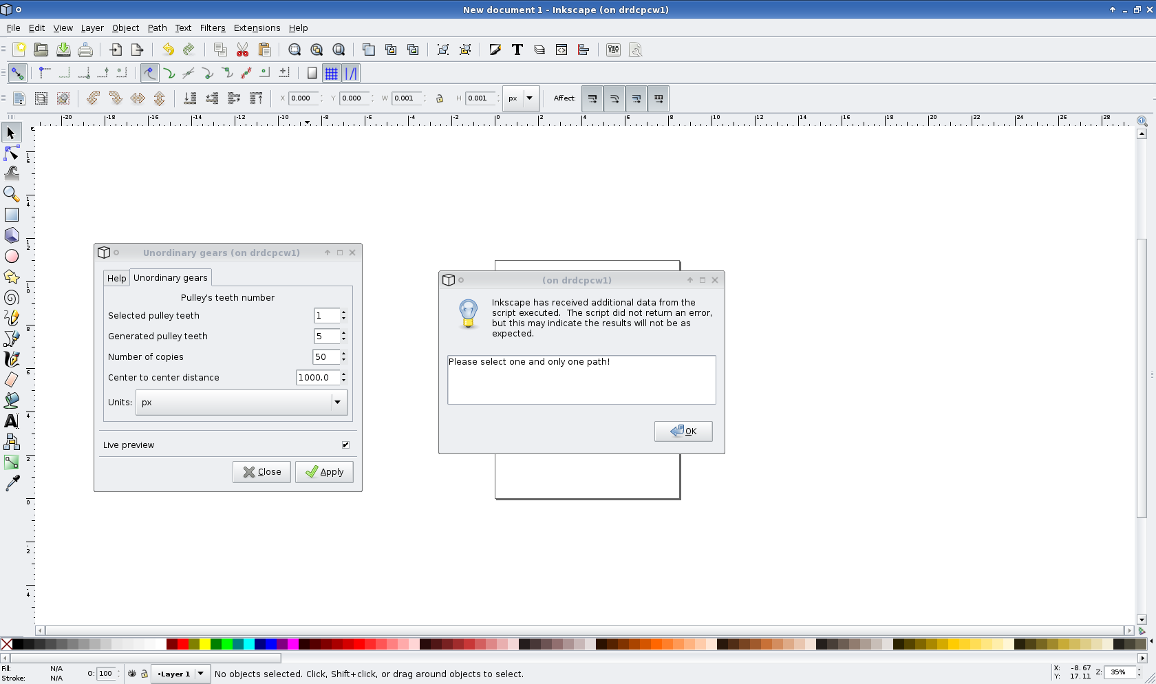

Just installed and check checked live preview
snapshot1.png (26627 просмотров) <a class='original' href='./download/file.php?id=1115&mode=view' target=_blank>Загрузить оригинал (133.16 КБ)</a>
You should do exactly what it says.
Select only one path :).
I've not tested that Preveiw thing, and added this option to make possible making changes to the drawing while extension's dialog is opened.
So better do not touch it :). Just create arbitrary path that will be used as a first gear, select it and make corresponding gear for your path.
