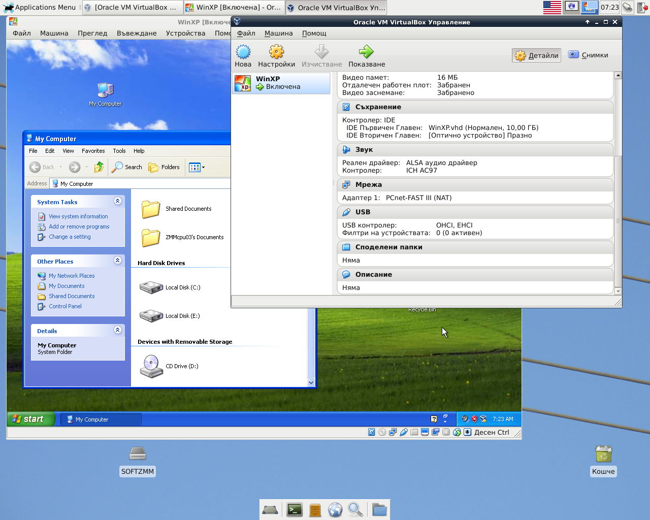

потом и VirtualBox 5.0.14 Oracle VM VirtualBox Extension Pack
vbox.png (12908 просмотров) <a class='original' href='./download/file.php?id=69998&sid=d9679c5ee4df947ac8bf0b21f058ea92&mode=view' target=_blank>Загрузить оригинал (636.26 КБ)</a>
опятWindowsXP не видит USB ,черт побери ,где копат ,надо USB ,хоть неуверен видит ли
ключ за програма dongle , хочу проверит

:ura: наконец то успел ,после длинное гуглене вот что нашел и оно помогло
полагаю здес ,надеюс поможет другим :D
    Close virtualbox
    Execute in bash (for Debians): sudo adduser YOURUSERNAME vboxusers. If you don't have a Debian-like distro, read here.
    Log out and log in again
    Attach to your PC the USB devices you want to be automatically mounted in the VM (virtual machine).
    Open Virtualbox
    Select your VM and go to "Machine" -> "Settings" -> "USB".
    Check "Enable USB Controller"; click on the icon with the USB plug and the plus, and click on the devices you want to be automatically mounted in the VM. Click "Ok".
    Click on "Start" toolbar button, and ensure your USB devices are recognized and mounted by the VM. Remember that you have to unmount them in the host OS too if you have to disconnect them after you exit the VM.
Note that Extensions Pack and Guest Additions are not strictly required, but with Extension Pack you can use USB 2.0.
You have also to enable it under USB settings. Without it all your USB devices are controlled as
USB 1.0, so they will work at lower speed.
