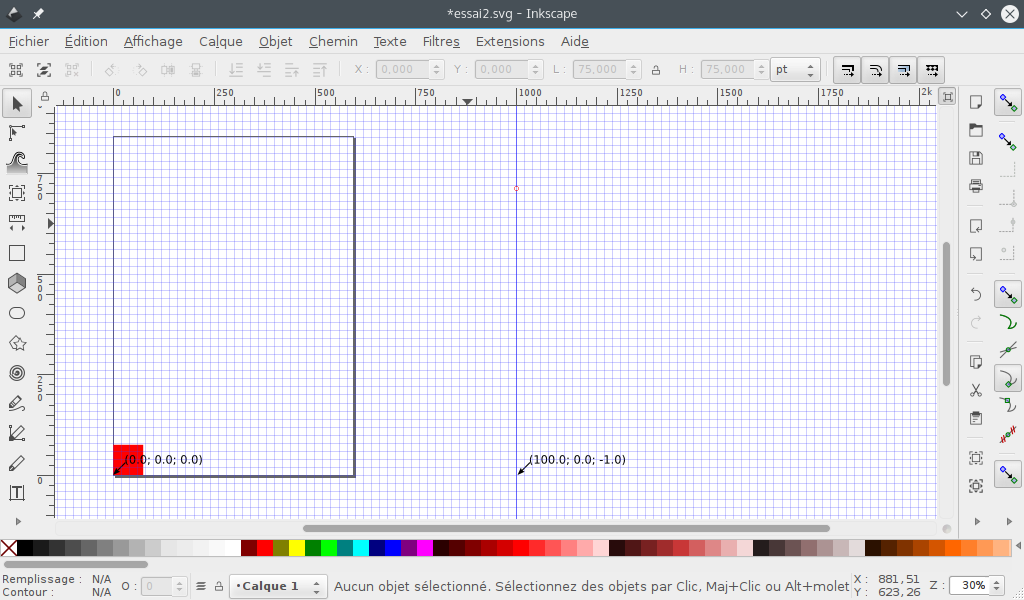

Hi Nick and others
I've a little problem understanding witch internal units are used by gcodetools. I thought they where pixels (px) as pixels seems to be native inkscape internal units, according to units.xml I found in /usr/share/incskape witch states px factor is 1.00000
Also I have read somewhere in this thread the best practice to use gcode tools is to draw things using px unit and assuming 1mm=1px.
Anyway, when I set inkscape to use px as display unit, and create a new document (A4 sheet), and I then run "orientation points", this is what I get :
unit_px.png (21711 просмотров) <a class='original' href='./download/file.php?id=67748&mode=view' target=_blank>Загрузить оригинал (57.29 КБ)</a>
The red square at the bottom is 100x100px. As you can see, the orientation points are quite... BIG, a lot bigger than the document itself. And the point along X axis where the point (100.0,0.0) is does not look to be placed according to some logical value. X=1333px exactly.
Now I change the display value to "pt". Now this is what it looks like :
unit_pt.png (21711 просмотров) <a class='original' href='./download/file.php?id=67749&mode=view' target=_blank>Загрузить оригинал (58.4 КБ)</a>
Now you can see the point (100.0,0.0) is corresponding exactly to 1000pt. Looking at the units.xml I see scale factor for pt is 1.33333333 so now the previous X px value for the point makes sense.
But what does not makes sens to me is : Why the plugins seems to use pt (*10) as internal units instead of px ? and why is the output such big that is does not fit in the document size ? The same thing happens with "tool library" the created tool description is bigger than the document.
I used gcodetools in the past and I had not such problems.
I use inkscape 0.91 and gcodetools 1.7 (provided with inkscape)

Re: Inkscape Gcodetools plug-in English support forum
bricofoy писал(а):Also I have read somewhere in this thread the best practice to use gcode tools is to draw things using px unit and assuming 1mm=1px.
IMHO the best practice is to draw everything 1:1, i.e. in mm or inches.
If you want to draw in px you have to modify orientation points - move right arrow to 100px or define it's coordinates using text tool.

Hi Nick, thanks for your answer
I also tried to do anything in mm, but I encounter the same problem with orientation point or anything else generated by gcodetools like tool library being larger then the document itself. And more problematic, orientation points placed without anything corresponding to the unit being used, like i illustrated with my two screenshots.
Of course i can move the right arrow or change the coordinate, but I think it should be placed by default at the corresponding X=100 in the selected unit, right ?
I noticed if I open (on my computer) an SVG file created in another computer with different inkscape version, I have not the problem, and gcodetools work as expected, tool library in a correct size, and right orientation point placed at X=100.
So I wonder what in my configuration can cause this. Tried almost all units, same result.

Hi Nick,
Congrats, your crazy extension is working very well even in FRANCE! you created something which has a worldwide impact and which help a lot of people like me, congrats !!!
My question is probably stupid, but i've no clue on how to deal with. I use your extension for plasma, tu cut small rectangles. But i don't how to remove a very long path from 0X0Y to the 1st rectangle to cut...i've tried to modify all the options but nothing to do...the 1st rectangle (and the last ) to be cut is always very far from the starting point 0X0Y.
Many thanks in advance for your help.
Best regards
Sébastien
Capture.PNG (20289 просмотров) <a class='original' href='./download/file.php?id=76705&mode=view' target=_blank>Загрузить оригинал (17.12 КБ)</a>
output3_0050.ngc
(86.92 КБ) 1681 скачивание

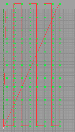

Hi! firstly very new to all of this, made a small CNC plotter from a few DVD roms, Arduino, EasyStepper and Grbl Controller. All seems to be working fine, tested with some example gcode plots.
What I'm finding its any gcode / ngc from Inkscape using this plugin goes outside of the defined area. As you can see by the attached picture, and the red dot in the top right. It starts fine then doesn't stop until it reaches close to 100mm in one direction or another, but ins't following a path in the process? or at least starts and then forgets to the turn the corner before its off over the horizon.
Followed tutorials, guides etc, and a fair few attempts and nothing has made a difference.
Any suggestions! Thanks
error.jpg (19378 просмотров) <a class='original' href='./download/file.php?id=81516&mode=view' target=_blank>Загрузить оригинал (249.47 КБ)</a>
