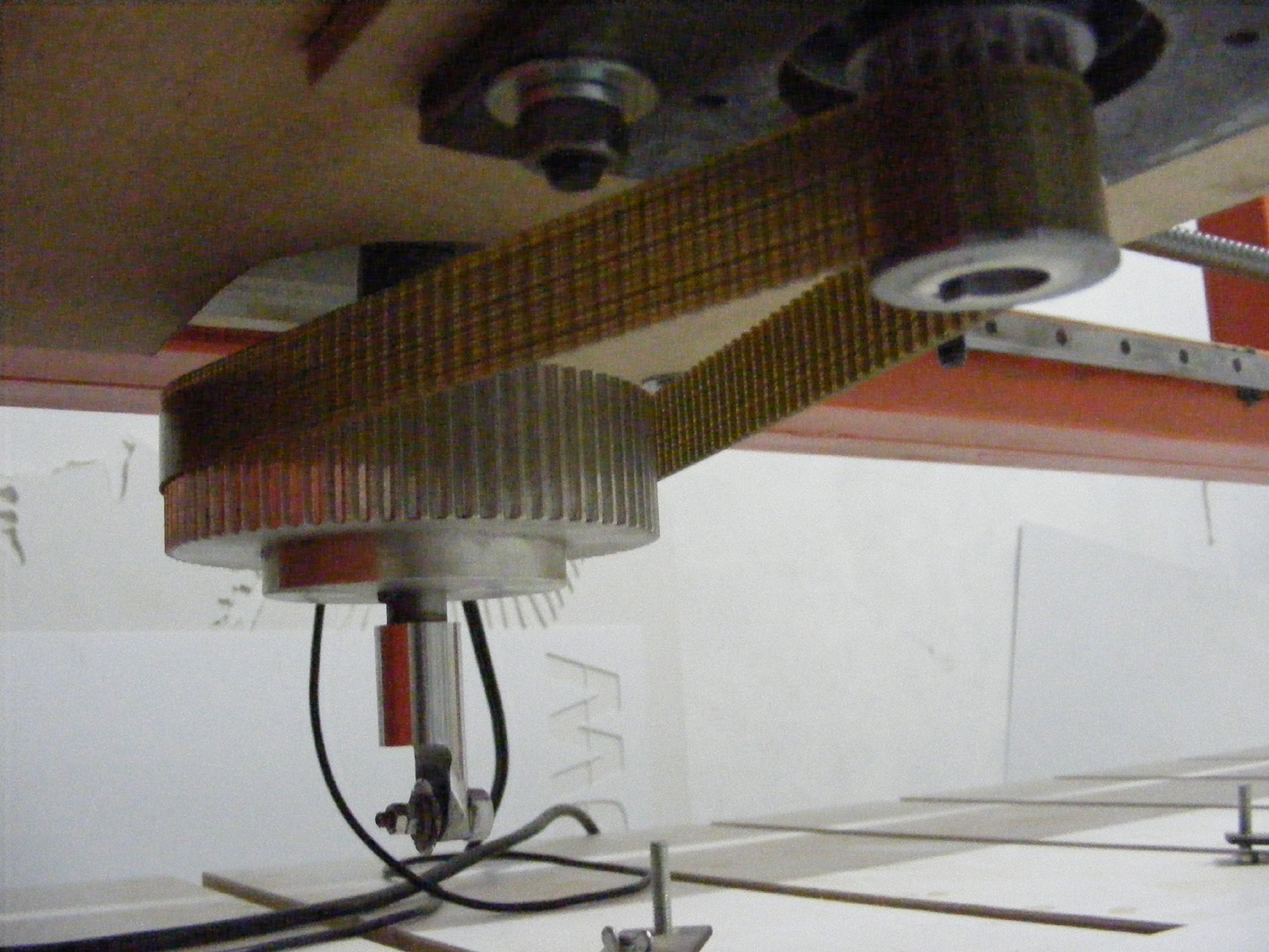

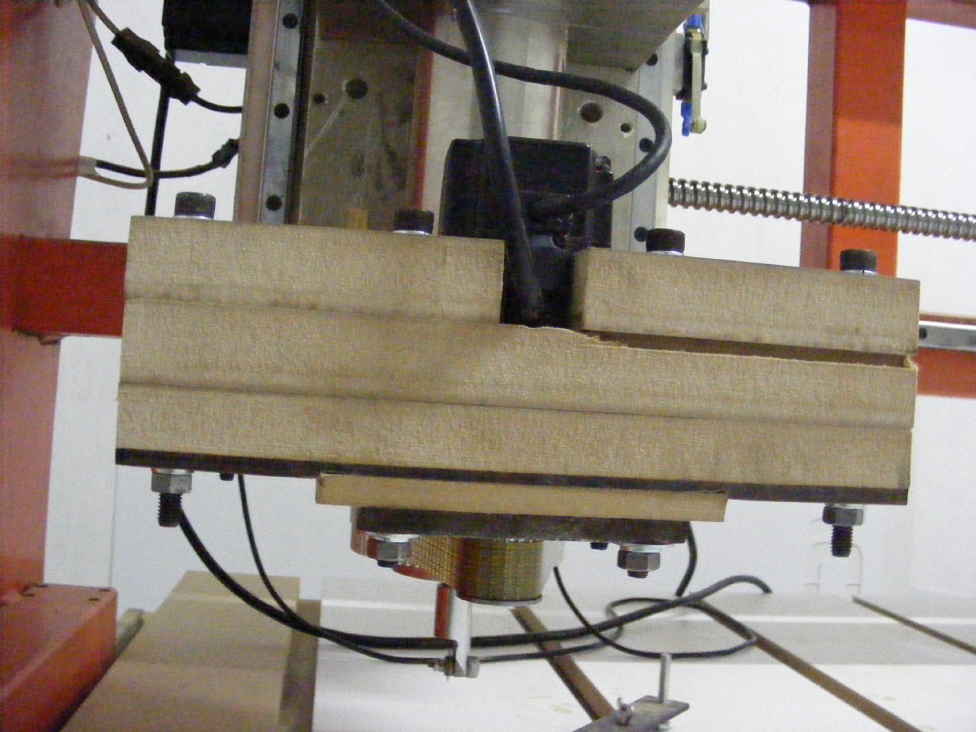

4th axis support is a hack! :-) (8128 просмотров) <a class='original' href='./download/file.php?id=5128&mode=view' target=_blank>Загрузить оригинал (452.63 КБ)</a>
Machine partial view (8128 просмотров) <a class='original' href='./download/file.php?id=5127&mode=view' target=_blank>Загрузить оригинал (421.92 КБ)</a>

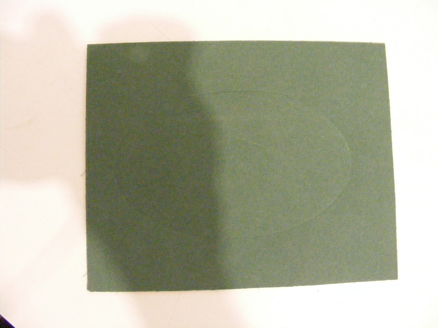

Test cut on EVA (8128 просмотров) <a class='original' href='./download/file.php?id=5131&mode=view' target=_blank>Загрузить оригинал (215.36 КБ)</a>
Test cut on EVA
Same cut, disassembled. (8128 просмотров) <a class='original' href='./download/file.php?id=5132&mode=view' target=_blank>Загрузить оригинал (399.77 КБ)</a>
Re: Inkscape Gcodetools plug-in English support forum
Dimitrios писал(а):4th axis support is a hack! :-)
Yeah, you just fixed knife in the spindle, don't you? :)

Сообщение Dimitrios »
Yes! We had several pieces of equipment laying around, so we recycled them. :hehehe:
i will make a small movie showing the cutting, this week.
