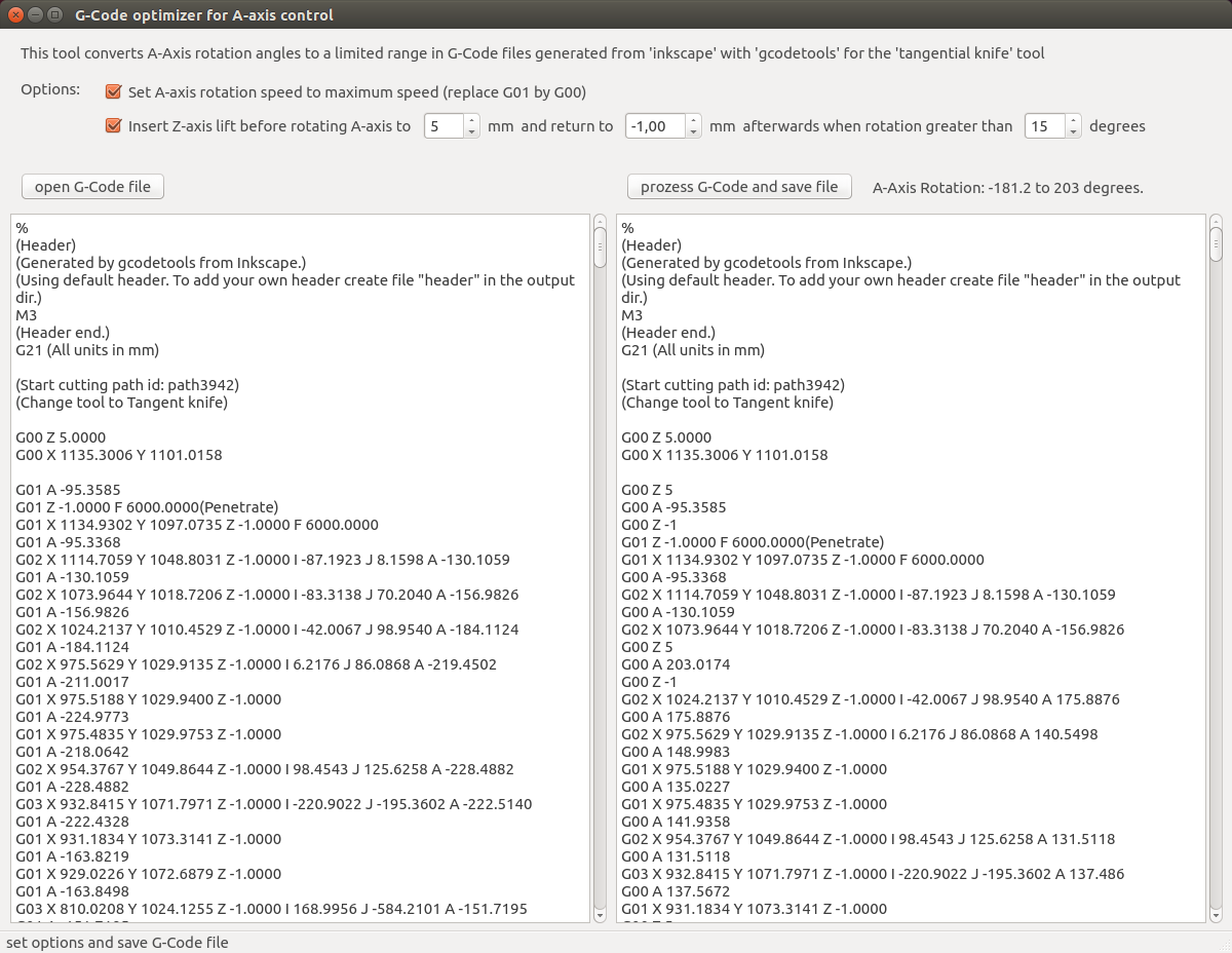

Re: Tangential knife: rotation limit of -360 to 360 degrees
Hi Nick,
thank you very much for your suggestions and ideas!
You are right incscape with gcodetools is very powerfull and flexible!
Meanwhile, I wrote a piece of software which postprocesses your generated G-Code from gcodetools to make it fit in -360 to 360.
I also replace G01 by G00 for A-axis rotation to speed up turning and insert Z-Axis lifts if the rotation is e.g. greater than 15 degrees in order to allow the use of a rotary cutter and to improve cutting results with the hot-knife.
Cutting results are perfect!
The tool was developped using Qt (C++). This was my first work with Qt.
As soon as I find out how to compile the tool to run without Qt I will post it.
until then please find attached the code and a screenshot.
Thank you very much again for writing gcodetools.
It became an very important tool in my tool-chain!
Best regards,
Felix
Wow! Cool!
By the way if you can make a cli (Command line interface) for your program it can be easier to use with LinuxCNC.
I.e. add parameters like --a-axis-g0 --insert-zlift and so on, and output Gcode to standard output - then it can be used as a FILTER.
Or just add standard output, and you will be able to use FILTER of LinuxCNC http://linuxcnc.org/docs/html/config/in ... ER-Section then you'll see your window.
