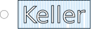

hi,
first to say, i'm using inkscape 0.48 and gcodetools 1.7
I tried to make some small nameplates where the area around the letters is milled away.
I started writing the text and drawing a surrounding box. after, I turned both into paths(CTRL-Shift-C) and combined them (CTRL-K)
After, i choosed gcodetools -> area.
After filling the area, some pieces are filled that must not be and others, who'd have to, aren't.
have a look at the pic i attached and you'll see what i mean.
Is this a software defect or rather human misbehaviour? ;)
area defect.png (21889 просмотров) <a class='original' href='./download/file.php?id=34818&mode=view' target=_blank>Загрузить оригинал (26.97 КБ)</a>

I this it will be better if you will add text, convert to path, ungrounp text and combine it (ctrl + k) and then select text and surrounding box and press ctrl + - (path -> difference. i think its called). After this adding "area" should not make problems.

okay.. looks bit better but still some error..
area defect 2.png (21879 просмотров) <a class='original' href='./download/file.php?id=34819&mode=view' target=_blank>Загрузить оригинал (21.53 КБ)</a>

Can you post your svg file?
What option to you use to fill area?

uff.. i think, i changed nothing to the standard settings but area tool overlap to 0.1..
keller.svg

File made by me in attachement.
I had to create new file, in yours something was not working good.
keller-fixed.svg

well, this did it. thanks.
