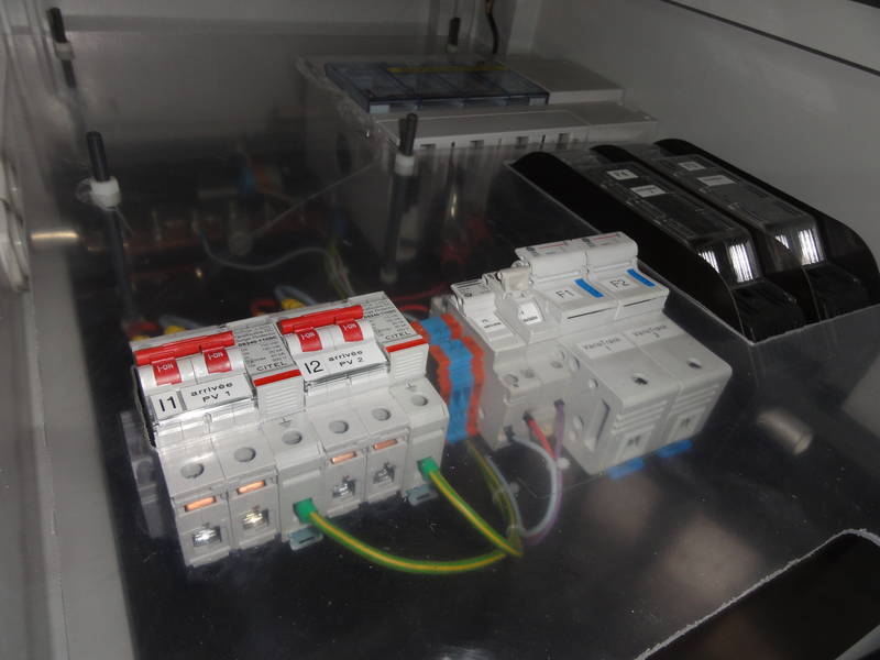

I use it by adding it manually to the gcode file. The fact is you need to choose between G41 and G42 depending on the design of your work. If you want to have a look at the attached files, I used it to cut some protective panel for electrical box. You will see here I needed to use only G42. But in some cases you will need both.
What I do to make sure the resulting path is ok is to run the file one time without adding G41/42 in a linuxcnc simulation install, and then I make the changes and I re-run the file without cleaning axis display, so I get the two pathes displayed : the original one wich in fact is the part outline, and the tool conpensated one, so I can check if I use the right command : if the new path is on the wrong side of the part outline, then I need to change between G41 and 42.
