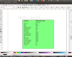

BUT where do i define my tool? Think I need at least a diameter?
can't see the videos now but i'll try this evening..
Re: actual howto?
tecdroid писал(а):where do i define my tool? Think I need at least a diameter?
After you apply Path To Gcode, a default tool will be added you can copy/modify it afterwards.
In fact diameter does not interfere Path to gcode it's only needed for pocketing operations...

Nick писал(а):After you apply Path To Gcode, a default tool will be added you can copy/modify it afterwards.
where and how do i ?
Re: actual howto?
If you will do what I have written, you will get something like this:
You can Edit parameters using Text tool (F8).
Снимок-38.png (19229 просмотров) <a class='original' href='./download/file.php?id=29797&mode=view' target=_blank>Загрузить оригинал (197.8 КБ)</a>
