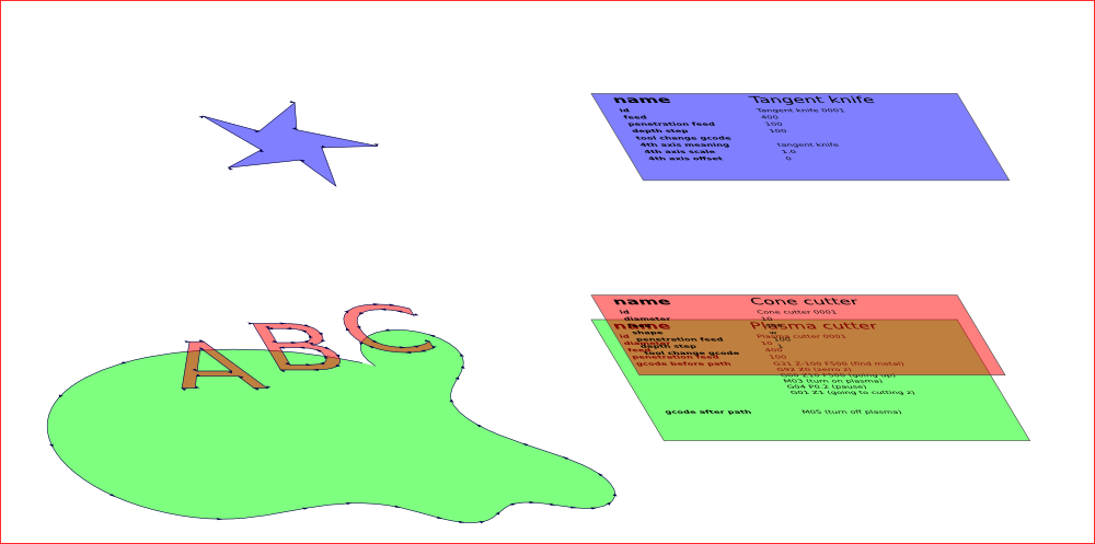

As for the order of cutting. Gcodetools orders the paths to reduce the time to go from one path to another. To make sure that one paths will be cut before others just put them to the other layer. Cutting is done from topmost layer to bottommost.
You can check the order of cutting by Gcodetools -> Tools Library -> Select Just check tools and press Apply.
In the development version you can choose between cutting path-by-path and pass-by-pass. Also theres option that disables path sorting.
Re: getting started
Using tools check you should get something like this:
gcode tools cutting order check.png (20019 просмотров) <a class='original' href='./download/file.php?id=1047&mode=view' target=_blank>Загрузить оригинал (64.62 КБ)</a>
