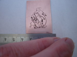

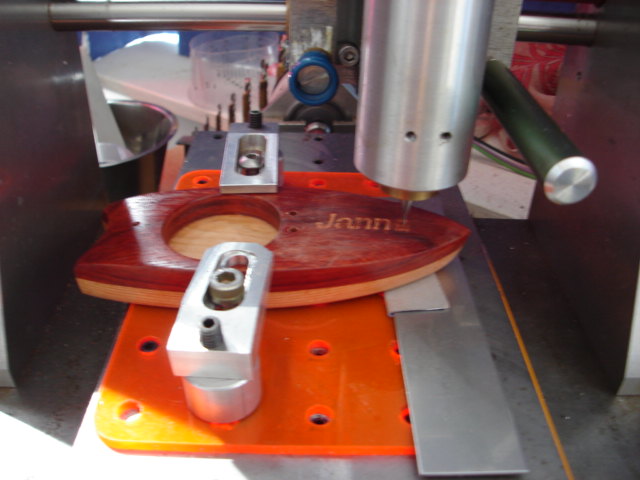

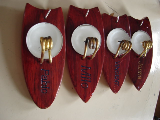

To answer to the request for photo's some engraving done with Gcodetools . Thank's for writing it!.
Rene

Hi Rene!
Thank you for the photos!
Could you attach the svg of the "Milo". I think there's an error in the engraving function.
And how have you done those picture at the first photo? It's just awesome! Is it done with the engraving function or not?

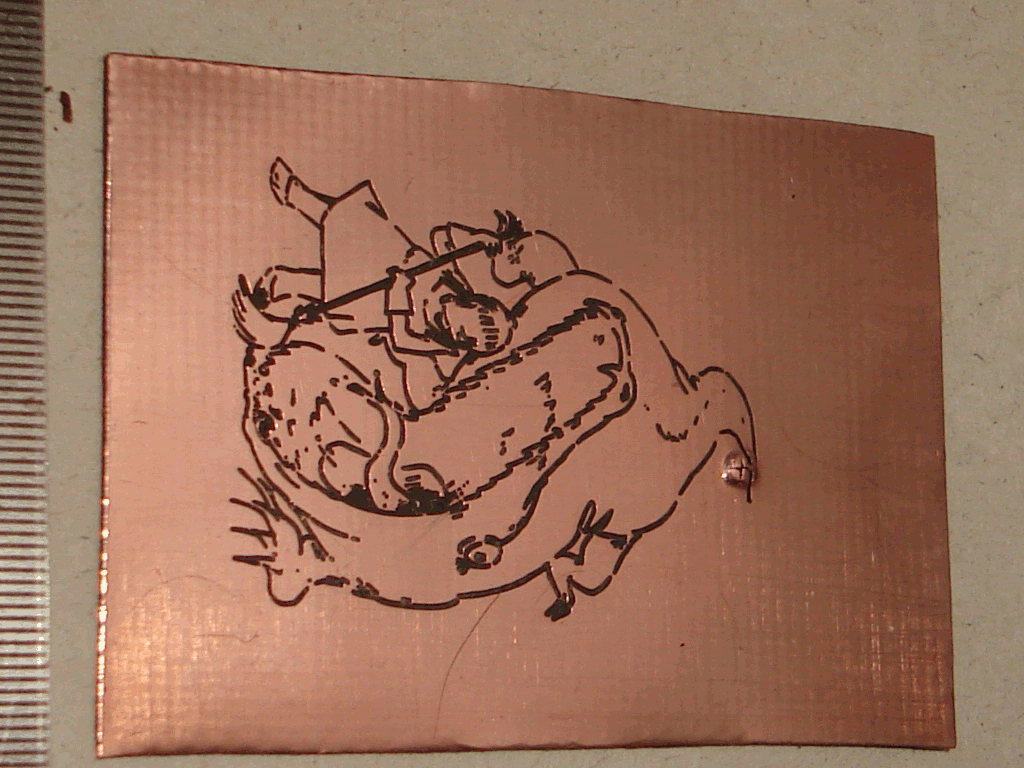

Yes nice work !
Could you set better resolution photos...to be able to see the detail of the engraving.. ;)
If you can do some tutorial on how you operate if it have more than say's in the forum...nice too..
Thank's for feedback ! and have a nice day.

>alfcnc,requested bigger photo, it already has some dents and scratches from being in the bottom of a toolbox for a while so i gave it a quick polish. It was actually the first test i did with gcodetools i think a year ago or so and i dont have the slightest idea how i did it (sorry) The design is by a friend of mine who is in to comics and drawing http://www.sadrabbits.com.
>root, the milo.svg the original output and the edited to run (ad a speed S1 else spindle wil not run and changed feed and depth til now im stil a bit lazy in exactly figuring out how to use gcodetools tool well :)
I looking forward to test the new version (if i find some time)
regards Rene

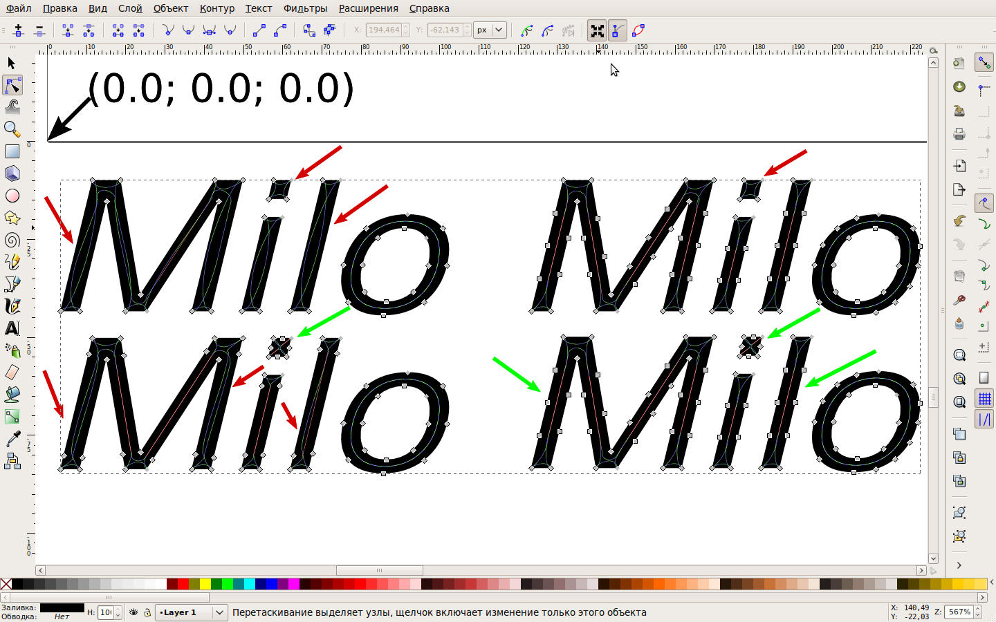

Hi Rene!
Unfortunately there's no automatic subdivision inside engraving function. But yo can get better results if you'll do the subdivision yourself.
See the attached image. I've marked bad places with red arrows and good ones with green. You can notice that the more knots you add the better result you'll get. But the calculation time depends at n^2 where n is knots number. So if you increase knots number in two times calculation time will be 4 times longer.
Also it's better to do Path->Break Appart for isolated paths. So they will be calculated separately and calculation time will be m^2+n^2 instead (m+n)^2= m^2 + n^2 + 2*m*n so you'll have 2*m*n calculation time benefit (n,m knots number of separate paths).
Of course all this make sense only for large paths. But keep that in mind ;).
To add more nodes use Extensions->Modify path->Add nodes. You can choose from two Division methods either by seg. length or by segment number.

Ah,that is how to solve it ! I'l keep that in mind the next time. I noticed that strange behaviour, but as the result was fine by me i dint look further.
