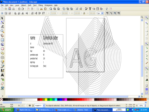

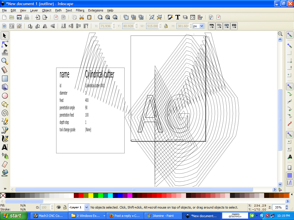

Hi
I am trying to create G-Code where it will fill in the text for me as well, and not just the outline.
I followed this youtube clip: https://www.youtube.com/watch?v=AxUF9T53zSA
However, after I click Apply to the 'Area' screen, I don't get the same as in the video. Instead I get this (see attached image).
What am I doing wrong???
CNC AREA error.PNG (16581 просмотр) <a class='original' href='./download/file.php?id=52211&sid=4747d7c1e56f594fa221782a65324077&mode=view' target=_blank>Загрузить оригинал (236.1 КБ)</a>
Area Fill Error.svg
Here is the SVG file if you need to test
(96.62 КБ) 1279 скачиваний
Re: Inkscape Gcodetools plug-in English support forum
Gcodetools uses Inkscape's internal offset, which sometimes sux...
You can try to limit offset ammount, and reduse offset step... And correct manually any bugs later.

Can you show me how to do that? Limit the offset amount and reduce the offset step?
I think I have done it for shapes but not for text?
