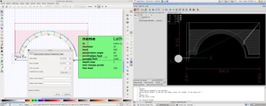

Just for illustrate and show you the errors... of no subdivide of end cutting depth and why i have a vertical line to the left of end of drawing...
because gcodetools go wrong in depht at the start or end of cutting depending the direction...
See on picture...and in gcode file were Y go to negative value....

There was a bug... while doing fine cutting penetration g00 was path.y - fine_cutting_width instead of path.y + fine_cutting_width.
I'll correct this in some minutes...

Revision 139
I've add a parameter "Create fine cut using" and two options:
"Move path" just moves original path up. And so creates a number of fine cuts. Gives worse results than offset but there should not be bugs.
"Offsets" offsets original path up. And so creates a number of fine cuts. Gives the best result but could be bugs due to offsets bugs. You can always try it first and in case of bugs try to add some knots to the path near the problem places or just use the first option.
I've changed the inx file so you'll have to run python create_inx.py before using separate lathe window.

Ok ! That's come great... but little error with offset...
The fine cuting path goes out on the left...
And on the right start at curious position for some of them....
finishing_offset_error.png (12629 просмотров) <a class='original' href='./download/file.php?id=598&mode=view' target=_blank>Загрузить оригинал (292.71 КБ)</a>
svg file with trajectory and setting...
boule1.svg
(368.04 КБ) 1544 скачивания
if setting 1mm fine cut and 5 count the right is good... but left alwas go out...
more_thin_finishing_pass_error_on_left.png (12628 просмотров) <a class='original' href='./download/file.php?id=600&mode=view' target=_blank>Загрузить оригинал (251.4 КБ)</a>
Hum Curious ! I see now with different setting all is ok... curious..perhaps this can help you to find
were is the bug..

Revision 142
I've found the bug. While calculating line and Bezier curve intersection we have to solve cubic equation and take only real roots that are 0<=root<=1. But due to calculation tolerances root becomes 1.000000001 which was ignored. Now we take roots that's abs(root.imag)<1e-7 = 0.0000001 and -0.0000000001<=root.real<=1.0000000001.
Thanks for the bug report :D!

Ok ! process, processing...
The svg file is the same than post just previous this post... Boule1.svg...
were I have just change the direction of cutting path from "right to left" to
" left to right" with revert path... you'll have the bug with about all the value
you can set for fine cut.... very easy to reproduce...
