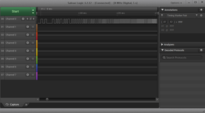

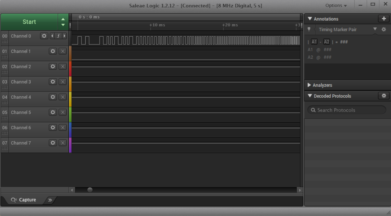

It seems that the step is not smooth when testing the ARISC driver acceleration and deceleration

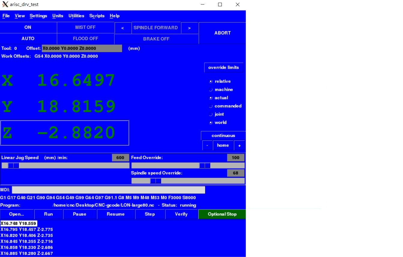

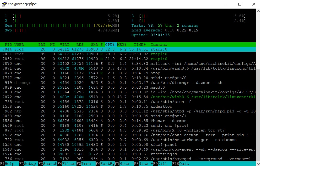

Thank you for your efforts, the ARISC driver has a good start. I believe that after some time optimization, LinuxCNC + Orange Pi may be a great cnc controller
I use tkemc run 3.6 million lines of gcode, Linuxcnc + Orange pi cpu works very light
