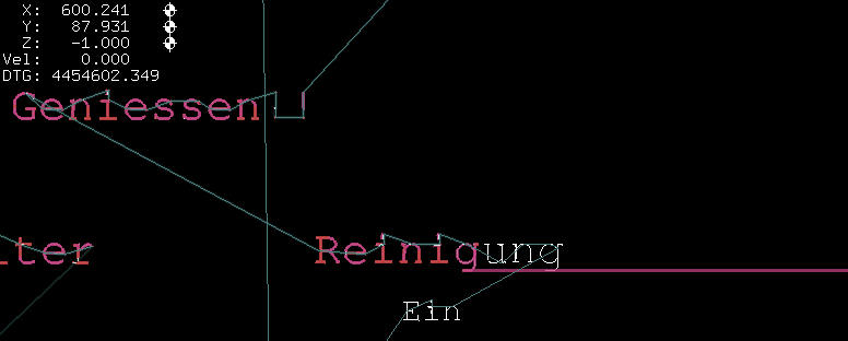

Dear all
I'm great fan of cnc-club and milled several projects so far. Yesterday I experienced a problem. The code seemed to be finde on EMC2 (Ubuntu 10.04). But when milling, it follows on a huge radius, when I understand the G-code, see picture and see what I mean. (I tried two fonts, Comics Sans / Tlwg Typist)
I tried several settings, even with Windows and on a Linux Computer with inkscape 0.48 and the stable Gcodeplugin 1.6 as well as the newest dev. revision from 17.01.2011.
I'm sure, I do not understand some parametric settings. But I have no idea where to adjust.
I'm really happy to every answer and hint where I need to fix that.

Re: Inkscape Gcodetools plug-in English support forum
Thanks for the report could you attach you svg file?
I'll try to find out what's wrong.
PS I've heard about same situation while using Engraving function... :think:
Сообщение Bartelime »
Wow, ultra fast reply!
Thanks and find the file attached above!
I've made a test of the "Reinigung" word and it was fine, probably it's because of different parameters...
