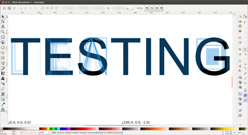

Сообщение Nyx_ »
Hi.
First of all I'd like to congratulate everyone that helped creating this amazing piece of software. You're special! Thanks for the hard work!
I'm facing a strange behavior on certain situations when using the area tool. Although I tried many different options, I'm not able to identify or solve the problem.
Here's my step by step to reproduce it.
1 - Installed Gcodetools 1.7 from the .tar.gz download and copied the files to /usr/share/inkscape/extensions directory.
2 – Launched Inkscape and created Orientation Points (Extensions → Gcodetools → Orientation Points → 2-Points mode)
3 – Created a Default Tool (Extensions → Gcodetools → Tools Library → Default)
4 – Changed Default Tool Diameter from 10.0 to 0.25
5 – Inserted a Inkscape Text Object (F8)
6 – Converted Text Object to Path (Path → Object to Path)
7 – Generated a Fill Area (Extensions → Gcodetools → Area → Fill Area)
The generated Fill Area is not correct and it doesn't not follow the path shape, see the images below.
I wondering what I can do to solve the solve this problem.
My current setup is:
Ubuntu 13.04 32bit
Inkscape 0.48.4
Gcodetools 1.7
Thanks for helping.
15nogmx.png (6638 просмотров) <a class='original' href='./download/file.php?id=25218&mode=view' target=_blank>Загрузить оригинал (93.72 КБ)</a>
69htew.png (6638 просмотров) <a class='original' href='./download/file.php?id=25219&mode=view' target=_blank>Загрузить оригинал (91.74 КБ)</a>
adhqx2.png (6638 просмотров) <a class='original' href='./download/file.php?id=25220&mode=view' target=_blank>Загрузить оригинал (73.74 КБ)</a>
ne81hv.png (6638 просмотров) <a class='original' href='./download/file.php?id=25221&mode=view' target=_blank>Загрузить оригинал (75.84 КБ)</a>
Re: Gcodetools - plug-in Inkscape для экспорта в Gcode
Can you attach your svg please?

Hi Nick. Thanks for the reply!
I'm on a different computer now. It uses Ubuntu 12.04 and Inkscape 0.48.3.1. The problem still showing on this setup.
The SVGs are attached. There's one just with the Text and other with the generated area fill.
Thanks
testing.svg
Text without Area Fill
(29.19 КБ) 816 скачиваний
testing_area_fill.svg
Text with Area Fill
(225.12 КБ) 924 скачивания
hmmm... it seem's like a kind of bug... thank you for the report, i'll test it later.

Hi Nick. Thanks for taking a look at it. I really appreciate your effort.
I generated another Test File with several texts, although some letters are generated correctly, there's no single word that are completed clean.
I also noticed that, certain times, even If I choose ZigZag as the Fill Pattern, it come out as a Spiral.
Resulting Filling Pattern when selected &quot;ZigZag&quot; (6597 просмотров) <a class='original' href='./download/file.php?id=25267&mode=view' target=_blank>Загрузить оригинал (24.11 КБ)</a>
Resulting Filling Pattern when selected "ZigZag"
Let me know if I can help you with anything else.
Thanks a lot.

[4]
[5](path id: path4062 at depth step: -2.0)
[6](path len: 37.57385)
[7]G00 Z5.000000
[8]G00 X5.980064 Y0.000000
[9](Subpath start)
gcodetools-eliminator.rar
(2.99 КБ) 648 скачиваний
Последний раз редактировалось dormouse 06 мар 2014, 16:15, всего редактировалось 1 раз.
О, эт интересно :).
А что будет, если контур не замкнутый?
