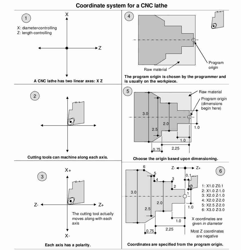

Re: Gcode tools - lathe extension develop
Добавлено: 10 апр 2010, 17:13
alfcnc
Hi ! after some search I found this doc.
Resume some parameters of coordinate system and the tool working face of cnc lathe.
coordinate_system_of_lathe.jpg (28834 просмотра) <a class='original' href='./download/file.php?id=488&sid=42bf13d3e6484293ea2a9efbdf0f0a7f&mode=view' target=_blank>Загрузить оригинал (36.16 КБ)</a>
Добавлено: 12 апр 2010, 09:11
alfcnc писал(а):Hi ! after some search I found this doc.
We'll have to use G18 code to be able to use G02 and G03 codes.

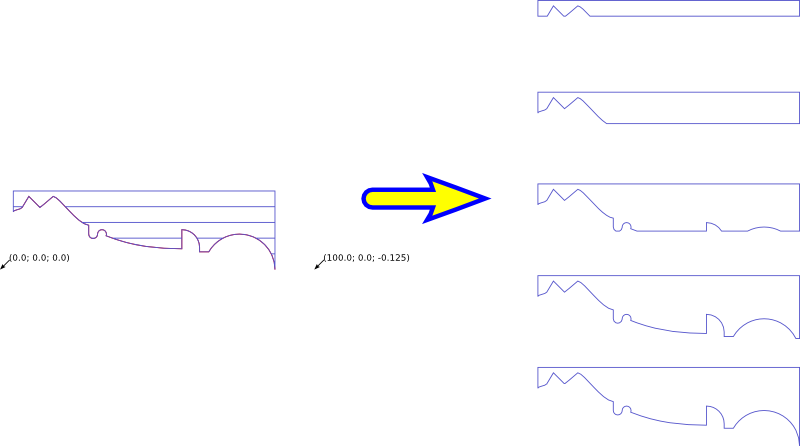

Добавлено: 30 июн 2010, 12:39
I'm sorry for the delay with lathe... I was really busy this time and spent all my free time to write offset function, which will be also needed in lathe to make final fine cut.
But here's some new results! :)
I've made a function which generates paths that could be exported to gcode later. Now I've stopped at gcode exporting. Here some problems:
1. We already have generate_gcode function, but it is focused on generate gcode for mills, not lathes. So I think we will need a new function to generate lathe gcode.
2. What parameters should we add?
3. What axes should we use?
Here are an illustration for the function I've made. How do you think, what must be improved in this function?
0045 gcode tools lathe.png (28565 просмотров) <a class='original' href='./download/file.php?id=543&sid=42bf13d3e6484293ea2a9efbdf0f0a7f&mode=view' target=_blank>Загрузить оригинал (20.28 КБ)</a>
Also there's some different types of subpath:
blue - the subpath have been already cut, go through it at maximum speed
red - cut at depth step (the final path will be cut next steps)
green - cut the path
0046 gcode tools lathe.png (28563 просмотра) <a class='original' href='./download/file.php?id=545&sid=42bf13d3e6484293ea2a9efbdf0f0a7f&mode=view' target=_blank>Загрузить оригинал (25.99 КБ)</a>
Добавлено: 07 июл 2010, 18:42
alfcnc
Hi ! root !
Very nice !
I think to others improvement just for final tool path !
But all it is very good for me.
For final path just be able to set the speed of it and the number
of fine final cutting path...
so I see parameters...
Feed of roughing cut or speed cut...
Depth pass of roughing cut.
Feed of end cut.
Depth pass of ending cut.
I want say that's very nice to be able to have a parameters for reapeat n times
the end cut.. often I do 2 too 3 time the end cut to have a very good surface finishing...
and a paramater to subdivide the end depth cutting path.
