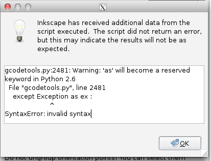

Screen Shot 2014-05-31 at 4.36.39 PM.png (9117 просмотров) <a class='original' href='./download/file.php?id=28888&mode=view' target=_blank>Загрузить оригинал (31.59 КБ)</a>
I am using Gcodetool 1.7 on a Mac (10.7.5) with Inkscape 0.48.2. I was able to use the extension but now I get the following error when I attempt to Apply the Orientation Points:
gcodetools.py:2481: Warning: 'as' will become a reserved keyword in Python 2.6
  File "gcodetools.py", line 2481
    except Exception as ex :
SyntaxError: invalid syntax
Re: Inkscape Gcodetools plug-in English support forum
Добавлено: 02 июн 2014, 13:06
What python version is installed in your MacOS?
That strange because there seems no error in this line...

bborncr
When I type in python in the console: Python 2.7.1 is returned. It all worked a couple of weeks ago and nothing in the code has been changed. Probably when I installed some other apps something in the paths has been changed. If there is nothing obvious I'll focus on the python installation.
Thanks,

bborncr
Fixed! The Eggbot plug-in modifies the Inkscape script and forces python 2.5. I commented out the line and it all works fine.
