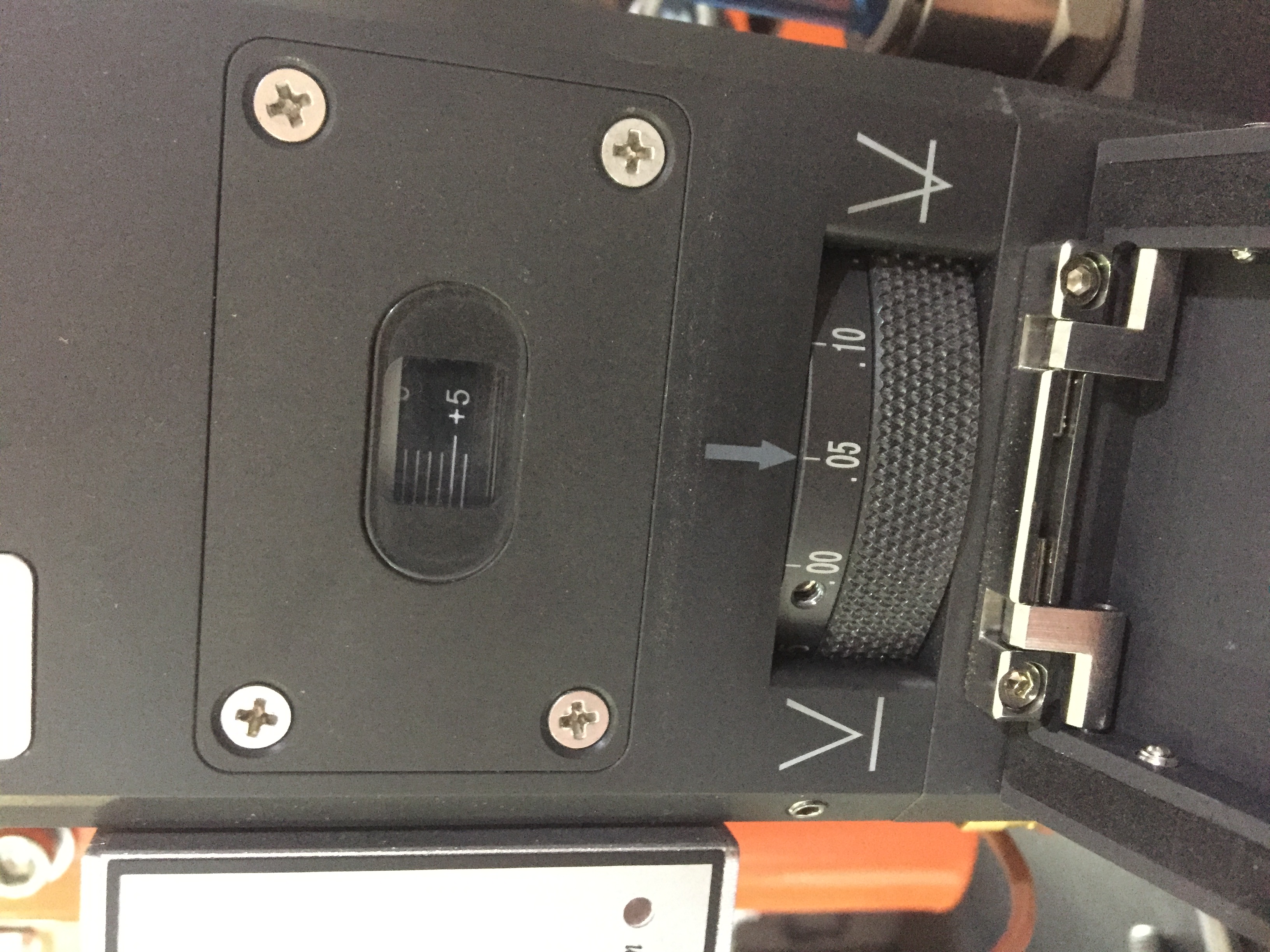

Парни, подскажите , где у головы BT240 риска для регулировки фокуса ?
IMG_5412.JPG (8231 просмотр) <a class='original' href='./download/file.php?id=175220&sid=0b4a8c3b55ac86ca88b578a31e796305&mode=view' target=_blank>Загрузить оригинал (1.83 МБ)</a>

Re: Создание волоконного лазерного станка.
Sergey42 писал(а):Парни, подскажите , где у головы BT240 риска для регулировки фокуса ?
Риски точки отсчета фокусного растояния может и не быть. Фокус настраивается по пятну лазера:
3.2 Setting Focus Position
BT240 is equipped with a adjustable lens holder that allows you to move the laser focal point to optimize
the laser processing. The lens has a total of 20mm of movement. You should find the focal point before cutting.
There are a lot of ways to find the focal point. One of them is to paste crepe paper at the end of the tip:
1. Adjust the Focus Dial Knob to the largest scale and power up the laser at a power setting of 80-100W
2. Take a laser shot on the crepe paper each movement of less than 0.55mm (the nearer the movement
is, the better)
Take shots several times. Find the smallest shot and its relevant scale is the best focus. (The focal point
is just on the nozzle orifice.)
The relationship between the Focal Dial Knob and the focal point:
The adjusting range of the focal point is ‘8~12’.
For example: when the Focal Dial Knob is at 0, the position of the focal point will be at the end of the tip.
When the Focal Dial Knob is at +8, the position of
the focal point will be 8mm in the tip.
To adjust the focus position, follow this procedure:
 Loosen the lock nut by rotating it
counterclockwise
 Turn the Focus Dial Knob and adjust the focal
distance according to the scale
 Once the focus position is properly set,
tighten the Lock Nut by rotating it clockwise

Вроде не про точку отсчёта вопрос. Точкой отсчёта можно взять "0" в окошке выше, только этот ноль ни на что не влияет.
Вообще, ручной фокус на BT240 крайне бесячий.
